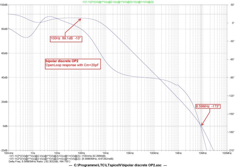

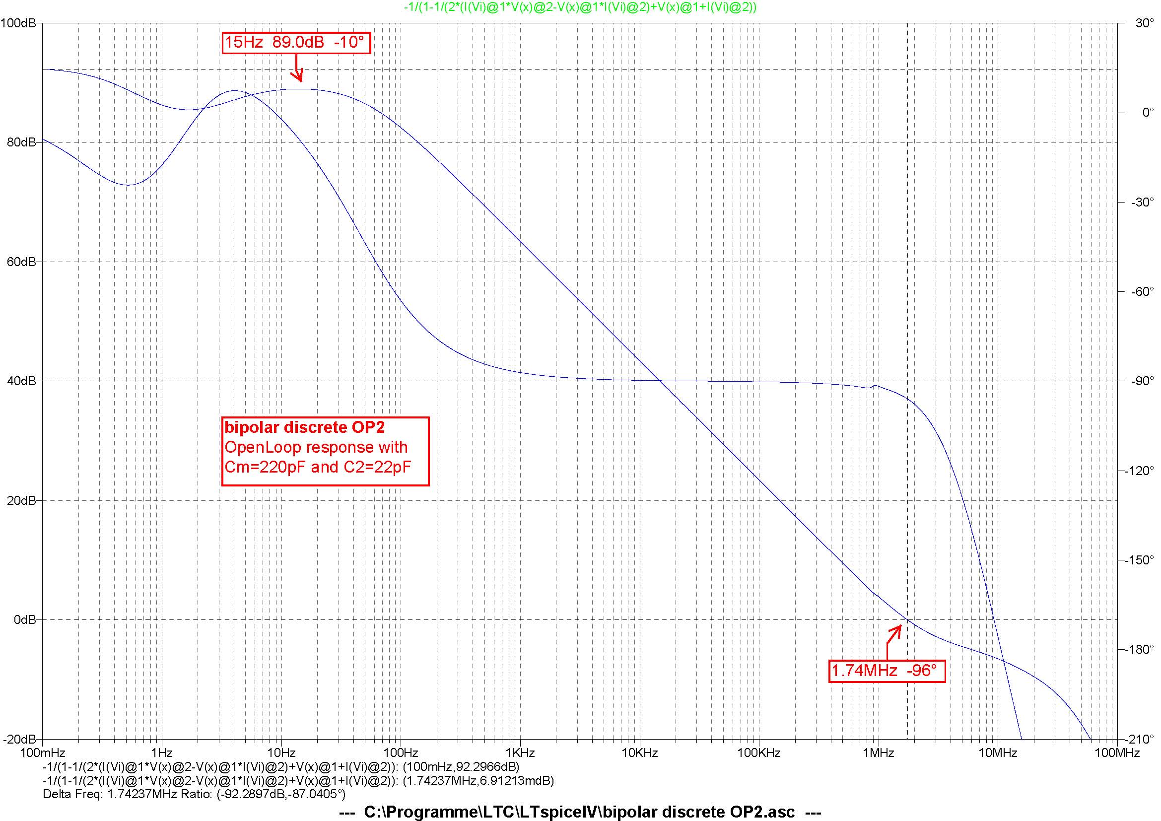

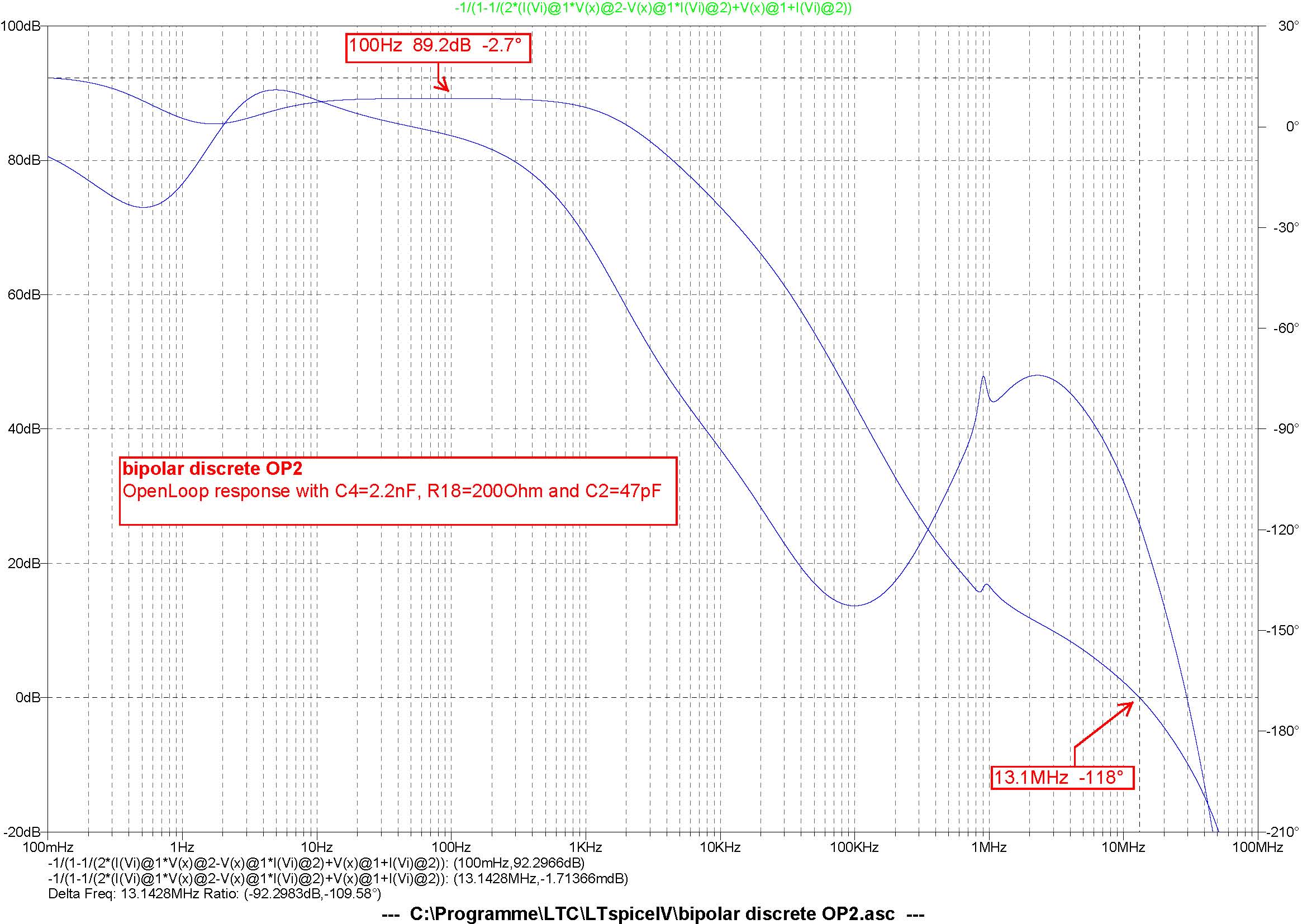

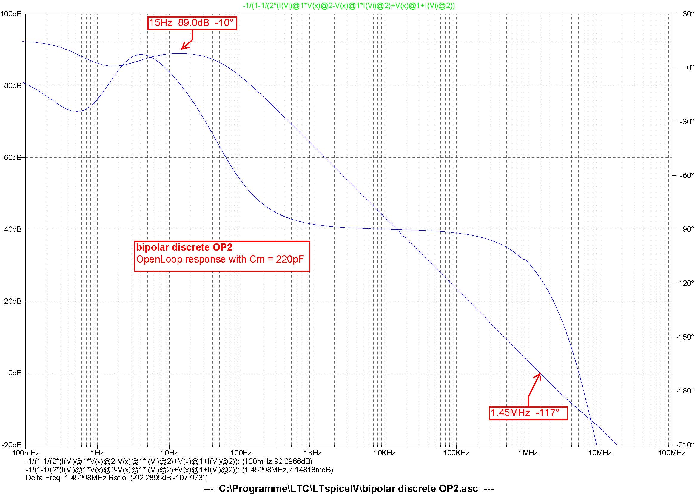

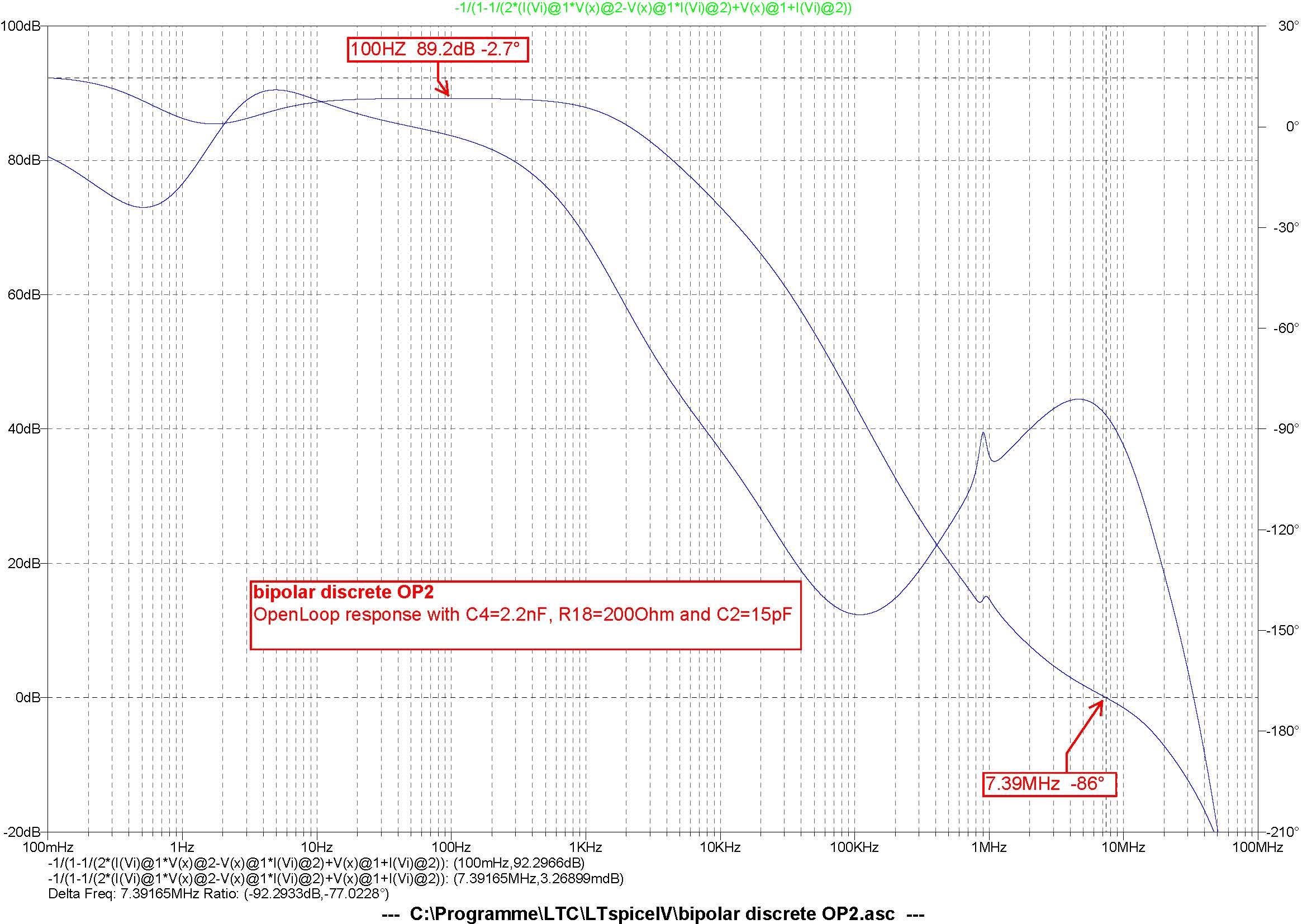

the OpenLoop sims:
the most important point here is, that the phase angle Phi at the frequency where the amplitude drops to 0dB must under all circumstances be greater than -180° (or lower than the abolute value of Phi). If You calculate Phi +180° the result must be >0° (phase reserve). It has been good practise to reach a value of >60° phase reserve.
Miller-compensation of Cm=20pF: Phi@0dB= -173° --> Phase reserve ~7° F0dB=8.59MHz
Miller-compensation of Cm=220pF: Phi@0dB= -117° --> Phase reserve ~63° F0dB=1.45MHz
Miller-compensation of Cm=220pF +C2=22pF: Phi@0dB= -96° --> Phase reserve ~84° F0dB=1.74MHz

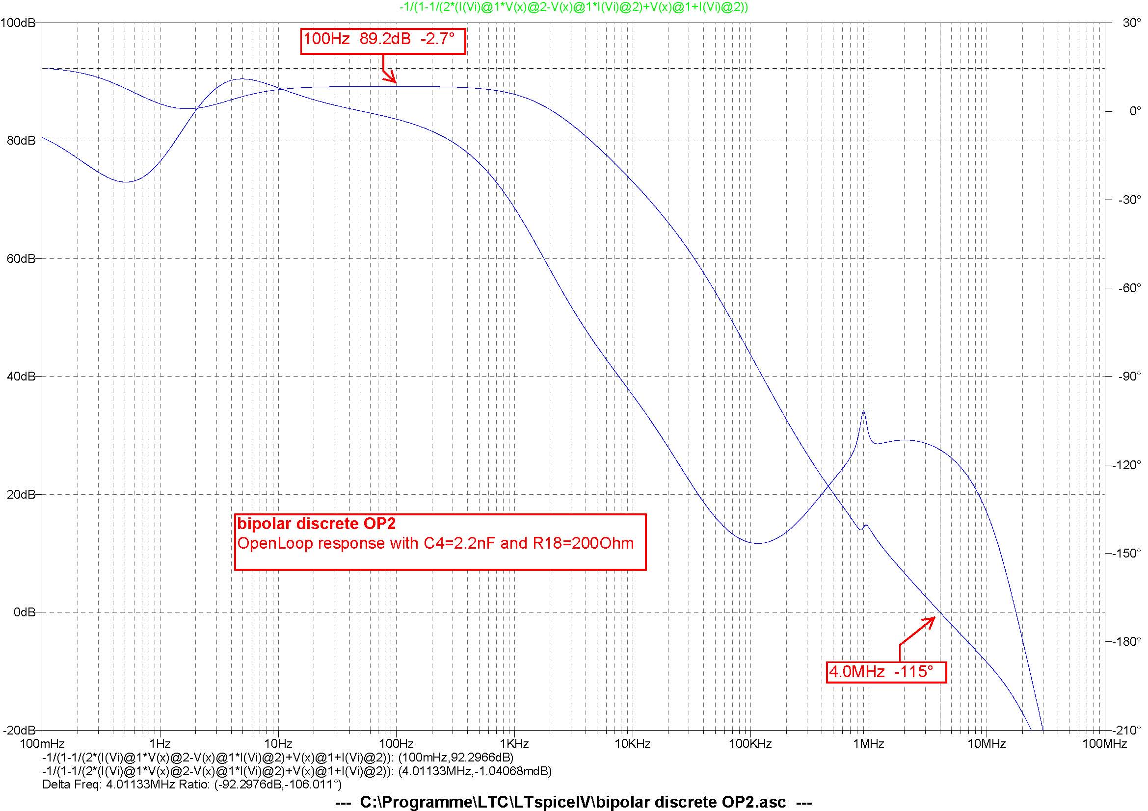

RC-compensation of C4=2.2nF, R18=200Ohm: Phi@0dB= -115° --> Phase reserve ~65° F0dB=4.0MHz
RC-compensation of C4=2.2nF, R18=200Ohm+C2=15pF: Phi@0dB= -86° --> Phase reserve ~94° F0dB=7.39MHz
RC-compensation of C4=2.2nF, R18=200Ohm+C2=47pF: Phi@0dB= -118° --> Phase reserve ~62° F0dB=13.1MHz
Its obvious that the RC-compensation allows for higher OL-bandwidth at similar phase reserve.

the OpenLoop sims:

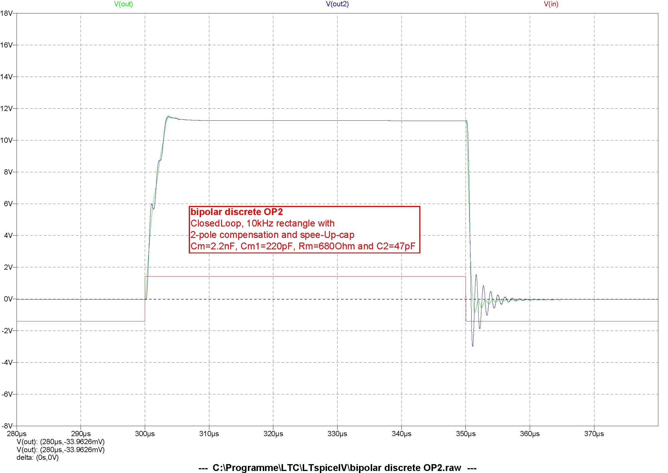

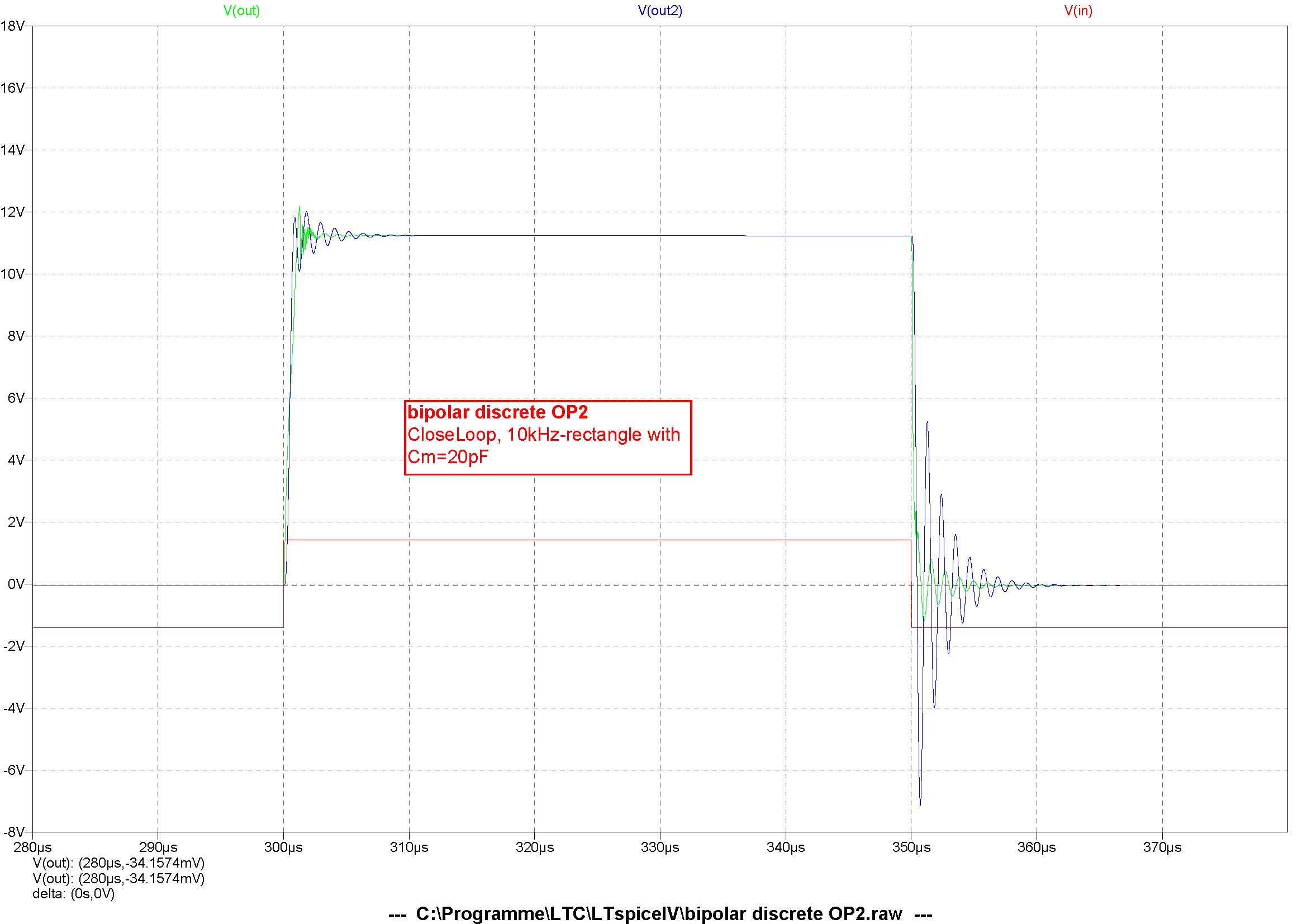

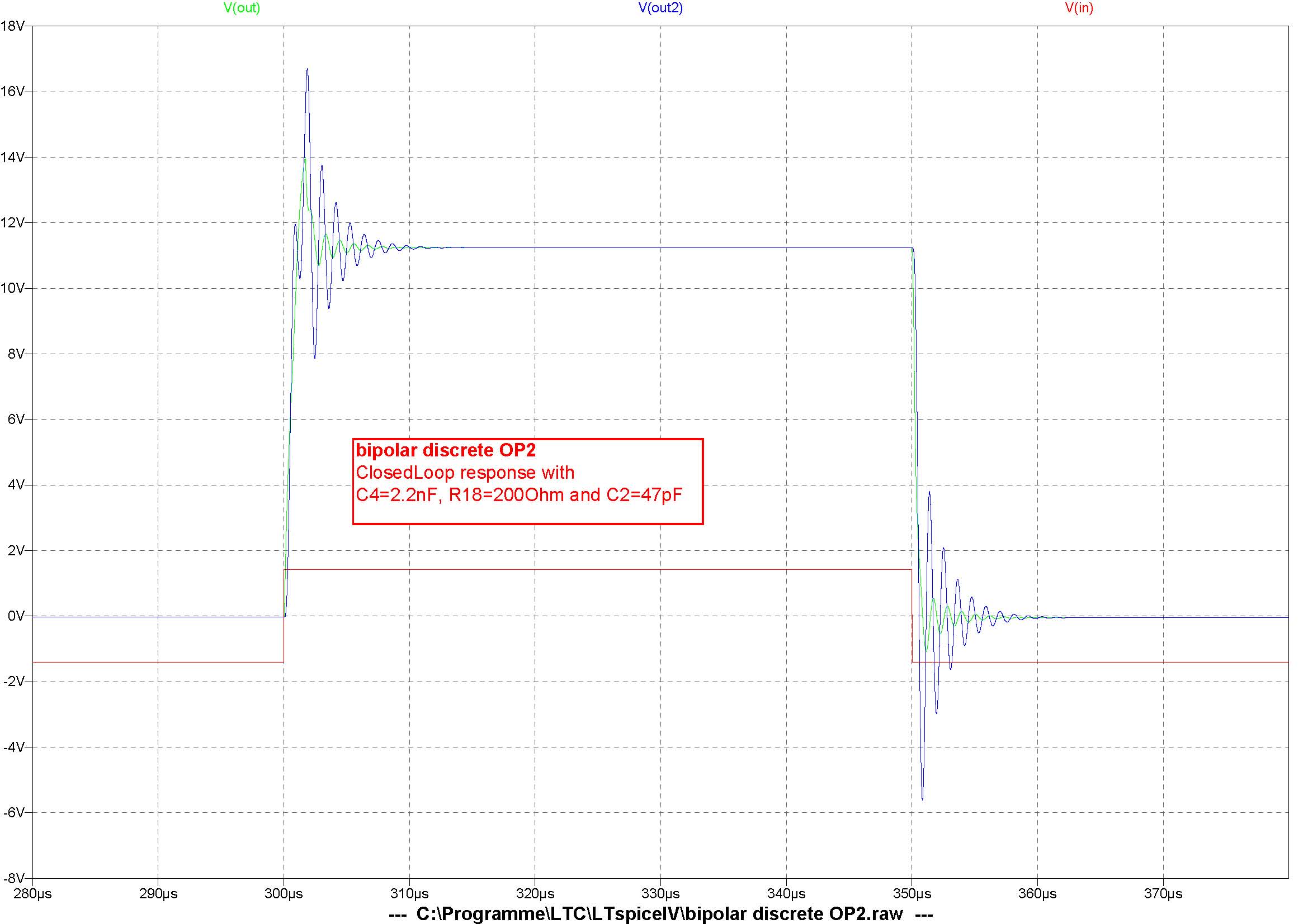

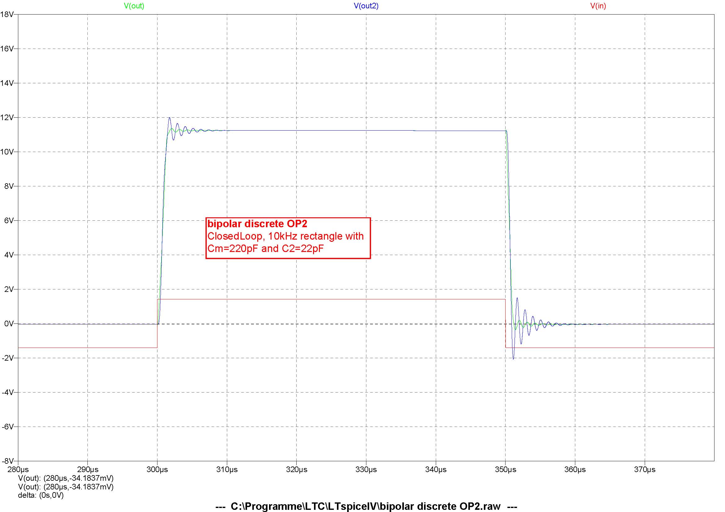

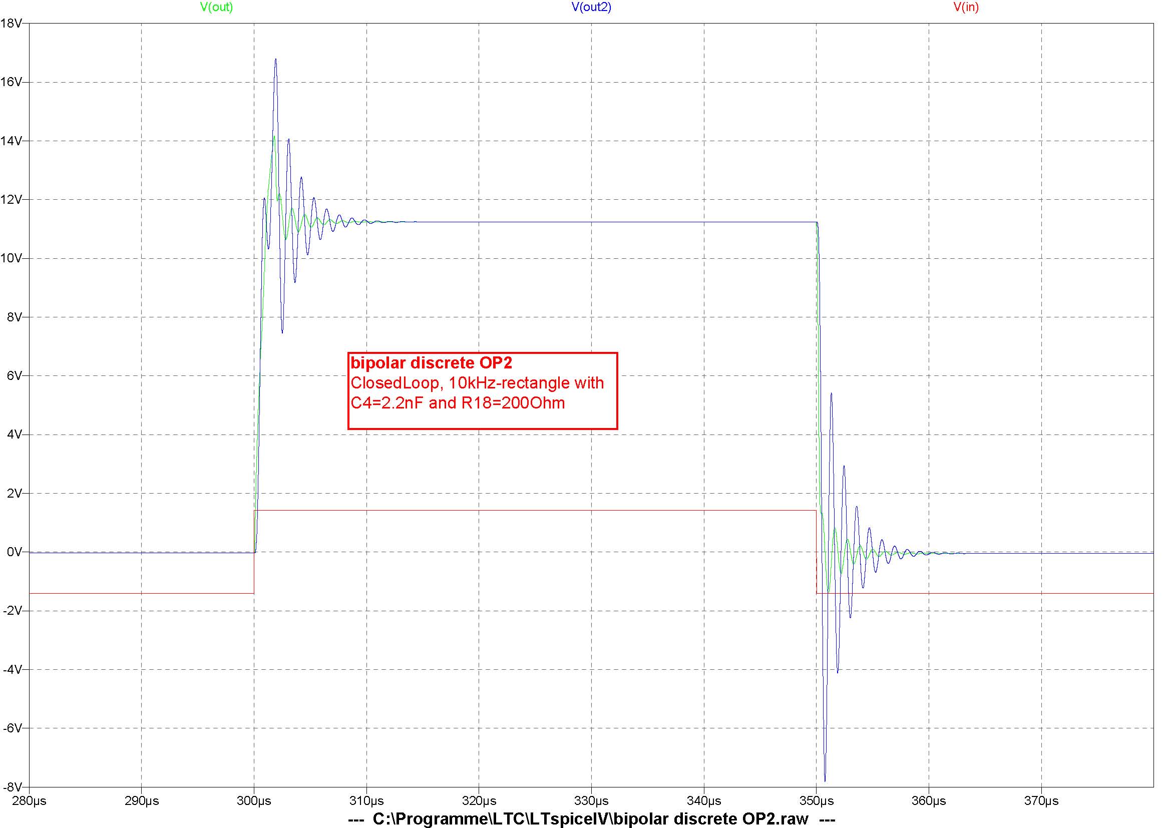

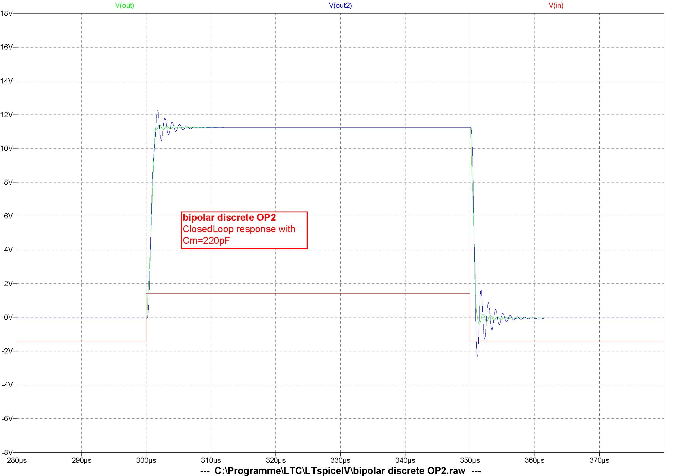

the ClosedLoop sims for a 10kHz rectangle.
As in the OL-sim the 20pF Miller-compensations prooves too low showing some beginning HF-oscillations at the rising edge.
The 220pF Miller and slightly better the 220pF+20pF show just a bit of overshoot, but remain stable.
The RC-compensation also remains stable but shows considerbly more overshoot.
You may try other compensation methods, as the LT.asc is attached.

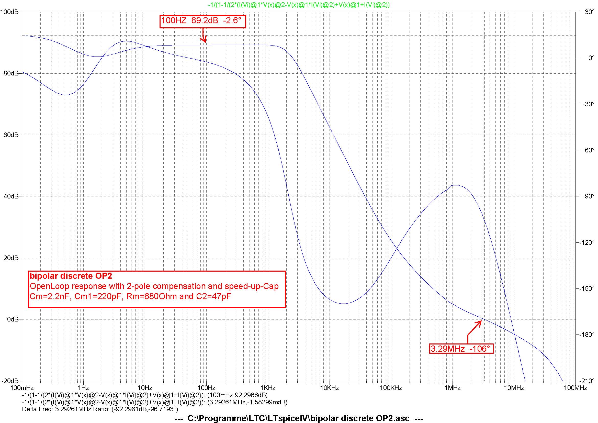

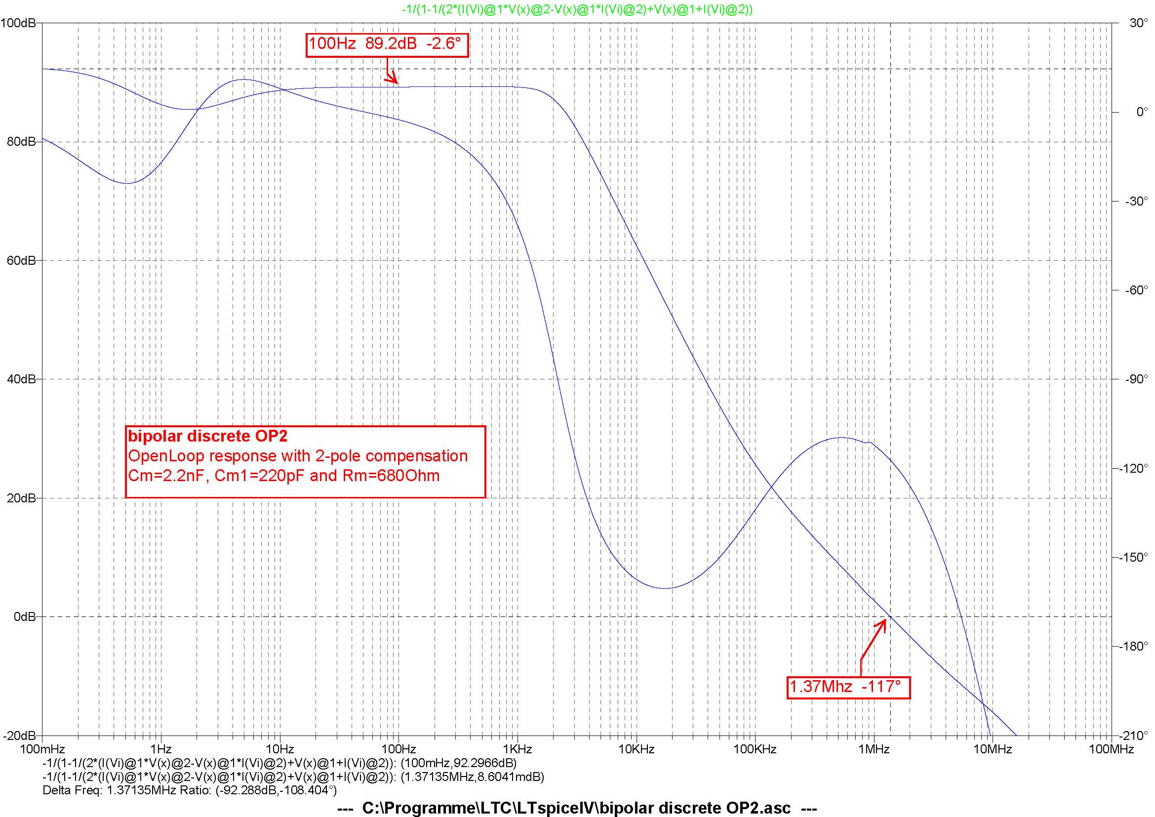

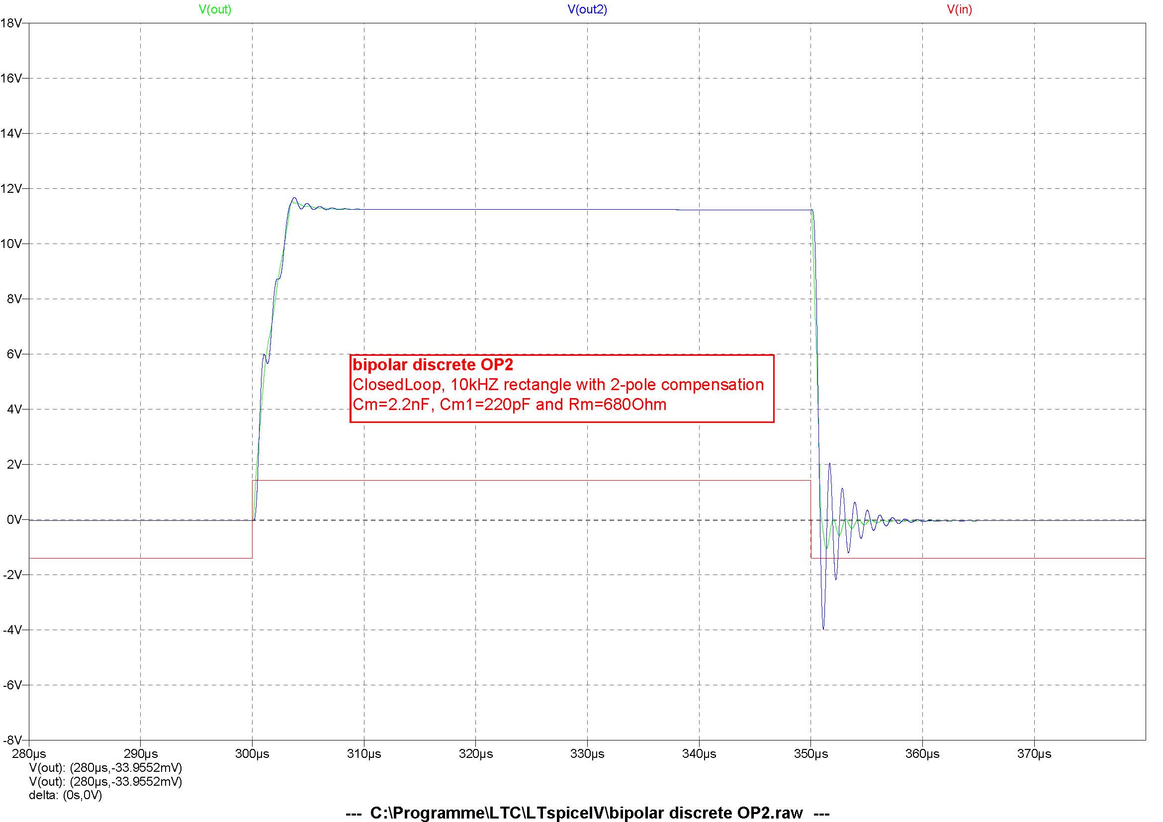

Hi
2-pole compensation (2n2, 220p, 680R) and 2-pole compensation plus speed-Up cap (2n2, 220p, 680R +47p).
The rising response is now cleaner, juts some ringing on falling response.
OL-bandwidth is greater as with Miller.
jauu
Calvin
ps: Its a good thingie to learn from, if he wants to create poweramps later. ;-)
jauu

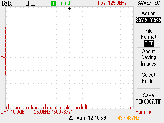

Signs of life....

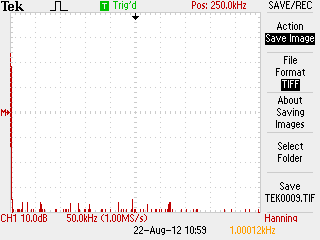

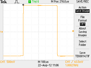

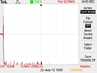

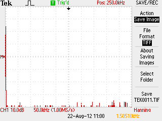

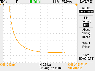

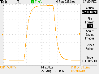

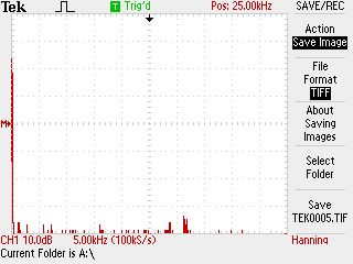

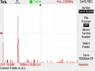

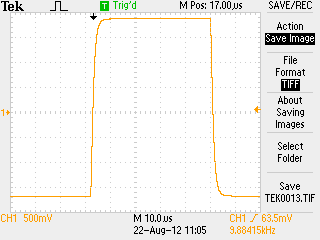

Apologies to those who have helped me so far. I had to put this project to one side for a few weeks. I'm back to work on it again now.
Pics below are:
FFT screen captures at frequencies from 1, 10, 20, 50, 100 & 150(kHz)
A square wave corner at 10kHz
Square waves 1, 10, 50 (kHz)
It was impossible to tell accurately see let alone measure the harmonics as they all appear to be at or below the noise floor, which was constantly moving about. I guess this isn't necessarily a bad thing.
Pics below are:

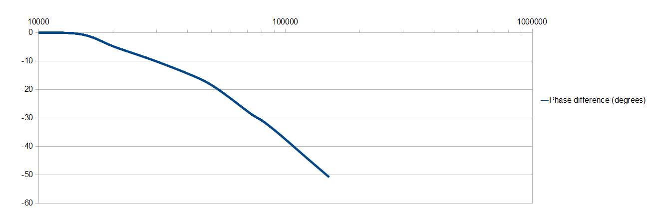

Circuit that was tested and phase
Here is a diagram of the circuit that the above FFT's etc were measured from.
Also attached is the measured phase. From 10kHz - 150kHz
(note: this was done by measuring the time difference between peaks using the o'scope curser and then the data recorded in a spreadsheet. Peak location had to be done by eye and as a result the curve isn't perfect - but it's close enough to see what's going on).
Sounds like your having fun.
The phase shift looks a bit excessive over the audio band. I would have to analyse the circuit but you should measure after the input filter (although that won't make a huge difference). Limited slewing of the VAS (C15) might be worth looking at.

The combination of C4=2n2F and C15=180pF seems like far too much HF local feedback for a stable amplifier.
How low can these values go in simulation before instability becomes obvious? Then you can increase them a little.
C2 seems a little high.

The above pics are from an actual circuit constructed on a bread-board, the RCA cable part labeled on the schematic is just a worst case scenario guesstimate of an actual RCA used in the test. The input components after the RCA are also mounted on the breadboard.
