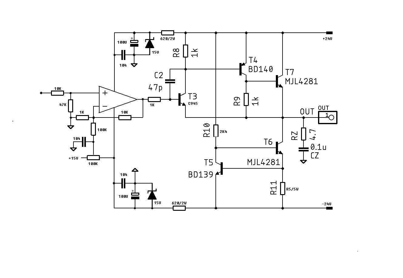

For the outputs, Toshiba 2SC5200 or 2SC3281 are good or use On Semi MJL4281 or the FJL4315 ( same as the 2SC5200)
Make sure you use a very good audio grade output cap (4700uF). I use an offboard cap board and use multiple caps to make up the required capacitance with film bypass caps. Elna RFS or Cerafine ROA, or Nichicon UKA, UKZ or UES.
Probably no need for a soft start module as the amp is only 4W per channel. Use a Cap mx psu card for your power supply.
The output transistor resistor R5 (or R11/R12 on Prasis's schematic) is 3 watt or 5watt, all other resistors are the usual 0.25W/0.5W that will fit the pcb. Your choice of the Nichicon FG's is good for the output cap to fit the pcb.
Have fun building the amp, read up and think about biasing at 1.25Amps by changing the value of the R5 resistor to be 0.5ohms (from 0.6 ohms)

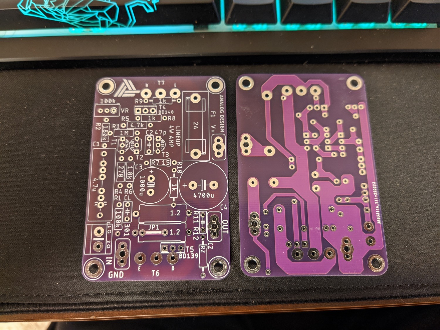

If anyone is interested in some PCB's made from Prasi's gerbers to build this amp, if you pay shipping they are as good as yours. Send me a PM if interested!
I have 14 total pairs for these boards, all are from JLCPCB, HASL-Lead Free finish. 7 of the boards are green single sided, 7 are purple double sided, I've attached some pictures.

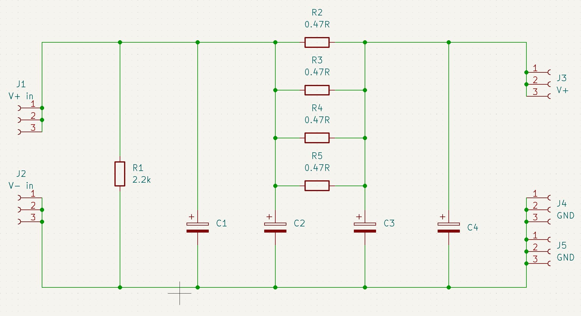

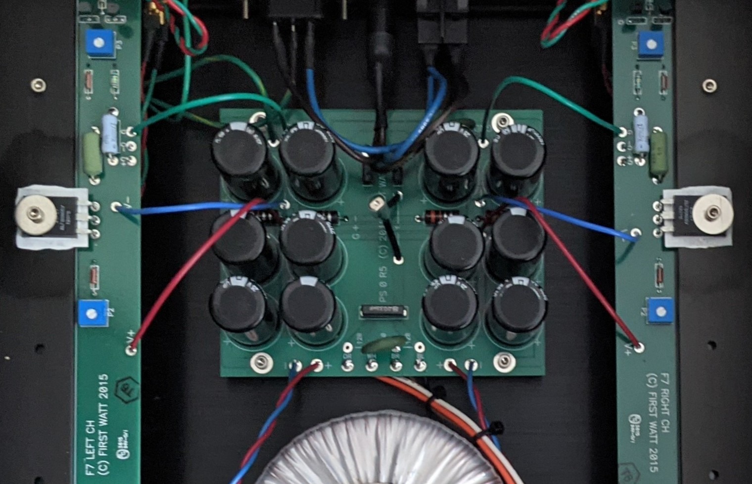

I've also decided I'd like to power this with a linear power supply and would like to miniaturise what's in my F7 but with something like a 160VA torroid - its exceptionally quiet and has little to no startup thump. Could anyone recommend any suitable boards for this?

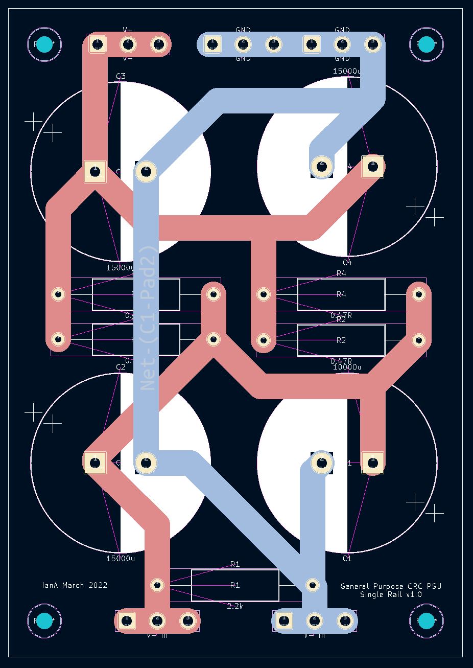

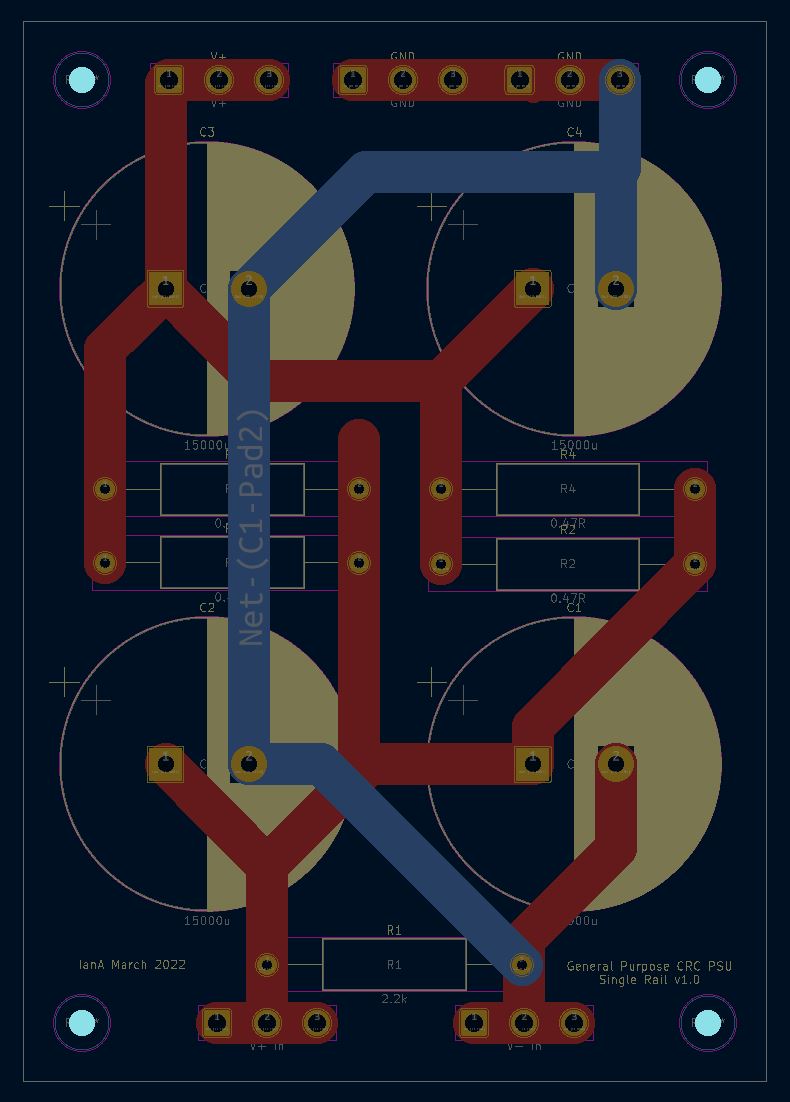

I've had no luck in sourcing a single rail PCB so downloaded KiCad and had a go. I've shamelessly borrowed the old First Watt schematic from NP and butchered it a little:
that bit was easy - laying out the PCB less so. (5mm traces) This is my first attempt so no sniggering ;)
@IanA yes, that was the idea. I was hoping to avoid the crossovers.
I wish someone with more experience would weigh in. I am a beginner as well.
If you change the cap orientation so that all of the +ive leads are pointed to the center (where the resistors are), I think you can snake the blue trace (ground) along the right side.

I did my first attempt at the easyeda.com online site as I do not have kicad or other softwares :)
Here is a small renderer and I did print few boards to test my board and I tried to use small caps of 2200-4700/35-50v low noise and also they are cheaper than bigger sized caps. Hopefully it works, if you are interested here are the gerber files.
Note: This board is yet to be tested.

hi, this amp is capable of driving 4ohm speaker?
I've built mine but it distorts on the high frequencies when i play some piano songs, I've set the Voltage zero to V/2 + 0.8 and i'm running the amp at 20V 1A.
What could it be?
All the values and transistor orientation are correct.
The Bc transistor were matched using Hfe.
