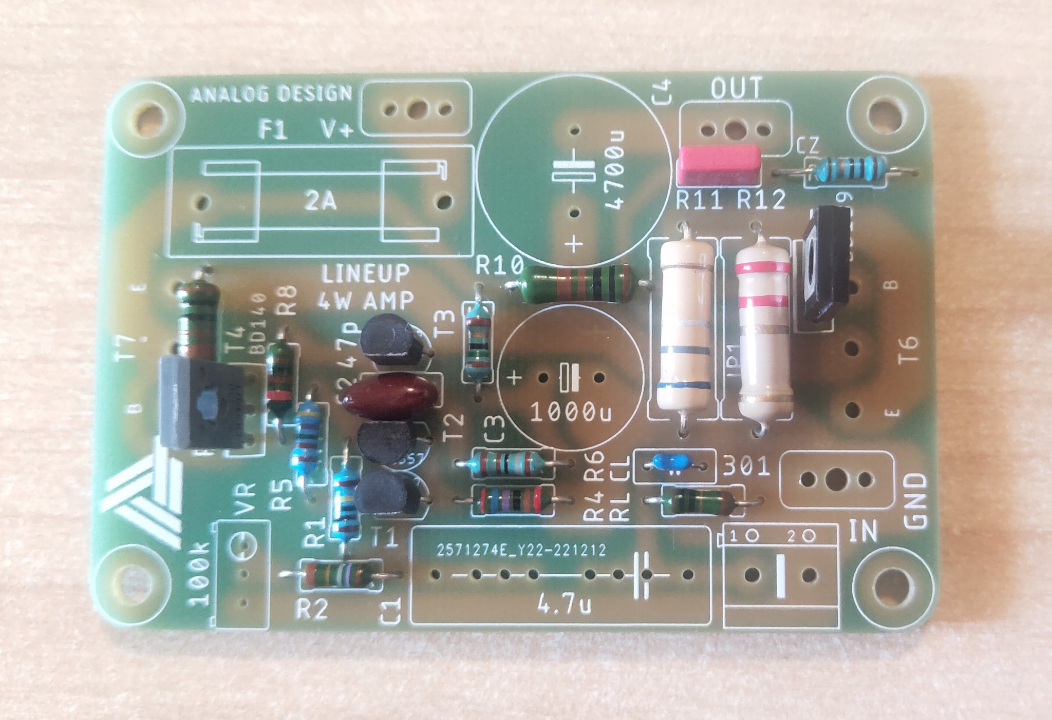

hi,
finally got some time to build this amp and populated most parts, but I need some help for parts values;
I have not 100k VR but 50k on hand, may I use it?
used 100pF silver mica cap instead of 47pF, is it ok?
also used a 330pF X7R cap for CL, is it ok too?
does it strictly necessary to use fuse in case 19-20v dc?
thanks in advance.
