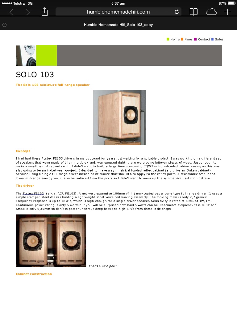

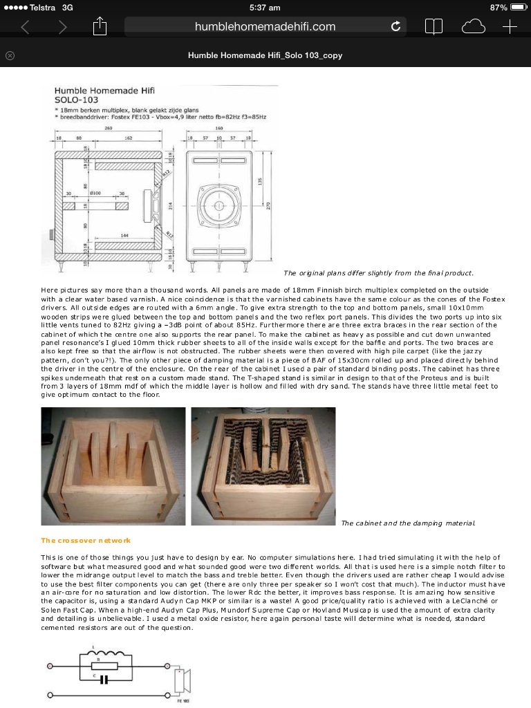

As none answered you, I'll post my thoughts (even if I never design speakers!).
As stated in the white paper of Solo103, the box is "tuned by ear", so is highly customize for that Fostex driver (fe103).
I don't think you can use the same project for such different driver, I think it's better to design your own box from scratch.
Try some simulation tools on the net, and then tune it by your ear.
I think it's the only way to go.
Ciao!
My notch filter is a parallel of RLC
R - 27 ohm
C - 2.2uF
L - 0.05mH
This RLC is connected in series with the driver.
Ciao ttan98,
after all these years I'm about to try your filter, but it seems (from the online spreadsheet) that your filter is set to give a -18db attenuation @15000Hz, is it corect?
Don't you think 27ohm is abit high? Did you mean 2.7ohm?
