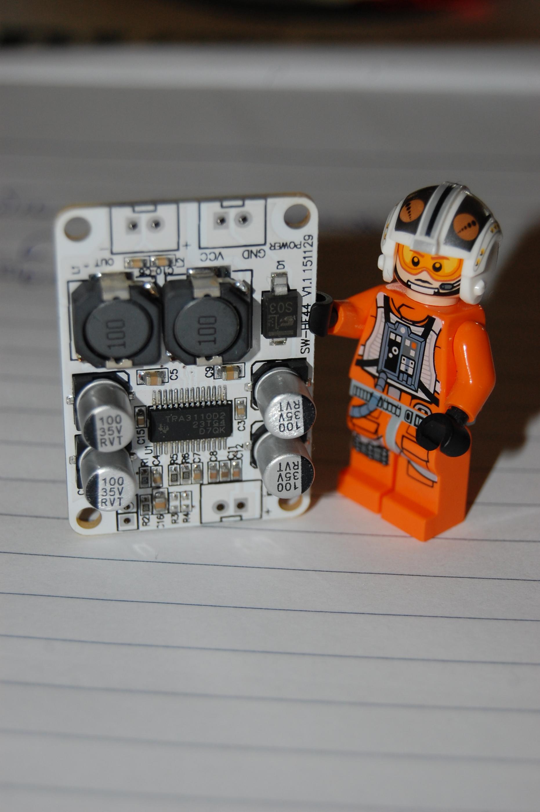

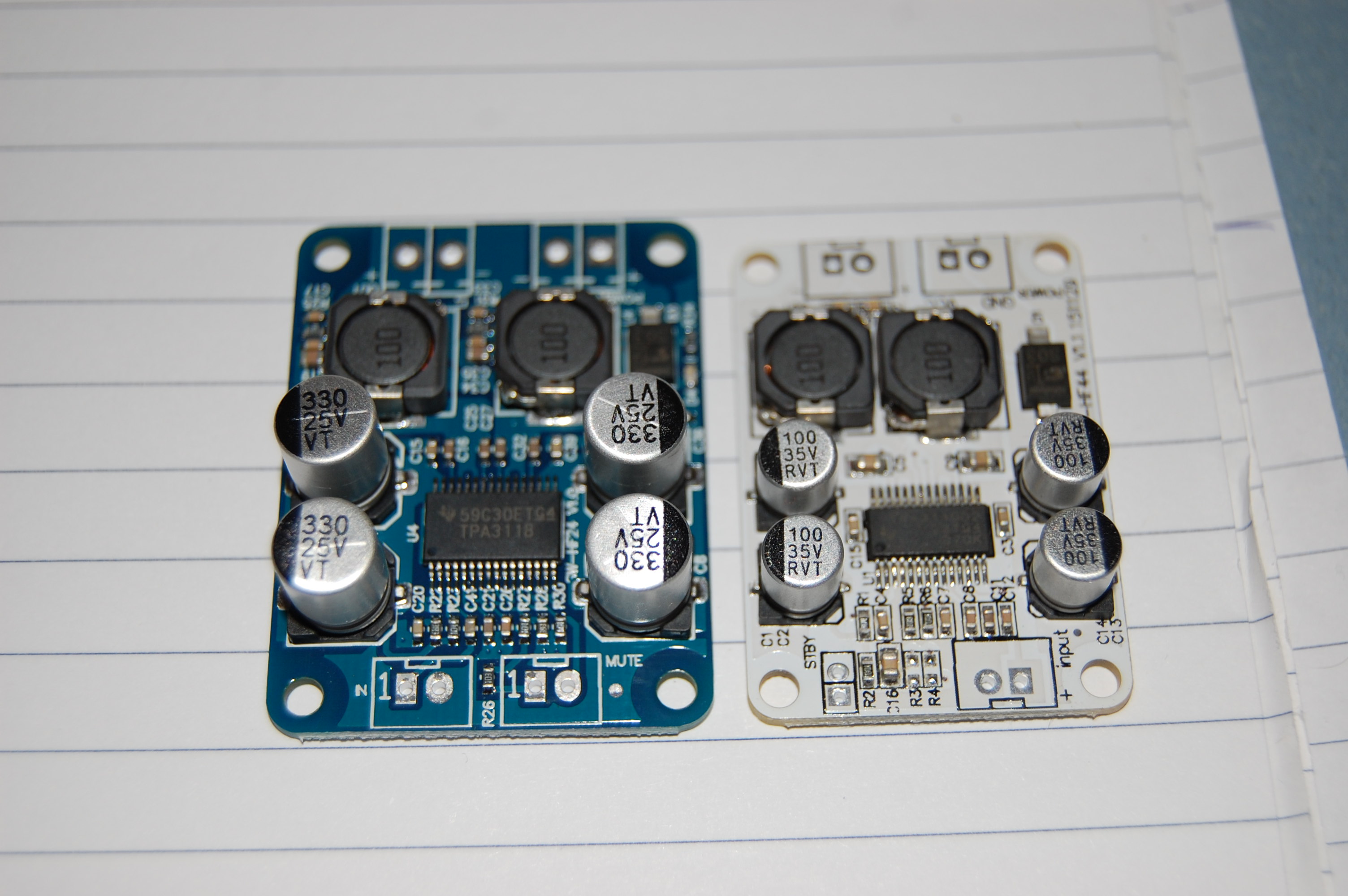

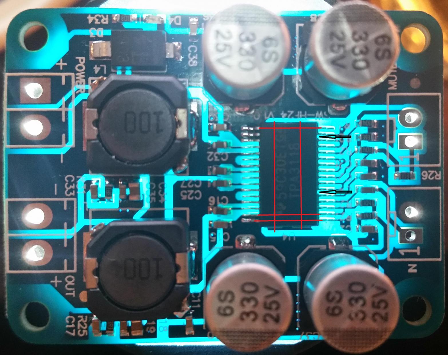

Nice pic:) The chip looks a little different, lasermarkings more to the right and more to the middle than I have seen on 3118. The arrows I put at funny dents, these two with arrows I haven't seen earlier, but might be light reflections ?
I double checked. The dents are definitely real, looks like a bit of the epoxy package got chipped off between the pins somehow. Not my doing, this board is unmolested (for now). The laser marking is actually off to the side as well. I have 6 other TPA3118 boards, a few varieties from all different sellers. None of those have the dents, but the laser marking is in the same spot for all of them.
Who knows, it wouldn't surprise me if they were all counterfeit chips. They do all work as intended though.

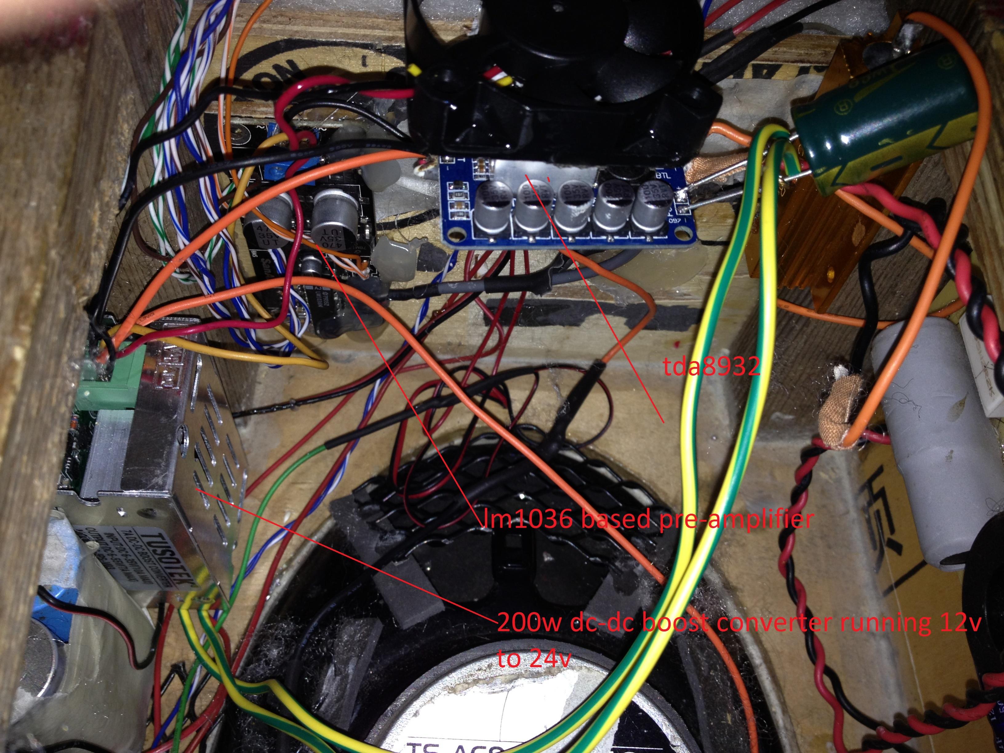

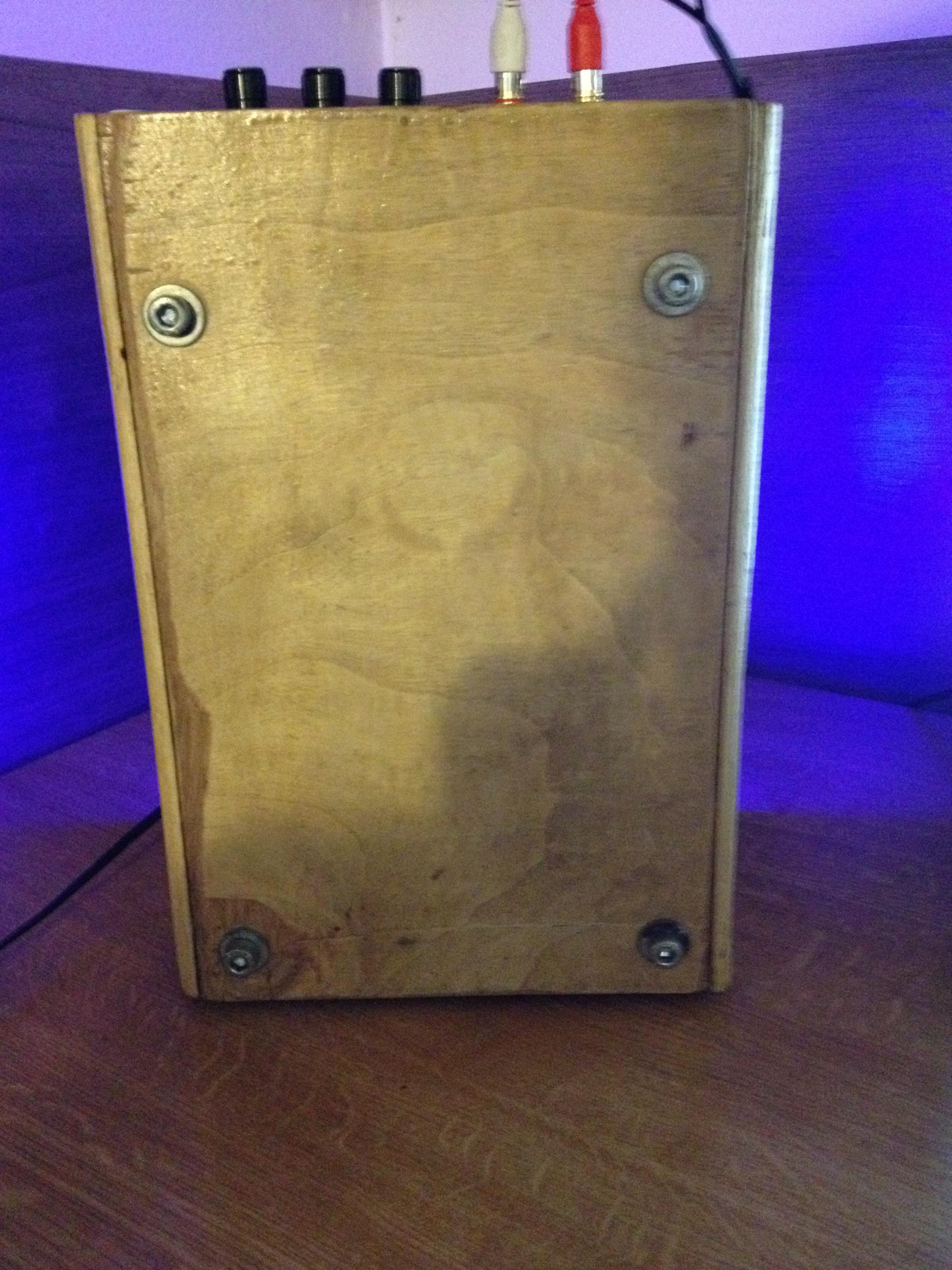

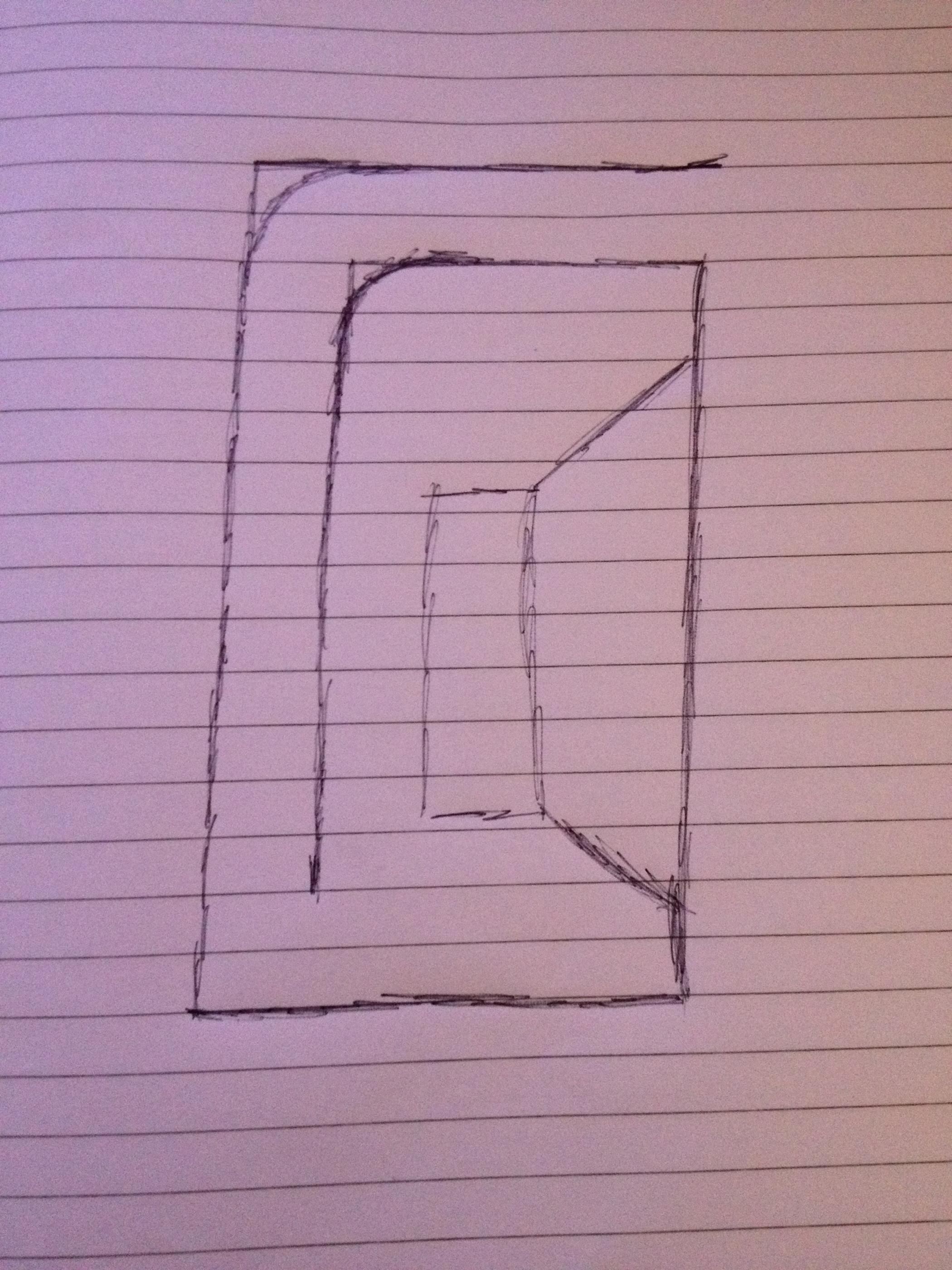

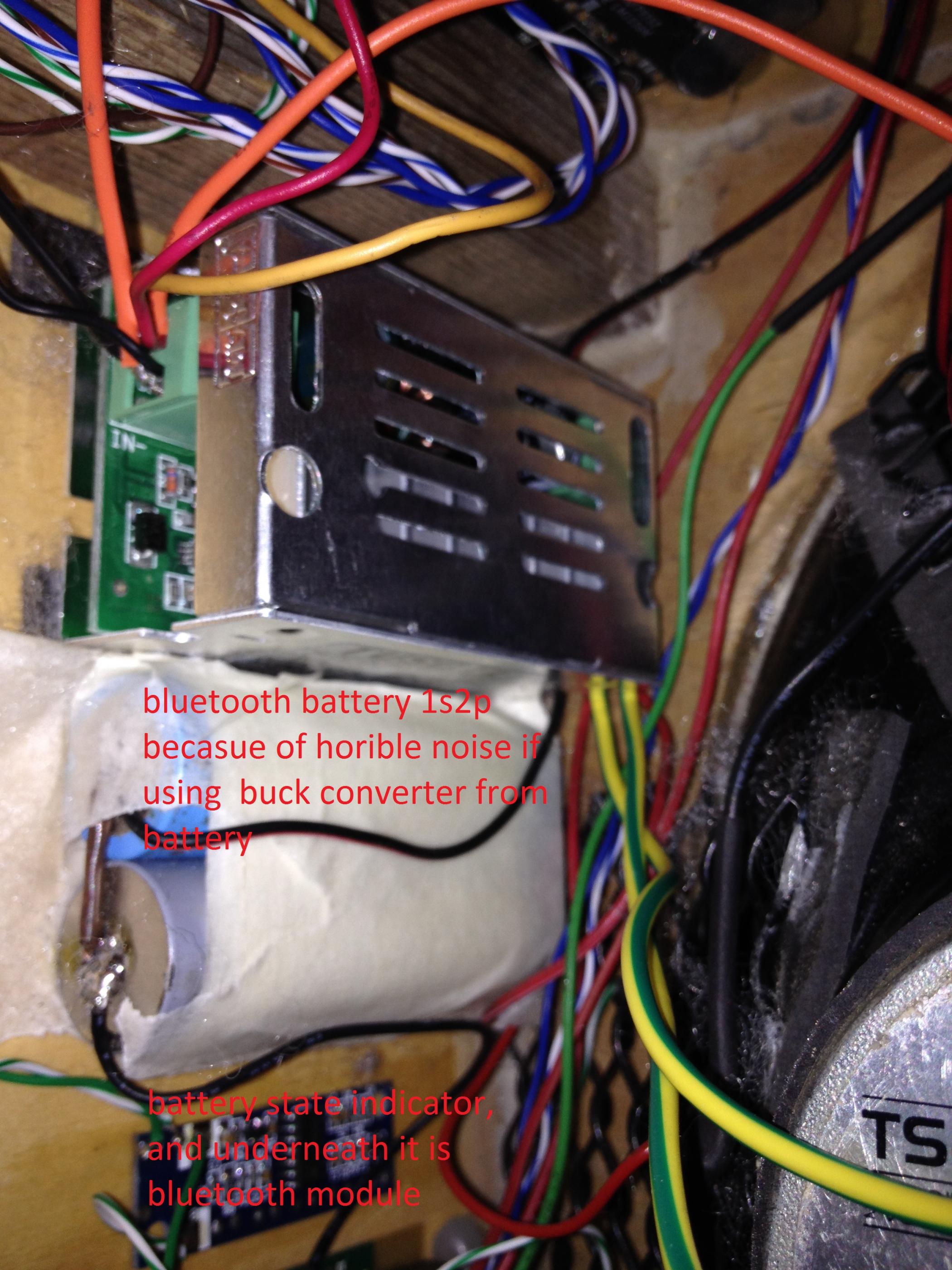

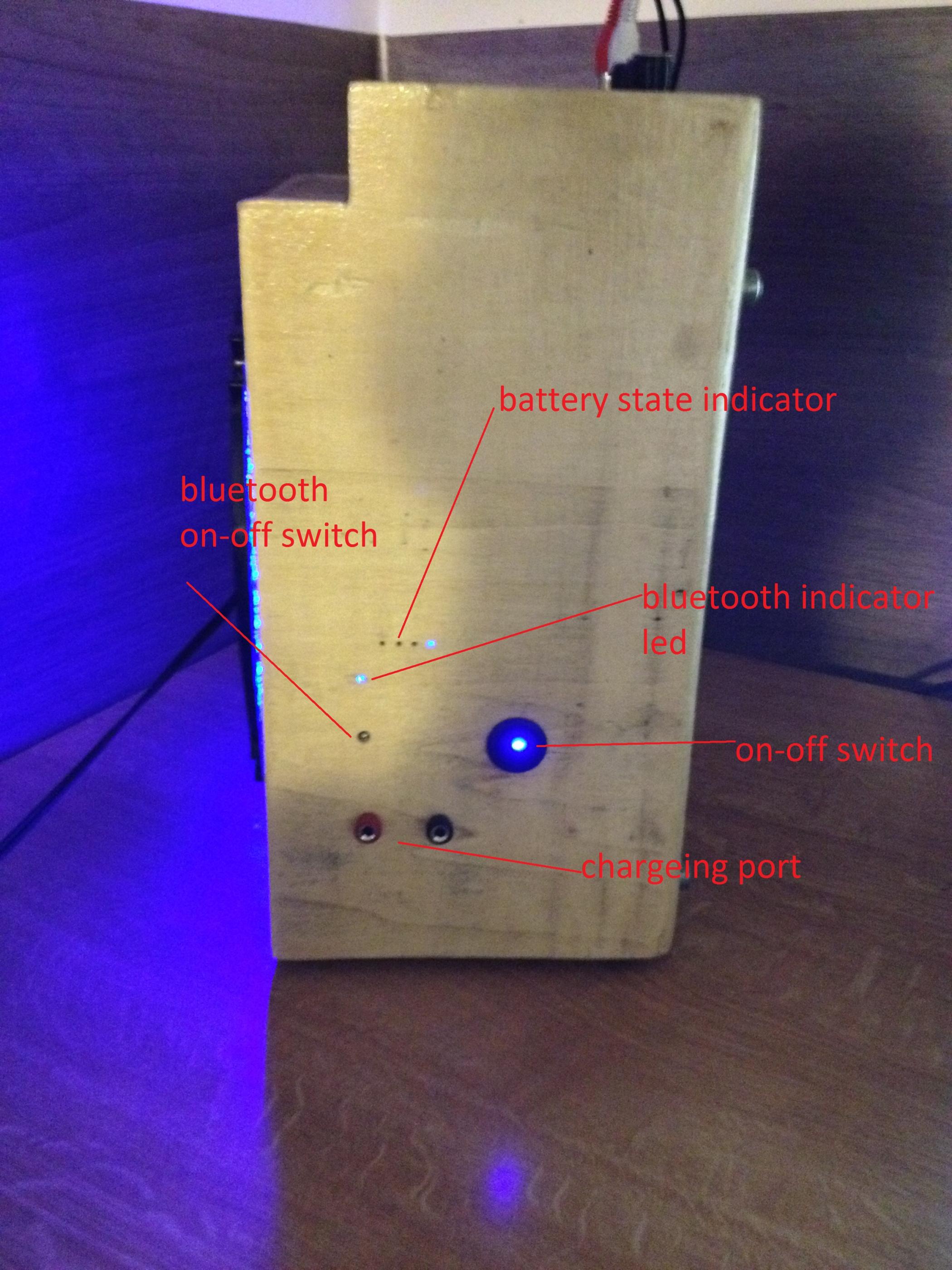

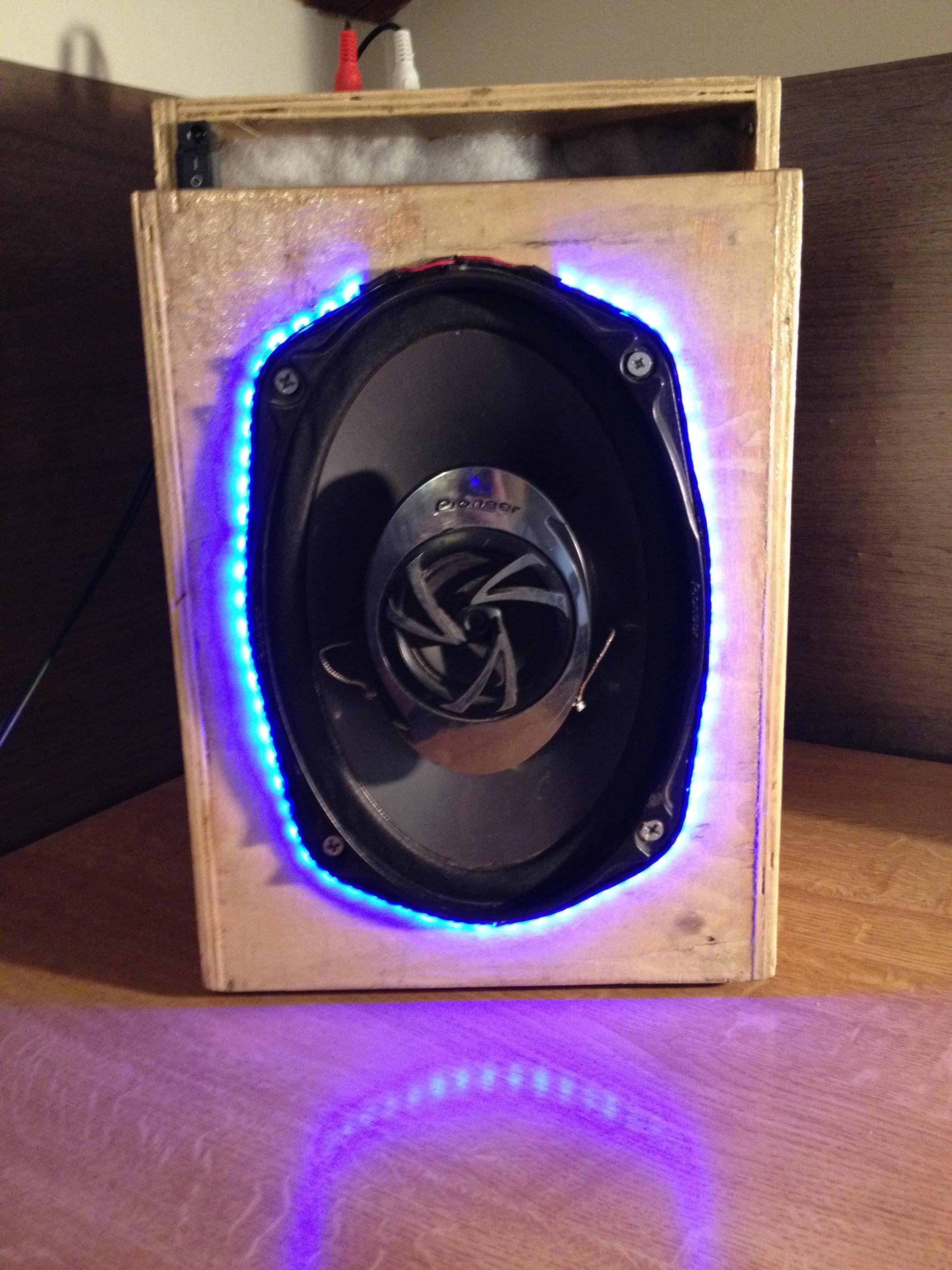

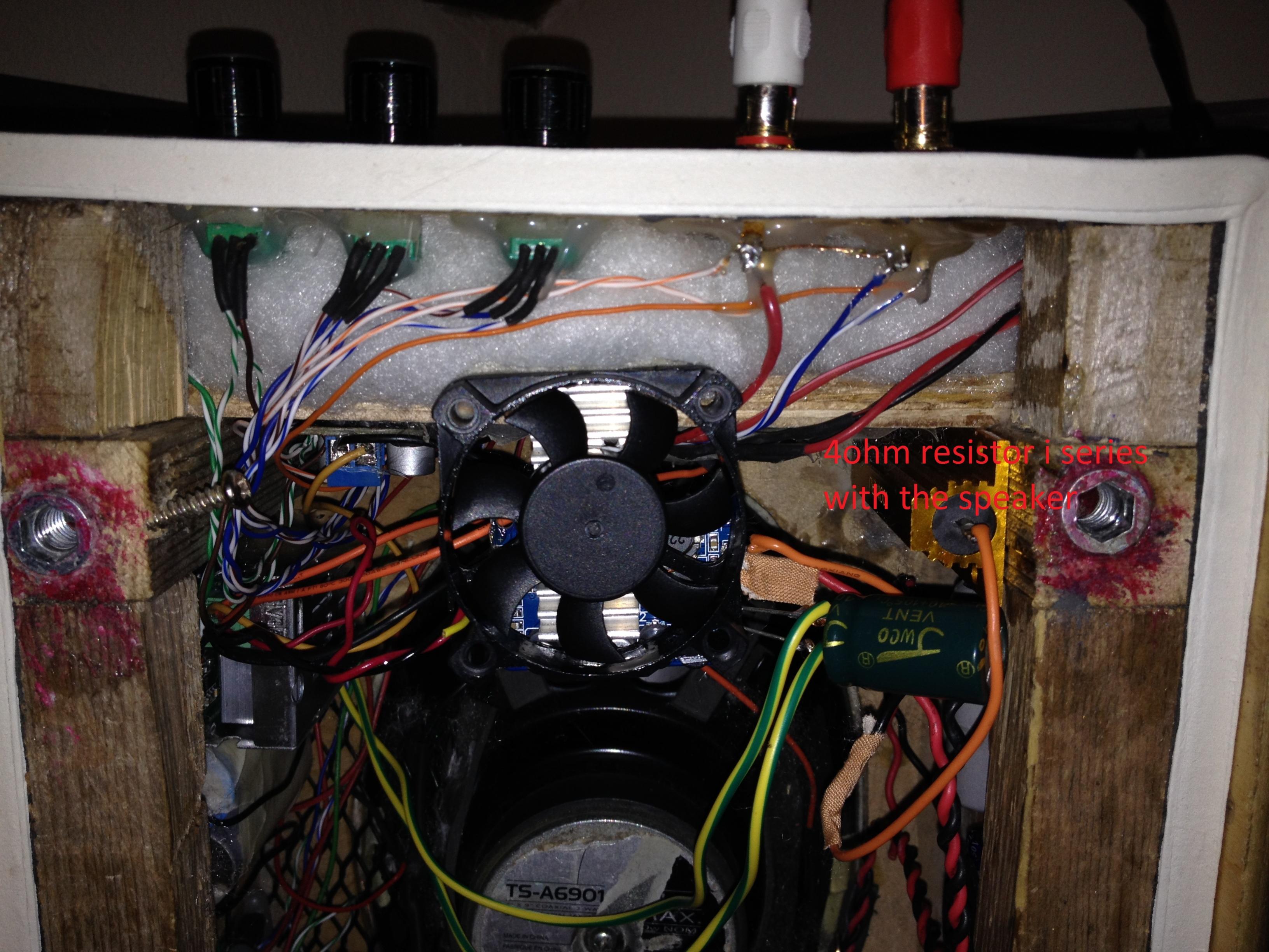

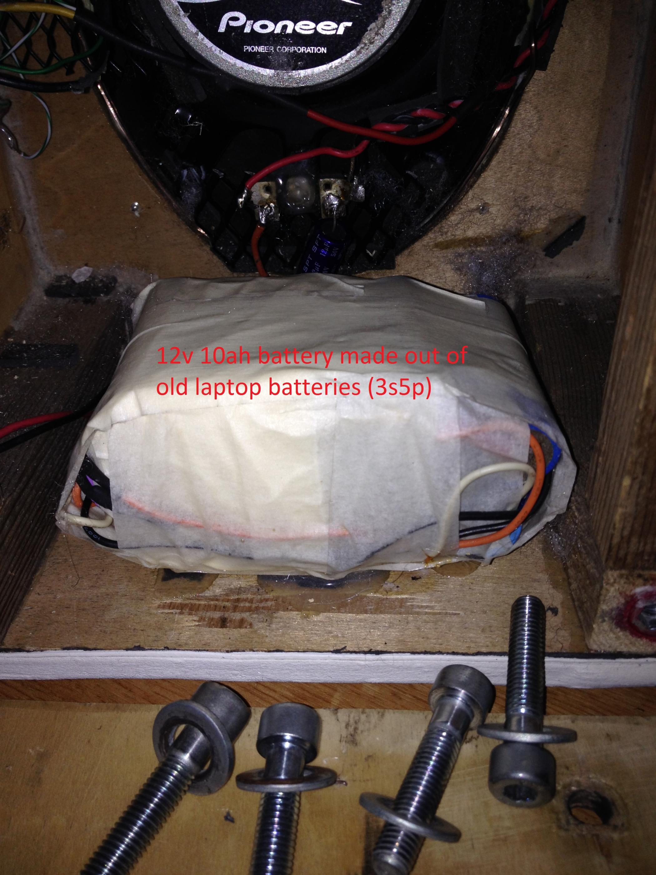

so this is my portable speaker. i know it s very ghetto but it works :D. i have been playing music on it for almost a year now. but now i want to build the mk2 version of it and i want to improve the sound quality as much as posible and do a diy video tutorial for youtube.so if anyboda has any ideas on how to improve it please contribute. the first thing i want to improve is to add a longer L port (drawing below ) the second thing is the amplifier mods that i mentoined in earlier post , and the third thing that i want to do is to isolate the amplifier from preamlifier and bluetooth module from the amp. i already tried doing that with cheap ebay groud loop isolator but i only got more noise in the amplifier maybe it s becasue they are not shielded with metal i could try wraping them in some aluminium foil would that hep ? and thats about it from me if you have any other suggestions please post:)
