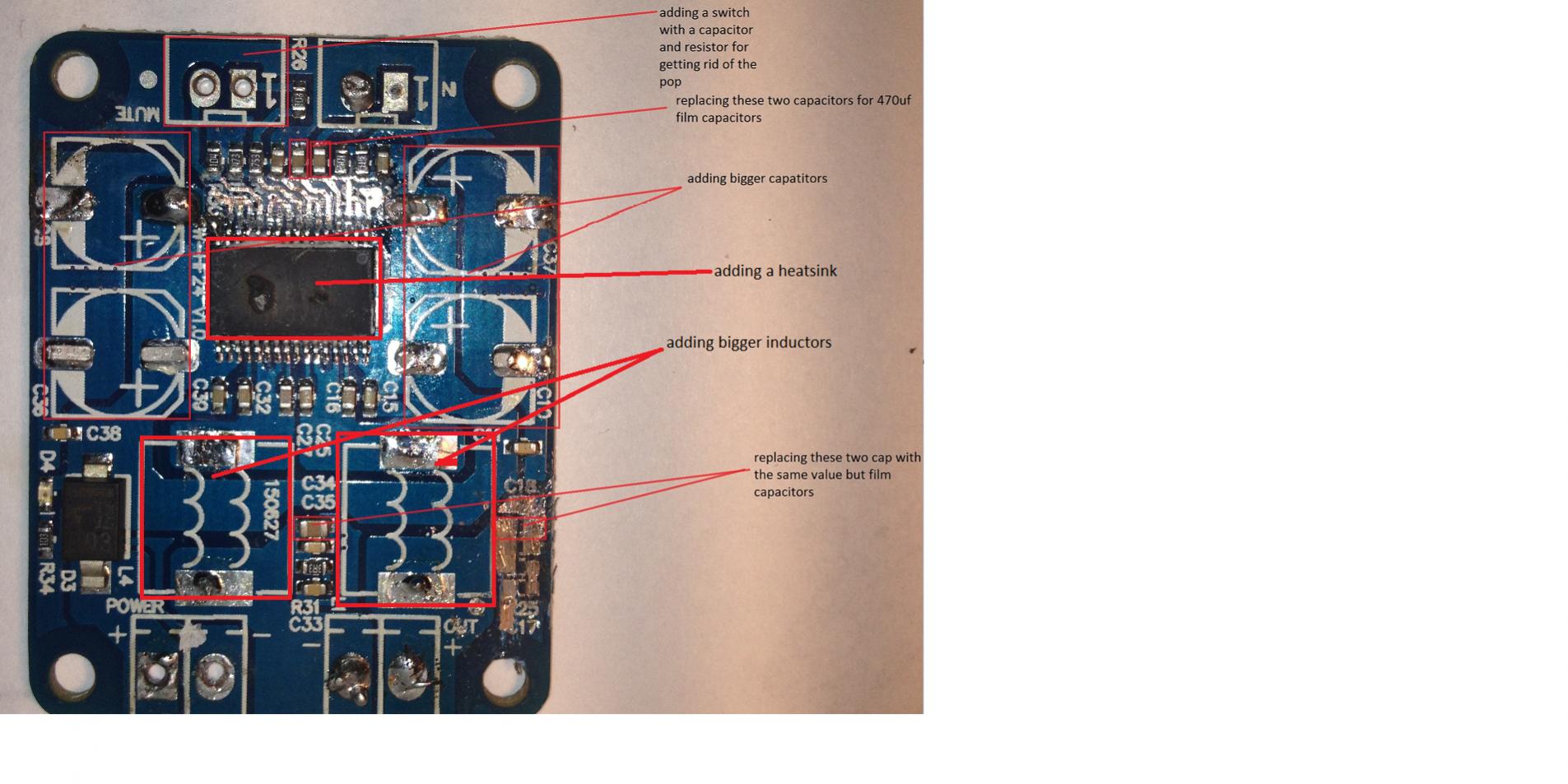

ok so from reading this thread i came to a conclusin to make these changes to my tpa3118 board
i plan to use this amp for my portable speaker with a 4 ohm car speaker and a 4 ohm resistor in series with it, batteries from old laptops , dc-dc boost converter , lm1036 pre-amp.
please tell me your thoughts on these mods as i am a beginner in electronics.
and also i do not quite understand how to get rid of pop noise what values of capacitors and resistor to use ? please help
Looks like the "classic" YJ Blue/Black mods applied to this board.
I'd say most probably can't hurt. Based entirely on what I've read in this thread, these boards don't sound terribly robust, I'd be worried that the PCB might not be able to tolerate all the soldering.
I don't think adding a heatsink to the top will do anything useful, as the tpa3118 has its thermal interface on the bottom of the IC. The intent is that the heatsinking is via the PCB's ground plane. If you want to do better thermal management, do like Xrk did earlier in this thread and use thermal adhesive to glue a big heatsink to the bottom of the board. You could also do like the Gmarsh Wiener board and use a thermal pad to bridge the PCB to your chassis (assuming the chassis is metal).
Since you're doing all that modding, while you're at it, you might as well remove what I assume is a power polarity protection diode and replace it with a wire jumper... assuming you can trust yourself never to mess up the power supply polarity. :)
I haven't worked with this board personally, but all the other tpa311x boards I worked with suffered power on and/or off popping, except the following:
  • Gmarsh Wiener board has a micro-controller that smartly invokes the chip's mute circuit to eliminate power on/off pop.
  • When I've used input transformers instead of input capacitors for DC-blocking, the power on/off pop was eliminated.
  • The easiest solution is to wire a switch to the mute pin. Then the power-on process becomes: close the mute switch, apply power, open mute switch, enjoy music. Do the exact opposite for power-off.
If you search the huge tpa3116d2 thread, there are a few references to the "Giancarlo" circuit which IIRC eliminates power-on or power-off pop, but not both.
