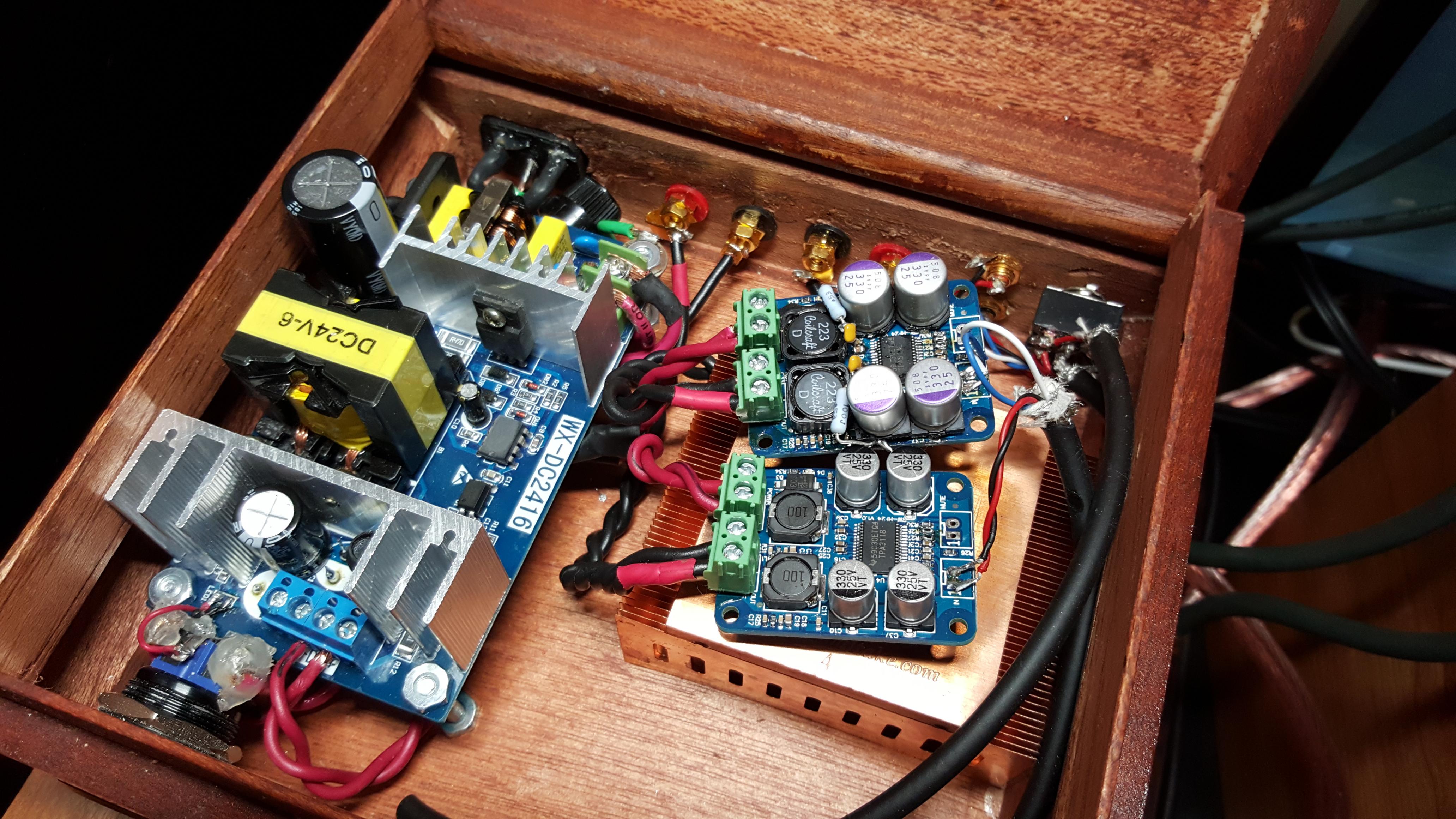

FWIW, standard "my ears, my system" disclaimers apply. But I feel like I'm getting the best bass yet out of my recently nearly-completed dual-mono TPA3116 build using the boards from the DUG group buy. I tried to incorporate all the "best practices" (real or imagined ) into this build, so it has:
- 18V Sigma11 linear, regulated power supply (one supply for both boards)
- 4x5600uF off-board cap bank
- 4x OS-CON 330uF caps per board
- Big Coilcraft inductors and through-hole film caps in the output filter
- Jensen JT-11P-1 input transformers (unbalanced to balanced conversion, galvanic isolation, DC-blocking)
Obviously this wasn't a cheap build (the Coilcraft inductors alone cost more than the boards that are the subject of this thread!). I haven't listened to the cheap tpa311x boards in a while, as before this I was using the Gmarsh Wiener board for a long time.
But anyway... I did a little bit of listening this weekend, and I think the dual-mono DUG build offers the best bass in my system I've yet heard. My speakers have an estimated F6 in the low 50s, so "monster" bass isn't really possible no matter what amp. But it's also nearfield (roughly 1 meter ear-to-speaker), so the perception of bass is certainly different than in a farfield setup.
Could also be that I'm simply hearing "a slight boast/excess around the lower midrange" that Smithie mentioned (depending on where you define "bass" and "midrange").

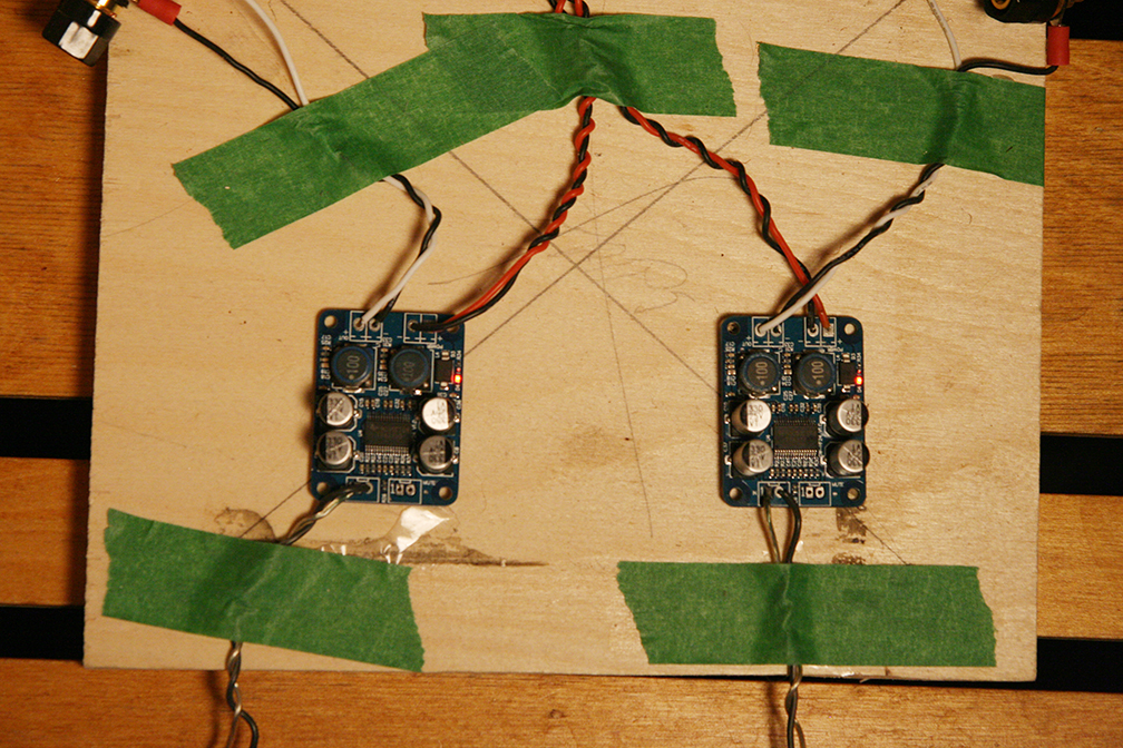

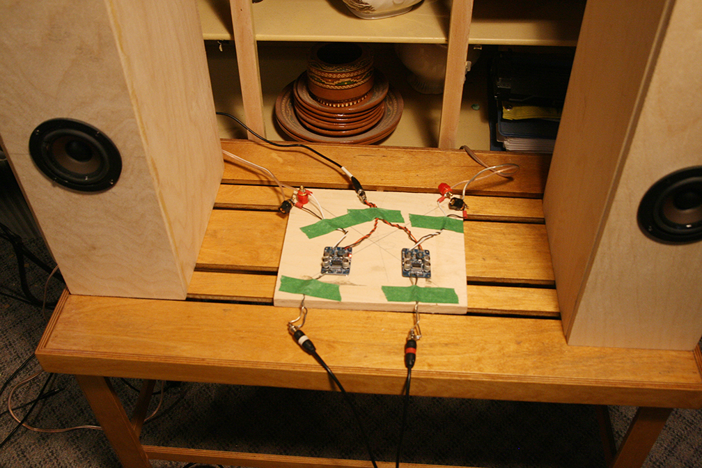

I actually had some extra components laying around so I went ahead and ruined the magic of these 3118pbtl so here is a subjective opinion.
Initial impressions were: yes the highs does sound better, more smooth. The mods did eliminate the high pitch whine that can be heard with no music playing. I can tell which speaker has the modified board in a blind test pretty quickly. But was it worth the time and ~$18/block? I do not know yet, right now I am thinking no.. I need some time to listen to them some more.
