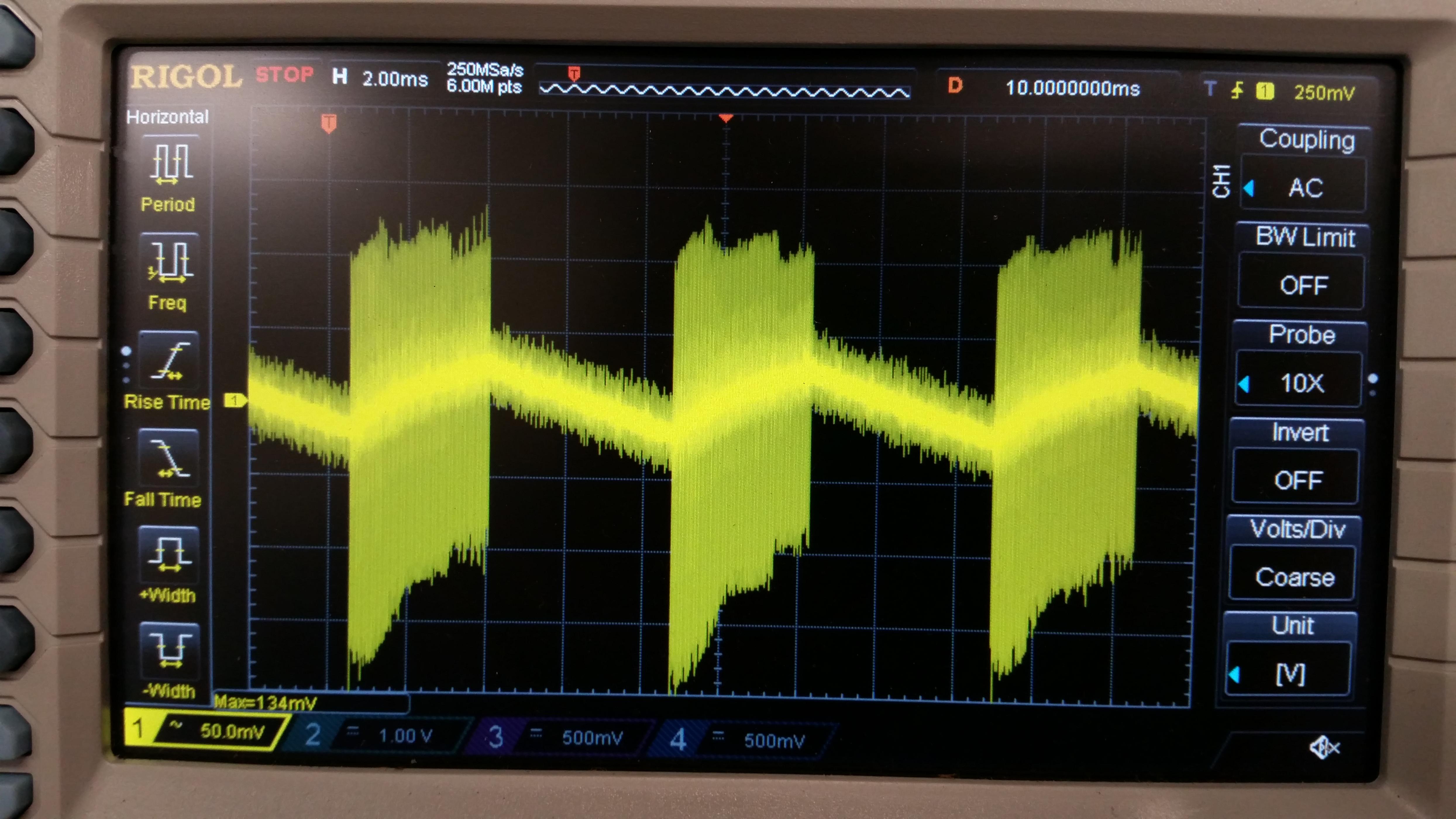

Not the best, but I would guess you could get a pretty big improvement by swapping out the "Chong" branded caps, before they go "Up In Smoke". Also seems that the chip is doing some kind of "burst mode" to regulate the voltage.
Oh that's kind of ugly. Is that 1v per division scale? My $6 SMPS 19v bricks are 16mV to 20mV of ripple.
50mV per division, so when the switching engages it is around 300mV. Unfortunately when it is loaded down it maintains that 300mV ripple. I haven't noticed it manifesting as noise personally, but I am pretty insensitive to HF stuff. I listened to it before measuring, if anyone cares.
I plan to try out some mods to see if I can get that down. Even just tossing a small ceramic cap on the output could possibly work wonders. Will test some things out and re-measure later this week. I quite like the supply for basically anything but audio after measuring it, so getting that noise down would be nice, could be a good cheap go-to supply.

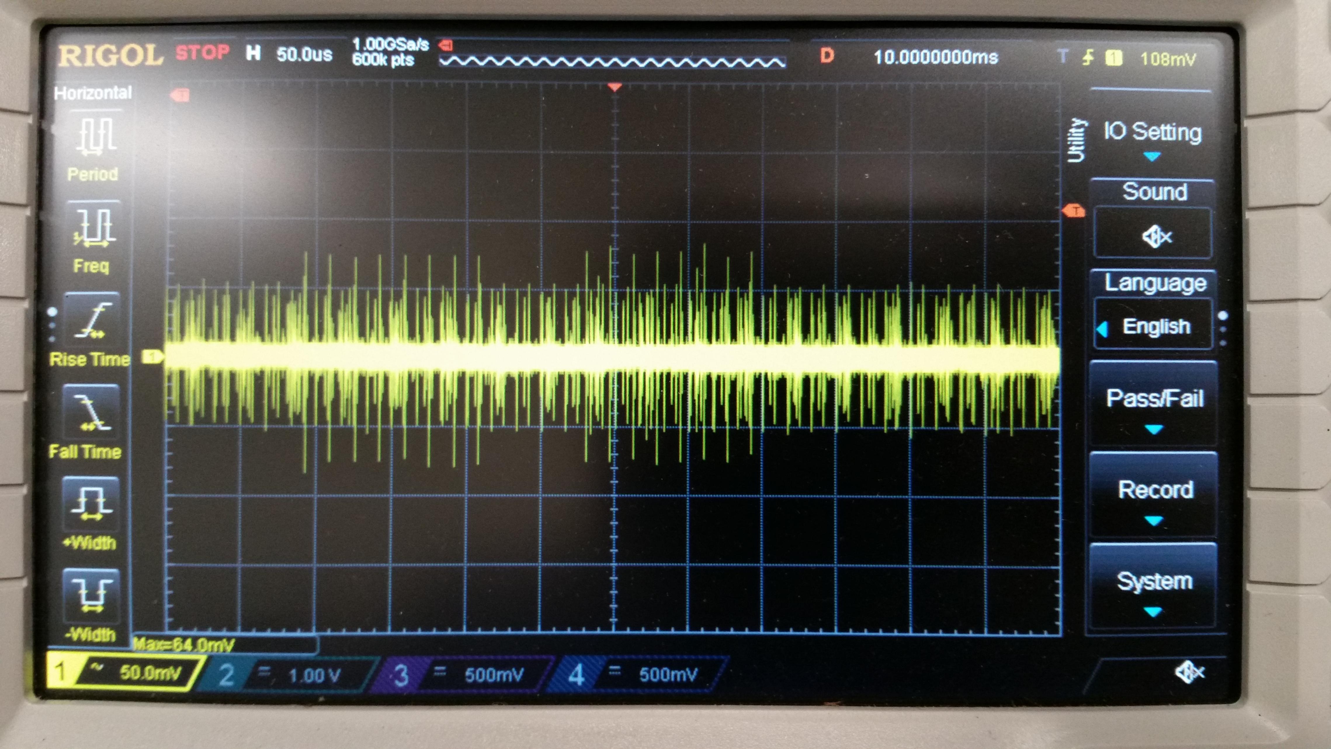

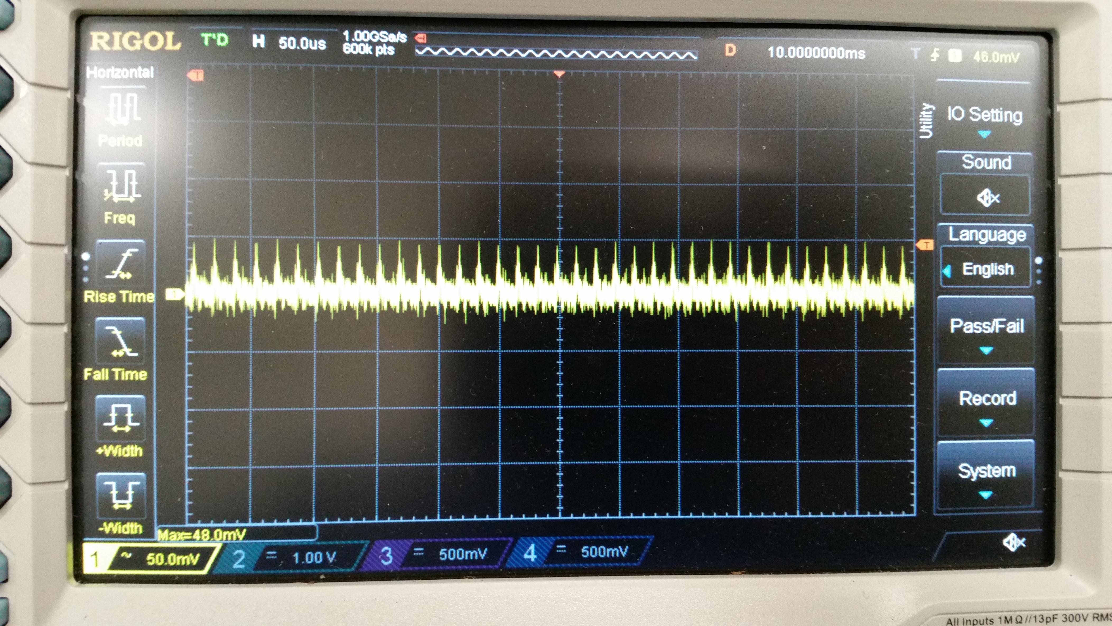

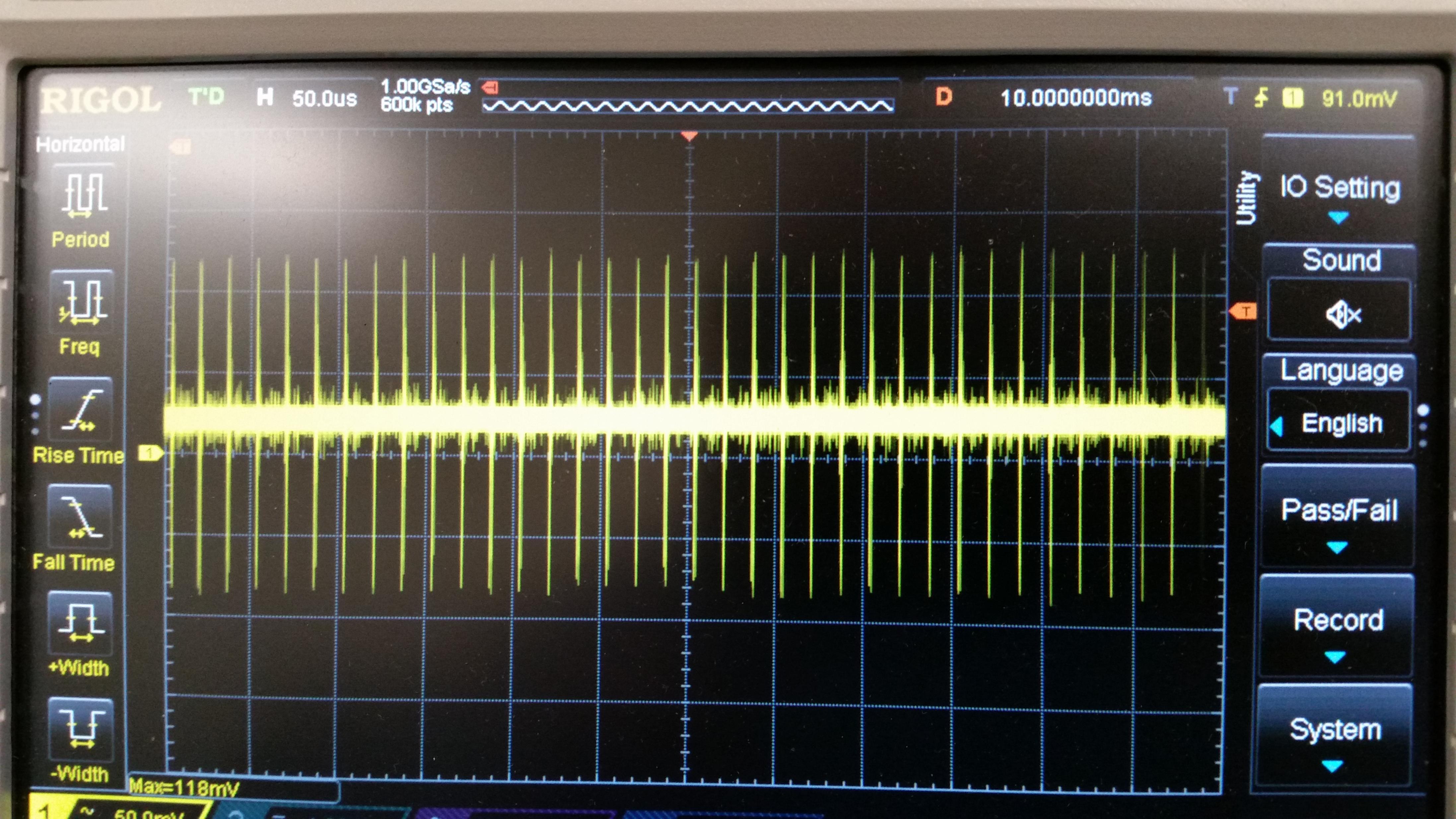

So the noise isn't really as bad as it seems in that first image, was way zoomed out on the signal.
Here I took 3 at 50us/div, in other words, the noise would have to be slower than 1 pulse per division to hear it. There is 1 of the module from China, one of a 19V Dell laptop brick made by Delta, and one of a 12V Mean Well supply.
These are still not the best measurements, what with the giant ground loops on my scope probe and all.
I need to find a small ceramic cap to put directly on the output terminals which will have self resonance at the frequency of the noise, should take care of most of the nasty HF stuff.
Then either swapping the main output caps with better electrolytic, or more likely just paralleling a few ceramics should get rid of the small amount of LF stuff there is.

No worries. I work in power electronics, although we primarily deal with batteries and DC-DC, and I am technically an ME, I just pretend to know what I am talking about in EE, not the point. An SMPS is basically just a rectifier and a buck regulator, so the principal is the same as on the DC-DCs I have dealt with. There is almost always a relatively simply way to get it down to an acceptable level. Here is a good write up from TI on the subject.
https://e2e.ti.com/support/power_ma...-measuring-and-reducing-output-voltage-ripple
Keep in mind also, that although the noise does get lower as we go through those 3 supplies, it isn't as startling as it looks. Taken as a percentage of full scale we have a 0.7%, 0.6% and 0.5% noise level. That difference is nothing to scoff at, but it isn't as night and day as the pictures would make it seem either.
