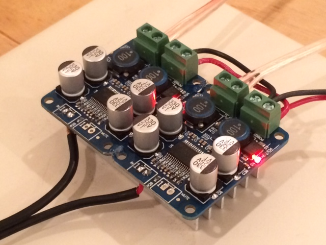

Is automatic gain feature present in these higher power TPA chips? I know some of the low power stuff has it (TPA2016 as an example). As I play with the SMAKN boards I posted, I have noticed that when a song ends, there is no hiss at all, but after a few seconds of quiet on the input I will hear a small amount of hiss appear.
I really need to dig into the datasheets, but you guys are just too helpful
I believe in TI datasheet they say 5% resistors are needed for gainsetting, but they might just mean not to pick more expensive ones
I guess it can't hurt to try. Maybe two 30k in parallel is 15k might be closer match to 20k. I will try tonight. Psyche myself up for some micro soldering. I need a 0.015in tip on my iron.
26dB gain works
I found the proper 20k and 100k resistors to implement 26dB gain. The values were amazingly spot on for such tiny resistors (measured 19.97k and 99.88k). Desoldering and soldering SMT's is a pain...
Anyhow, it works now at the lower 26dB gain.
I feel like the sound has more dynamic range - it sounds better even. I did not have a problem with on off thump before and I think it became even less noticeable than before with lower gain. Overall, a good upgrade mod to go down to 26dB. I did not listen extensively, just a few CD's as this amp is getting packaged to be sent to a friend in DK.

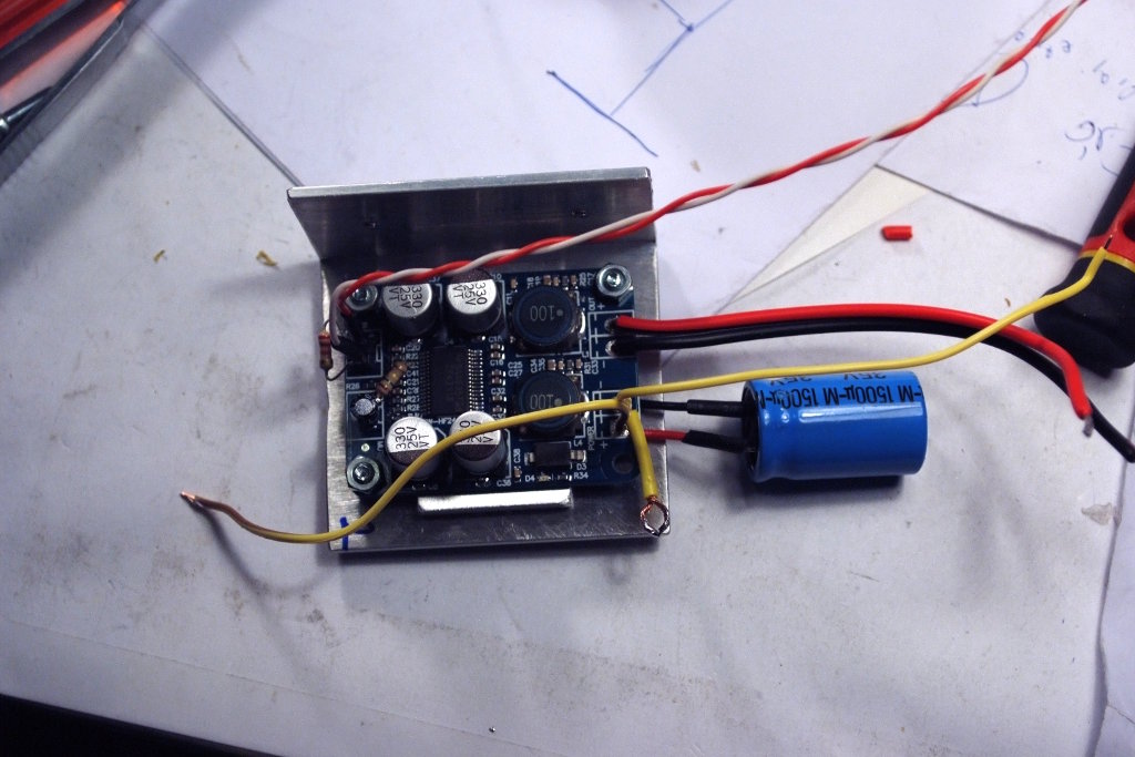

Thanks for reminding us. How did you do the jumper? I have a 1.63v SMT Zener diode, will that work?
Photos of your implementation?
I have just one poor photo of the (more or less) finished amp, before putting it in the enclosure.
I simply forgot to take detailed photos before delivering the finished mono blocks
Denis
I think gain setting is independent of mute - it's dependent on power up activities. Mute simply affects output transistors from working? If it defaults to some value you would think its 20dB ?
10k to mutepin connected from 75k gainsetting resistor on Sanwu when mute is connected during startup, so externally, on Sanwu pcb, gainsetting could be affected if only taking place during startup
