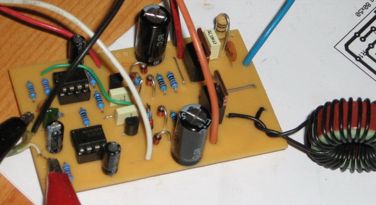

I made something like this. It's very similiar, only with little different feedback. Supply is +-35V. Comparator is LM311. Mosfets ( IRF530/IRF9530n ) remains cool, but there is a problem. Zeners heats up badly ( maybe +-35V is too much for this circuit ? ). Any comments ?

Problem was supply for comparator/buffer. It was +-12V. Now it's +-10V and everything is OK. No heating at all.
R8,R9 - I saw that in some older designs ( PMOS is slower than NMOS... ). But in simulations there is no difference ( maybe because i'm using IRF530/IRF9530N ). They have similar Qg,...( new Pmosfets are much better than old ones ). I will try with 47ohm both.
R12, R13 - They prevent huge gate currents. Without them, mosfet discharges trough zeners ( I'm not sure, but saw that in simulations ).
R8,R9 set on delay = dead time
size depends on real gate-kap. , simu wont help here
with my (old) irf 530/9530 those values gave good result, if you have new fets, just test...most time the p fet has bigger gate.kap. , so it needs smaller r.
r10/11 are just keeping the gates at zero Vgs , if no signal at gate , i.e. on power on
value can be much bigger, about 50 k, maybe 100k, depends on: how fast is voltage rise at power-on.
prevents rf-oscillations and limits turn-off speedWhat is the function of R12 and R13
the comp.supply adjusts itself by the output-power going into the zeners at the gates. so driving this supply with a low impedance source is no good ideaProblem was supply for comparator/buffer. It was +-12V. Now it's +-10V and everything is OK.
right, but i drive the gates +/- , not only +/0 , which makes a very simple shoot-throu prevention possible: when one fet goes off, voltage at the other can be set so low, its just turning on or still off , depends on the rZXCD1000 datasheet? Similiar to your output stage, the driver is only 9V, yours is 20V (+/-10V)
