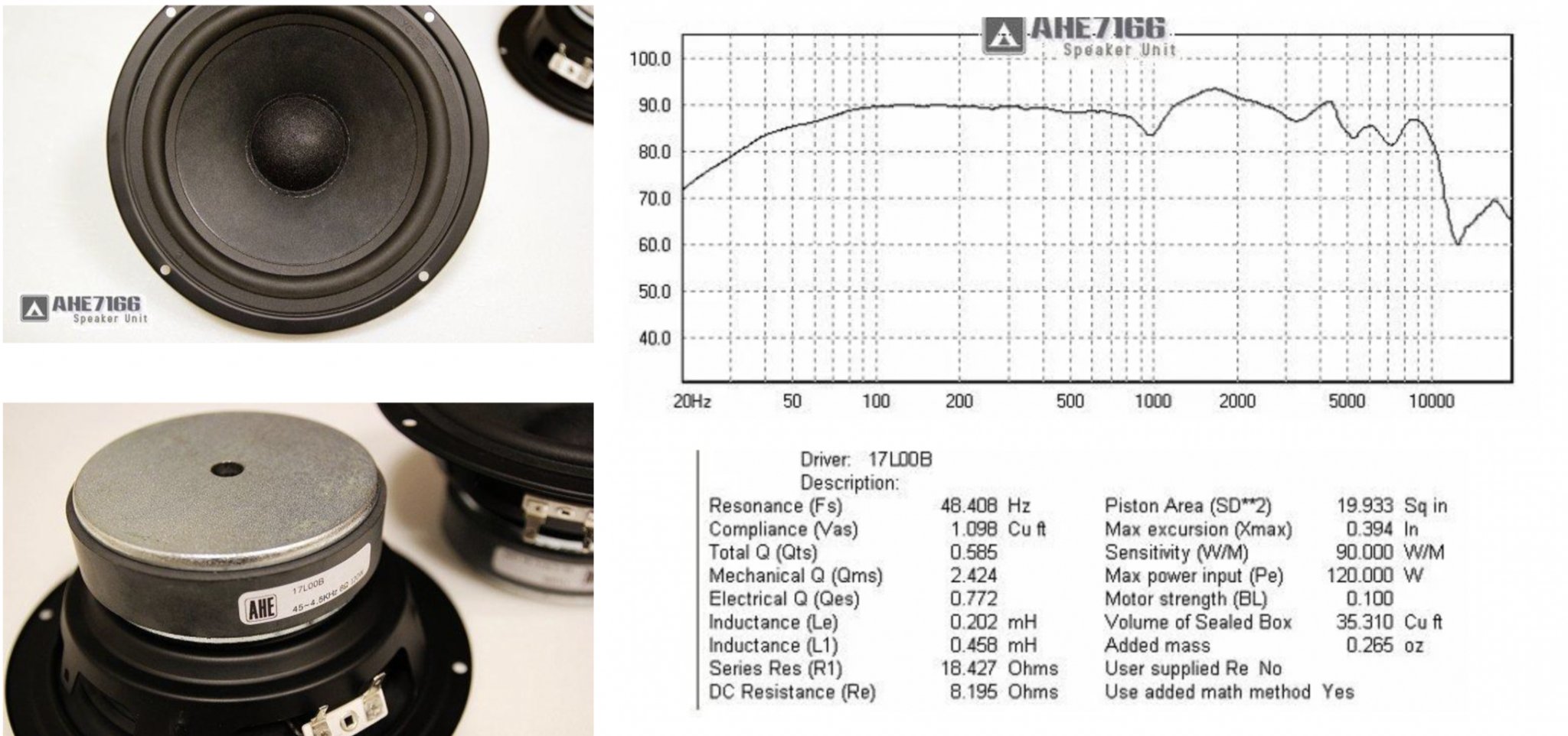

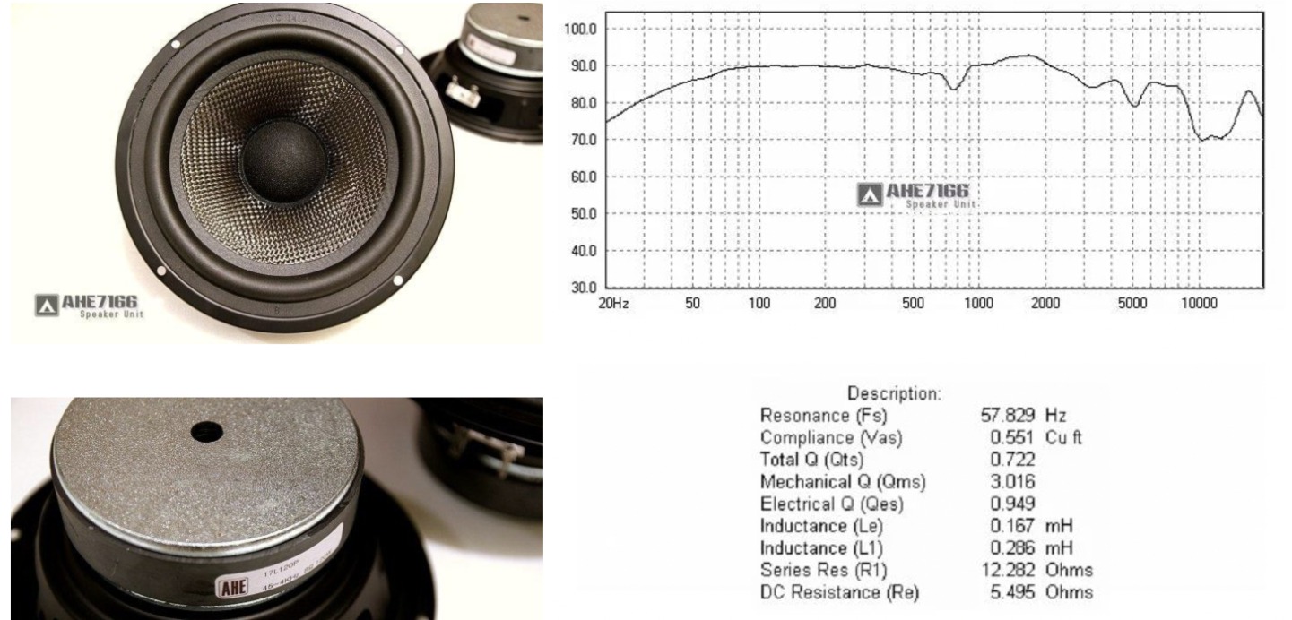

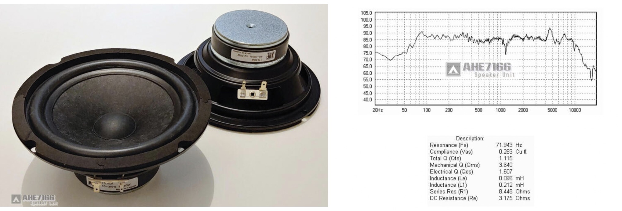

Looking at the GRS for the slob, they have a Qts of about 1, and Fs of 75Hz.
I have a few offerings here in the 6.5" version, one that looks a little like that GRS!
Some have higher Qts, some have lower Fs. Puzzled as to which one might be the best in a slob here.
Care to take a quick look and help me decide? Thanks!
