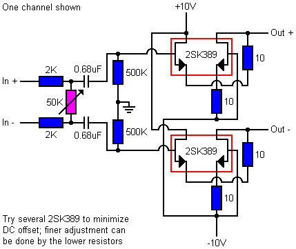

I'd like to ask how the resistance changes things, as the chip still has to deliver the same charge to the gate in both cases, so the same current over a given time.
IRF application notes 437 and 444 talk about calculating drive requirements and maximum frequency from gate charge (figure 6 in the IRF610 datasheet is the gate charge vs Vgs), but for switching applications. So how do you calculate in this situation?
One more question. Can I put a cermet potentiometer before the buffer for volume control, or will that, combined with the IRF610 capacitance, make a filter low pass enough to affect the audio band?

Prune,
The problem with capacitive loads on the output of amplifiers is described in the following article, along with how a resistor works to help stabilize the amplifier.
http://www.analog.com/Analog_Root/s...ols/interactiveTools/stability/stability.html
You’ll notice that the value of this resistor has to be adjusted to achieve optimum performance. In the case of JWB’s DAC, the series resistors are actually part of a filtering network (along with C33/34), and are the same values used in the 43122 evaluation board. The additional gate capacitances of the FETs seem to be small enough not to cause any problems.
As for adding a potentiometer between this filter network and the gate of the IRF610s, I’m not sure. It’s a very similar configuration to what is used in the Szekeres headphone amplifier featured in the Headwize projects pages. I like the idea of getting rid of a possible preamp, and directly driving a power amp with the DAC. I’d say go for it, and see what happens.
What greyhorse said is correct. The output of the DAC is driving the gate through an RC network. There should be no stability problems. If you felt like it, you could replace the entire line driver with a good opamp, but that would remove some of the Yourself features of this DIY project.

jwb, I'm not looking for design defects! My instance of your DAC design has been working fine for months, so you can add it to your count! Rather, what I'm after is adding a volume control before the buffer without making this too hard a load for the CS43122. In another thread I've discussed whether a potentiometer combined with the input capacitance of the HEXFETs could be a problem. A Borbely JFET follower seems one possibility; additionally, it has no DC offset so I can use smaller quality caps at the gates instead of large expensive ones at the output. Plus, it only needs a dual gang potentiometer for both balanced channels. With such a setup I should be able to drive an Aleph-X directly, without a preamp (putting a volume control in front of the Aleph-X is a problem since it already has a 10K shunt-to-ground resistor at the input, and I'd have to use a very low value potentiometer). In the picture below, input comes from the analog filter after the DAC chip.
Prune said:Rather, what I'm after is adding a volume control before the buffer without making this too hard a load for the CS43122.
Prune,
If you are tinkering with this design and want to add a volume control you should try adding a mono pot to attempt to scale down Vref pin of the DAC.
I've been curious to try this for a long time and these Crystal DACs are ideal canditates for this, AFAIK you +5V analog supply is only used for Vref. If the DAC works well with lower values you get the benefits of a passive analog volume control with no output impendance effects and no channel tracking issues (ie you don't need a stereo pot).
There is no mention in the datasheets about Vref being anything other than 5V typical. I am really curious about the performance below that since this is a delta sigma dac so it should work just as well with any reference voltage within limits.
The analog supply also goes to VA, so I can't mess with the regulator output. I don't know what current VREF draws, and whether a pot as a voltage divider would work for VREF.
