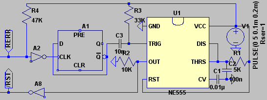

After a long time being lasy I decide to build this DAC and I want to ask a few things.First I want to know about this DAC is autoreset.If s/pdif out of some device is turned of and turned on again do I have to reset DAC manualy???Also I want to know that can I replace LT1962 regulators with LM7805.:confused:
If anybody know please help.
Thanx in advance
This design is not auto-resetting. Sometimes you must reset the receiver manually after disconnecting the cable.
LM7805 would not fit on this board, but you could alter the design to accomodate them. LM7805 will have worse performance in this role compared to LT1962.
Unfortunately I have no boards for sale. The drawings are available for download in this thread, and they are ready to be sent to board manufacturers.
Good luck!
DJ_Looly, this was posted earlier. See attachment.
I'd like to try shunt regulators. What would be the most appropriate parts to substitute, i.e. making minimal changes to an existing build?
