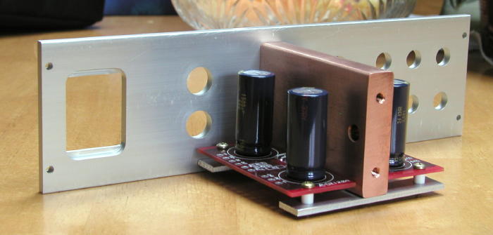

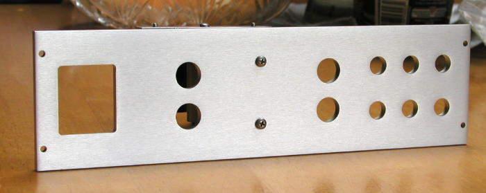

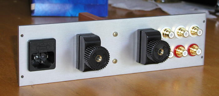

Here's the pic of rear panel. Those who want to install patented posts will have additional holes made.
Well, those guys are proffesionals. While I was there, I saw panels for Convergent Audio Technology preamp (CAT-1), panels for Anthem and Simaudio. My chassis is done the same way as the stuff for those companies ( or maybe even better as they already mentioned I was very picky)

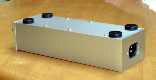

I know times are sketchy on the forum/buys etc, but if you care to elaborate as to the method by which you connected the endplates to the (assumed) rectangular tube for the DAC, it would be interesting. I have a few plans in mind, one for a completely externally screwless GC and one for a hidden tie-rod project, but it seems you've achieved the second one with your DAC.

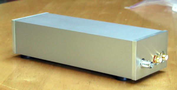

The rear panel is attached to the receptacle and that is attached to PCB. It's not very strong connection, but works fine. The PCB is mounted on standoffs which through matching holes are attached to the bottom of the tube.
I was thinking what would be the best (and simplest) way to mount front plate. I could use nuts from the RCAs and BNC for that, but for some reason I didn't have much time to play with it.
So I just used double sided tape to glue the front plate to tubing and it works like a charm. This DAC was at the Show and I didn't experience any problems in this reagard. Additional advantage is that the tape separates the front plate from tubing (which is connected to AC ground) so the BNC jack doesn't need insulators (which for that type were not easy to find).
