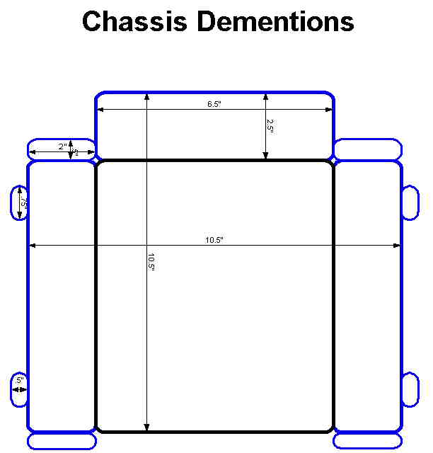

The wait should be over soon. Everything is done, except for printing. I'll be picking up all parts on Tuesday (except for front panels that require silkscreening),

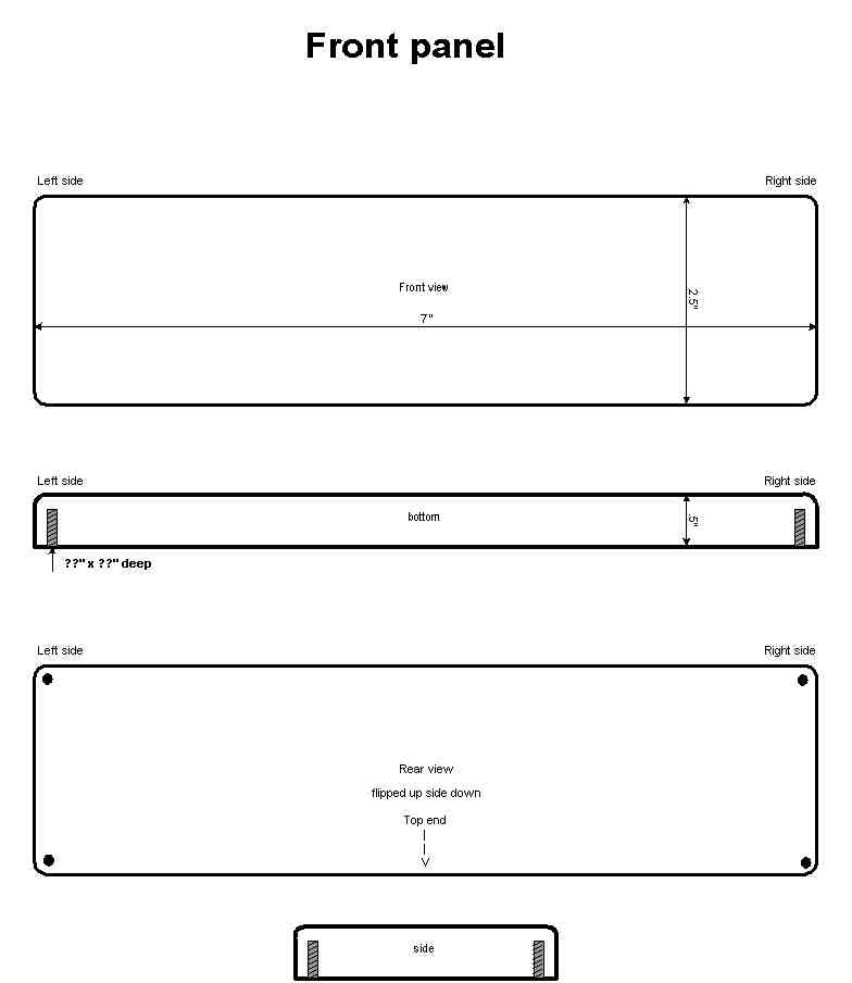

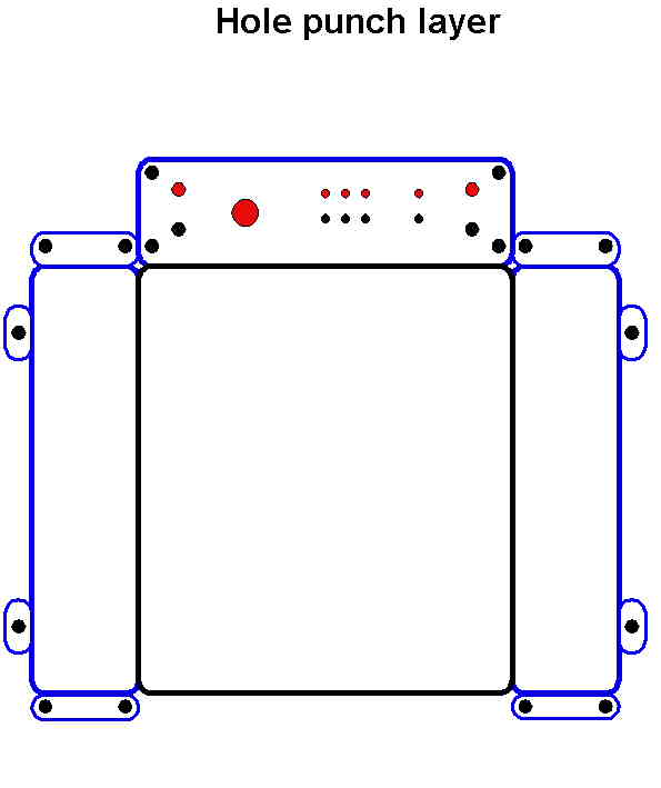

Front panel size is 3 x 10.7 , knob are spaced 2.5" from the sides . Depth is approx 9". I may post rear panel drawing later (as soon as I get my main computer running).
Not to rain on Peter's parade...
I am having my chassis built now, and I designed it so that it could be a kit banged out and sold here for anyone who needs one.
I will post the plans here one by one.

Hate to say it, but they are still banging.
I called a few minutes ago and he said there was no problem building these, but he wanted better measurements..
I will revise the measurements for him and send them to him later this week.
I hope to have a box next week. I am NOT committing to a date though!! Been down that road before.
Also, I would expect the parts to be around 30-50 dollars.
I will have him bead blast(BB) the chassis and clear coat it for me. I may have him BB and anodize one too to see what that looks like.
Troy

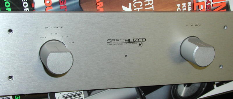

I had some problems with artwork but it seems like it's sorted already. The second artwork was in proper format, but I didn't notice that fonts were not in scale (some were unnaturally wider than the other, Especially letter 'O'). They made a trial run yesterday on one panel, but I didn't accept it.

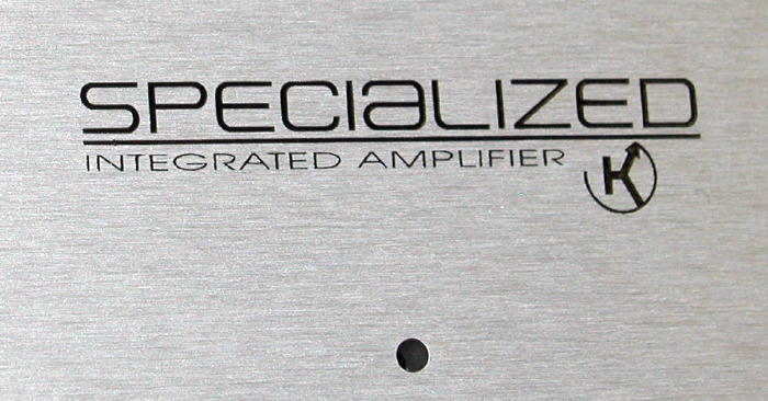

I was told they the panels should be ready on Monday for pick up. This actually gives me some extra time to sort everything, prepare hardware, cut the metal brackets (to support PCB) and cut the wood panels. I still didn't receive pots from Percy either. One more pic of front panel. All letters in SOURCE will have the same width.
I specified two panels without logo, just printing on knobs (for Colin an Jamh). You can still change your mind if you want.;)
