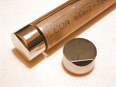

Since talking about knobs seems to be very popular these days, check out what can be done with a simple drill press and a small grinder:

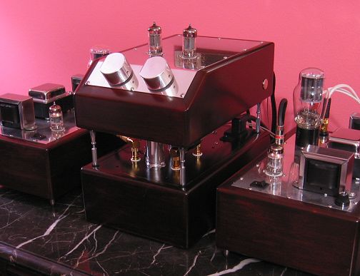

Even the last picture picks up the blue from the walls of the room. Anything mirror polished just does what it does best - shine.

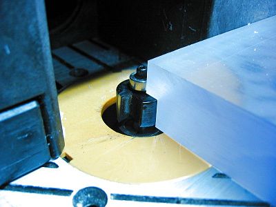

I should have been a machinest or carpenter, as I love to make stuff with metal and wood. My gainclone is my first to work with acrylic, but it's not to hard. I cut the 1" thick sheet with a 80 tooth carbide blade on my table saw, clean it up with a table belt sander and machine it on a table router. I even drilled and tapped it.

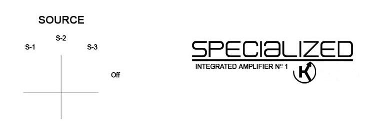

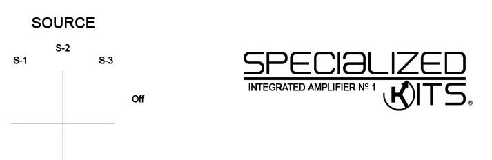

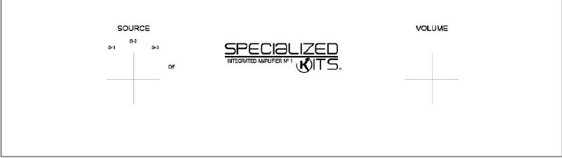

Here's the proposed front panel printing. Specialized logo will be smaller as well as SOURCE and VOLUME will use thinner line fonts. Any suggestions/objections?
I used "Off" position at source select. This is when no source is connected and can be used to mute signal without turning a volume knob.
There will be only one artwork for printing, as I will go with one silkscreen mask (template) only. So it's up to majority what they want.
There will be no printing on power amp front panel (no pots version).
Custom silkscreening is possible, on individual basis. An artwork has to be provided and fee is $120.
zeno said:[BI would only prefer indications for volume and source, but no logo.
[/B]
I believe there is a chemical that removes this printing, so you could always take the logo off.
