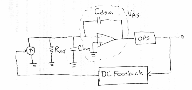

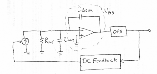

My questions were mainly rhetorical in nature. I was just trying to get you to think about it in a different way. With that in mind, I've attached a picture to try to clarify what I'm getting at.
A properly designed VAS should act in many ways like the op-amp integrator shown in the picture. The current source is meant to represent the diff amp output current for either the simple Rc case or the current mirror. Likewise, Cout and Rout represent the output impedance of the diff amp. For the simple Rc case, Rout=Rc and Cout~0. For the current mirror case, Rout is the output impedance of the current mirror and Cout is its output capacitance.
The open-loop gain of the integrator is assumed to be very large, so the voltage from the inverting input of the op-amp to ground is very small. So then, what effect does Cout have on the circuit?

A less conventional way to answer to your question is to apply the Miller theorem. The equivalent capacitances are then CinVAS=Cdom*(1+A) and the output as CoutVAS=Cdom where A is the VAS gain. If A is very large, obviously CinVAS will be much larger than the whatever previous stage output capacitance. This is an approximation that holds in 99.9% of the practical cases.

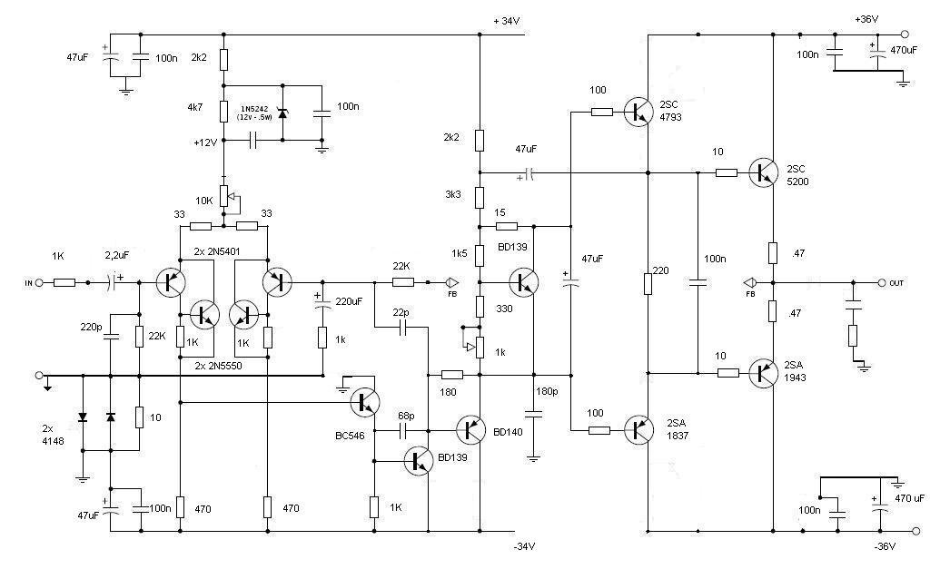

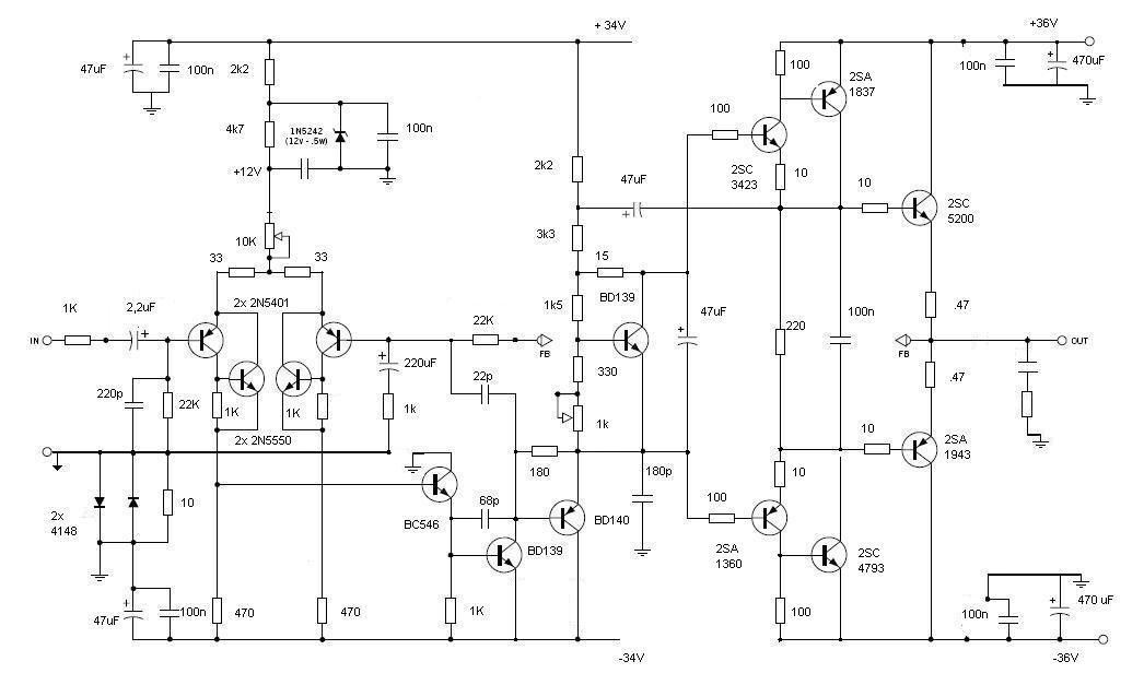

If yes, then I can say, that this circuit delivers very good simulation results. Unfortunately the simulation don't respect all parasitic effects through layout and mass management (GND management), and I know, by this circuit it isn't easy to develope a succesful layout. The internal open loop gain is very high. Not so the open loop bandwidth because two voltage gain stages in the NFB loop (Cdom is absolut necessary)
Also a good design is that you see at botton in the pdf file and it is less critical concerning the layout. This circuit was a diy project of the German hifi magazine "Stereoplay" arround 1987. The Autor was Mr. Günter Mania, the owner from todays brand AVM in Karlsruhe. Please note, that this amplifier runs in the inverted mode (input resistance = value of input serial resistor) If I haven't class A in the output stage (only 20-50mA idle current), I would prefer this topology, if the output stage is in the feedback loop.
