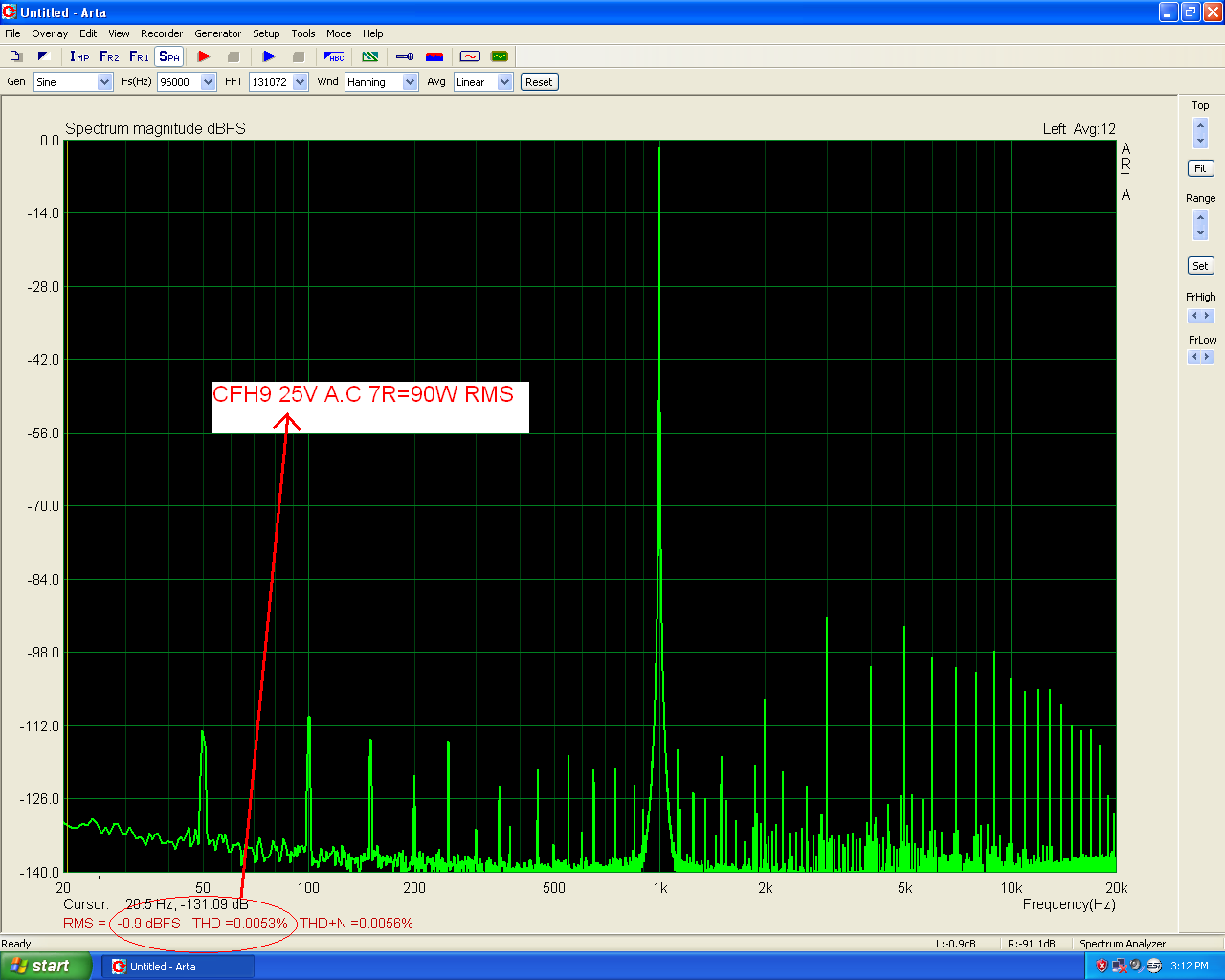

Thimios this looks über professional straight out from NASA's secret black budget audio research project, a golden diploma signed by Wernher von Braun is on the way and a schnapps Ouzo on top of it!

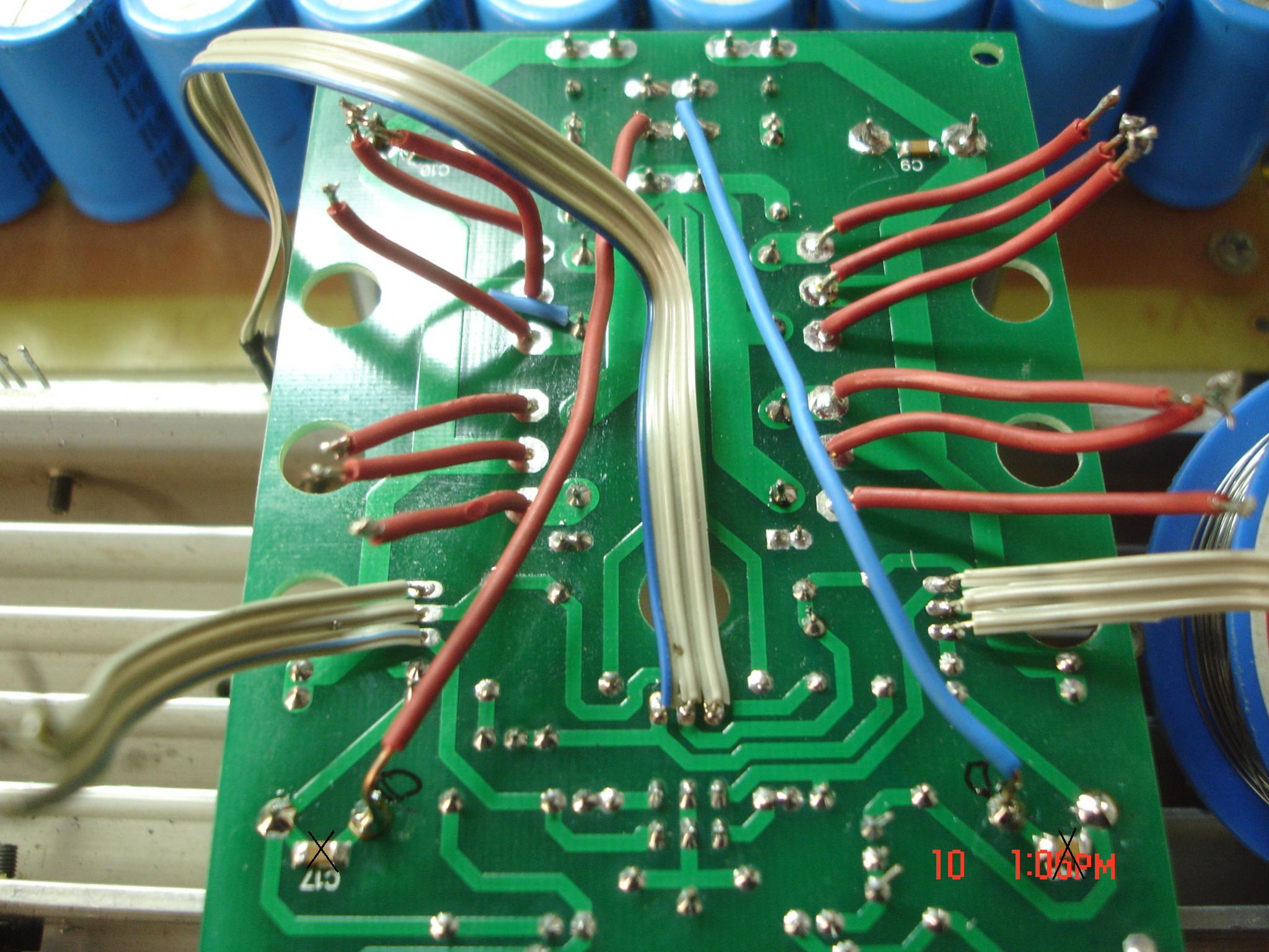

It would be helpful if you can show a photo of the PCB with where to cut traces and where to reconnect etc. If you could edit the original bare PCB photo that would be great. We have a lot of folks in the GB who would benefit from a detailed explanation.
Here is what you ask about.Great work Thimios - thank you so much for being the pathfinder!

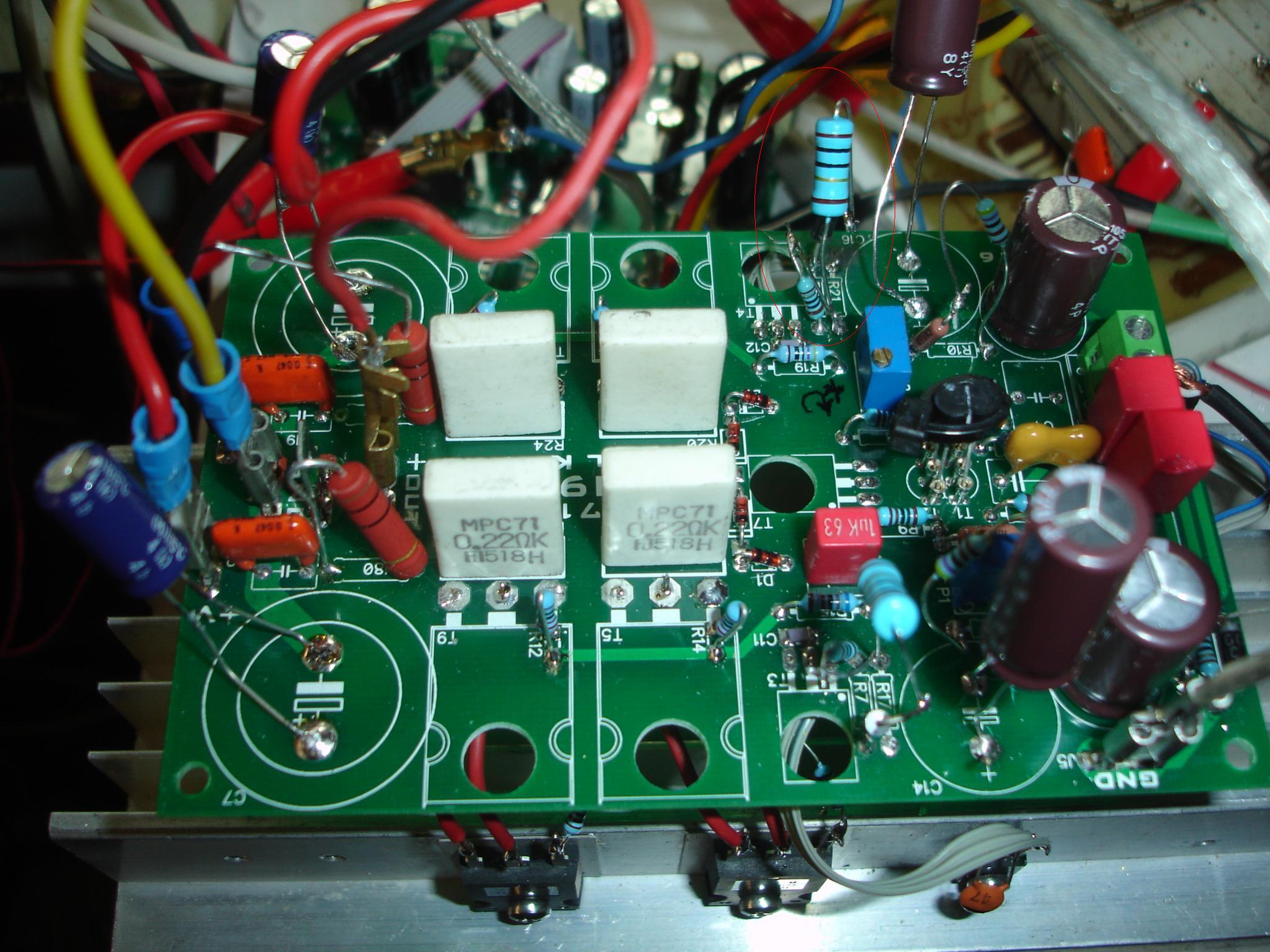

To the existing board cut these two points as in the first picture and solder two wires to the Power GND as in the second picture.
Do not forget the installation of two diodes following schematic IN POST#819 NOT AS IN FIRST PICTURE HERE.
Please add the diodes as in the last picture.

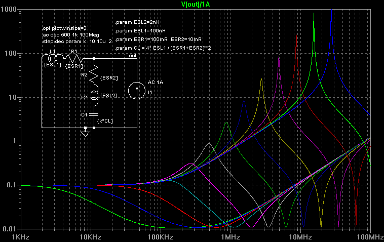

Hi X you know I'm just hobby diy in this area so don't count on me but wonder why when your sim showed better performance and many reported better sounding amps is seen with high value bank soldered onto amp PCB. Therefor can we suspect its simply because bypass capacitor is too small value in being only 0,1uF and that one needs to be at least 1uF or bigger maybe a 4,7uF or 10uF will do it. At this link advise is go higher values or don't bypass http://www.diyaudio.com/forums/powe...ing-psu-capacitors-effective.html#post1566979.
Here is visual, say it happens because that 0,1uF is too small in value it spikes as those in 1-10mHz area say the yellow one. First red from left is optimal but also first blue and green is better than those spiky ones later so therefor its better go too large in value when gear to measure in actual situation is not available.

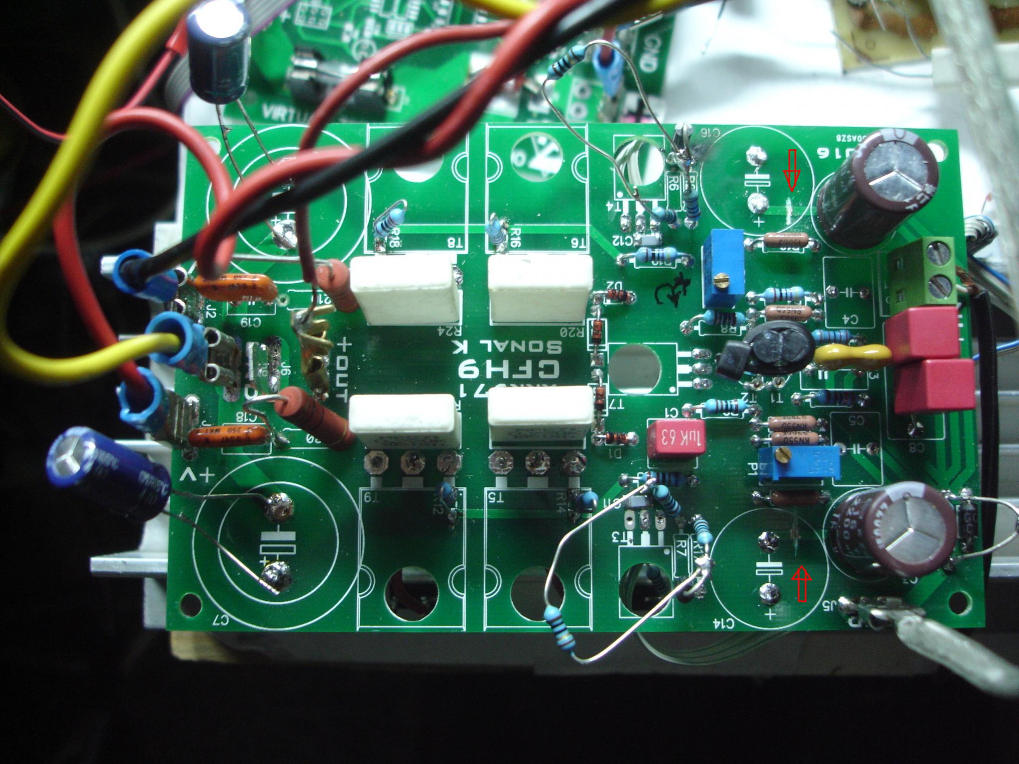

The basic problem isn't on the big electrolytics but on the C16,C14.It is absolutely necessary to rearrange the GND added these 1N400X diodes AND power the VAS after the 10R.
The Shaan's recommendation<<Also put a trimmer with the negative side's 15K as well for best control over offset. These trimmers will be able to fine-tune VAS bias to some extent without changing VAS emitter resistor so you get two operations in control in one mod>>. is the final solution for VAS current adjust and offset setting on mod!

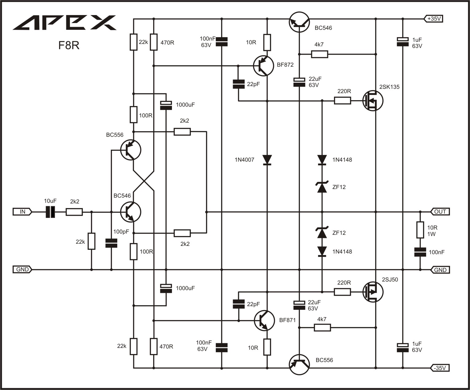

Why not add a circuit like this instead of a resistor for VAS and input?
This give me idea for F8R, thank you.

Hi Apex,
Very cool! Is that all it takes to add a cap Mx to protect the VAS and IPS? Can you show us how to size the cap and resistor? Is it basically setting the RC time constant to be well below AC line ripple of 50Hz/60Hz?
Would a BD139/140 be ok to use here or MJE350/340?
