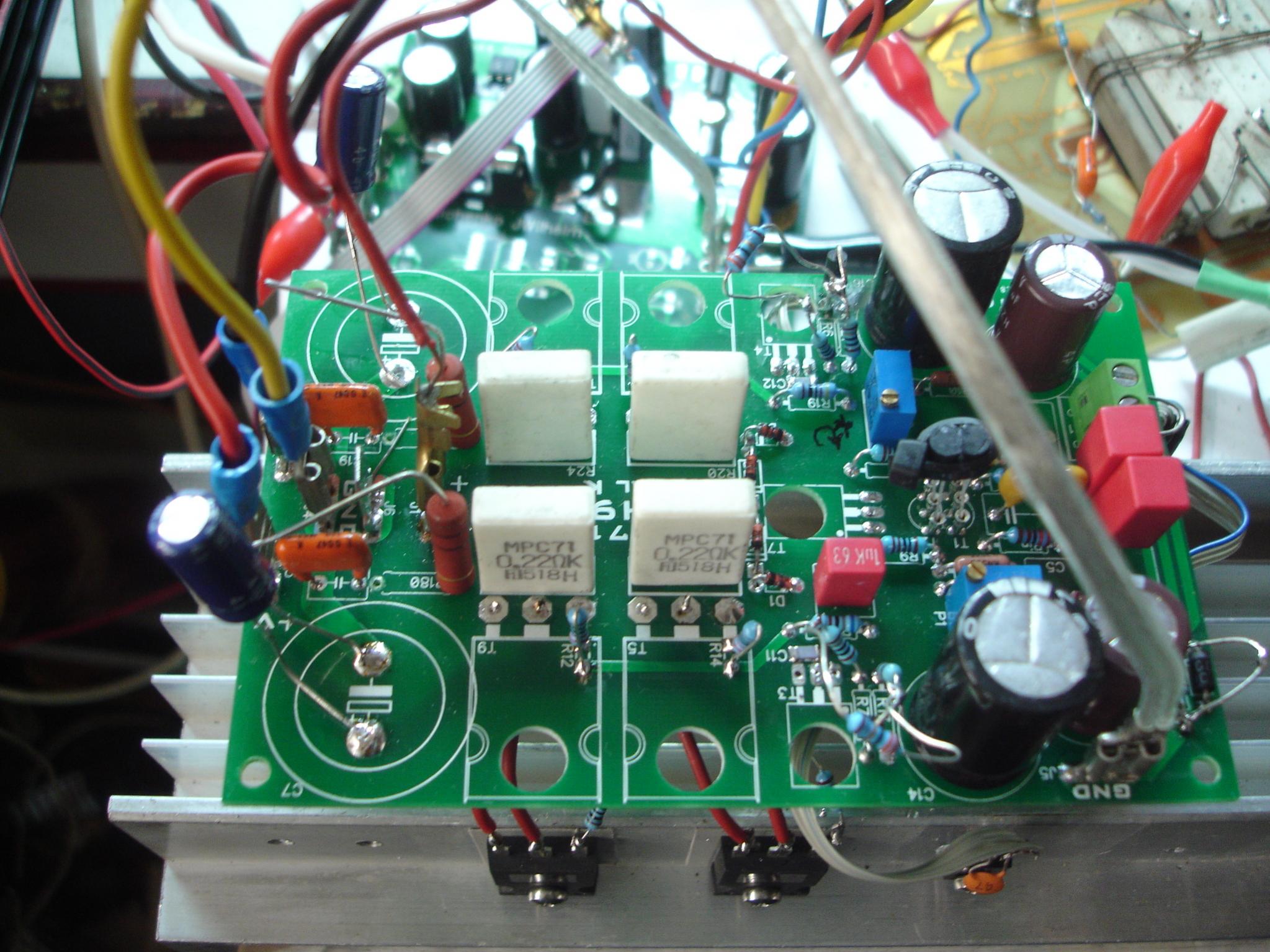

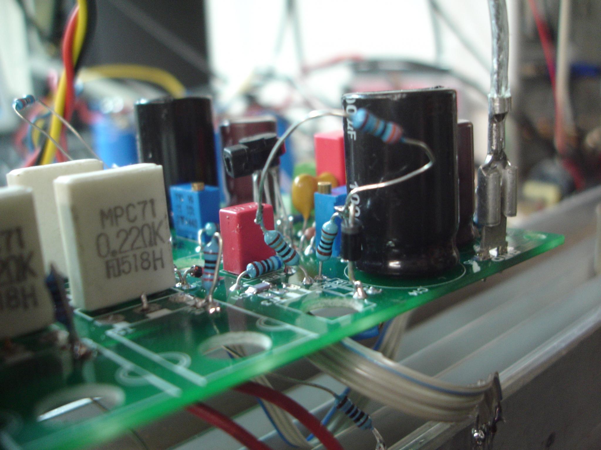

I don't know if you have read that in the past i had tried to lift this power gnd and leave the gnd for the two input filter capacitors (C14,C16) connected with a separate link to star gnd.
This configuration wasn't good.
See picture
See the power traces from the main filter capacitors to these capacitors. There are(were) two MOSFETs in that trace with no local decoupling. Then a 10R resistor that feeds the capacitors you mentioned and these capacitors feed the input section only. But the VAS is connected to the dirty rail with a 10R with these capacitors having no effect on VAS supply quality. VAS does almost all the voltage amplification and is actually more important in an amplifier than either input stage or output. If VAS supply is compromised then naturally the result could not be good.

No need for cutting,just lift R7,R17, fit a diode and connect the resistors after the diode.So perhaps cut the trace between big caps and Vas caps and out maybe a 10R 1W resistor there to decouple?
The same for R6,R21.

Hi guys,i must say that the problem was the two input filter electrolytics,up to now i didn't have the time to install new parts here so i can't say if this will work.
What i know for sure is that i have even better results.
Up to now it seems that we can save the pcb.

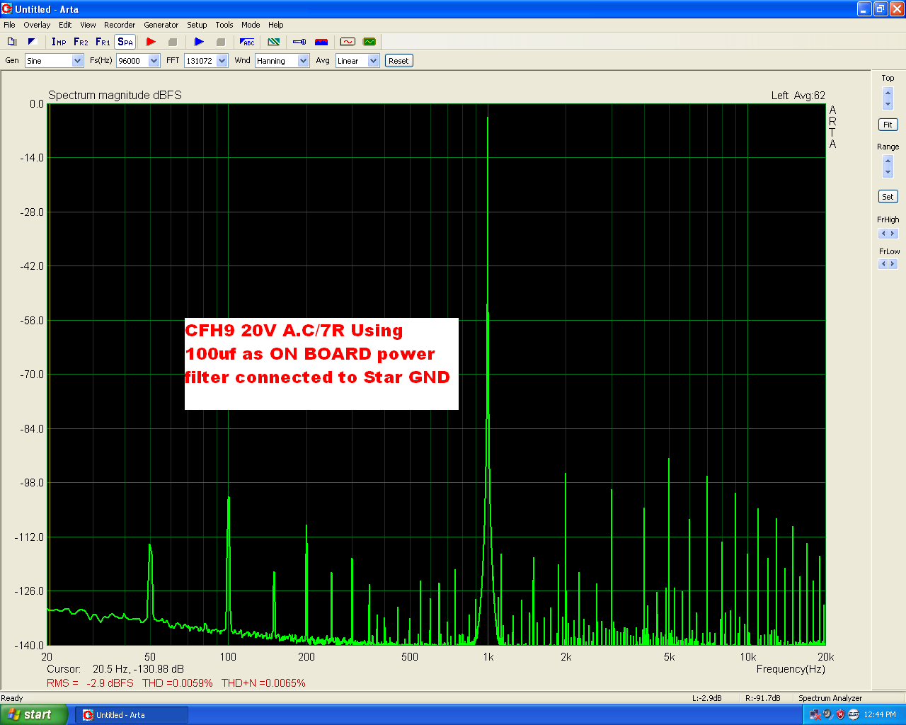

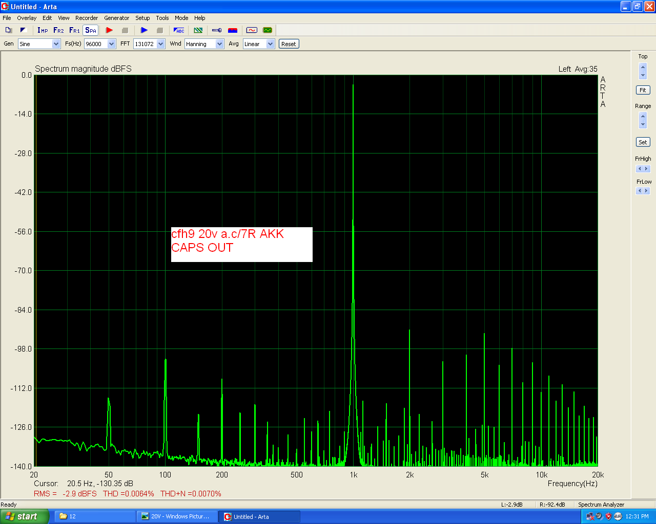

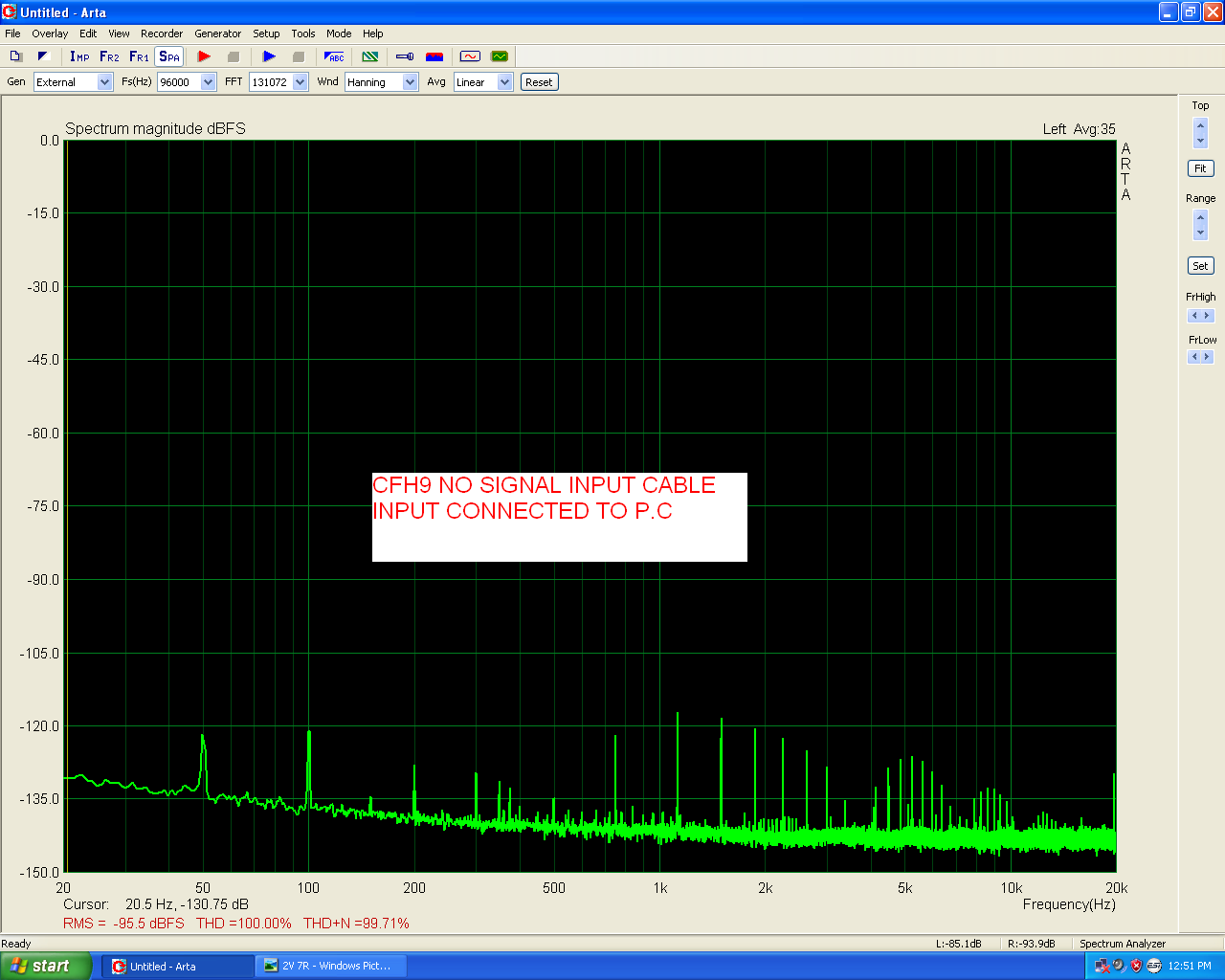

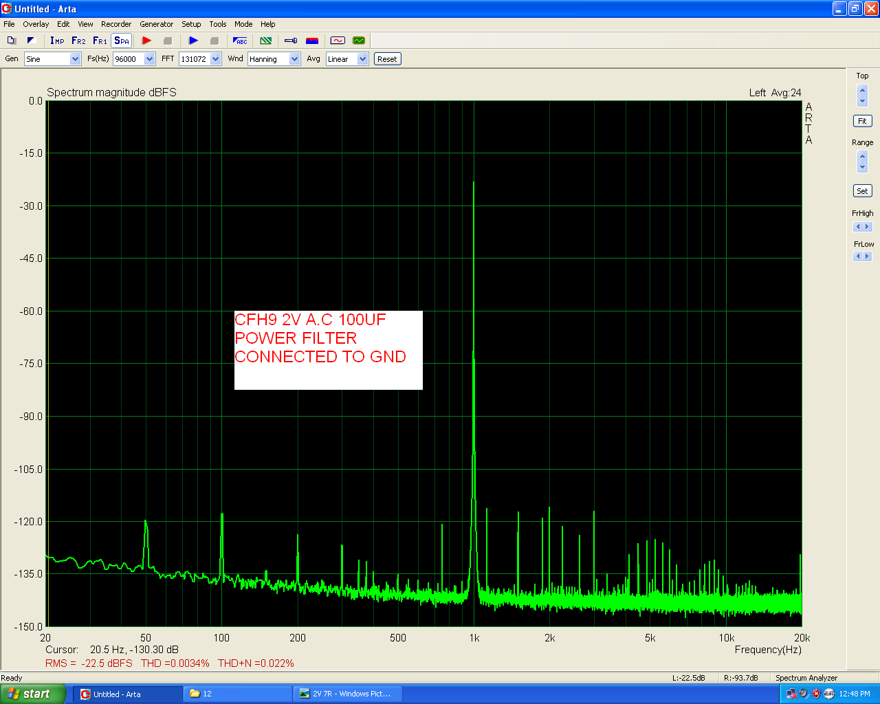

What i have test up to now.
Power supply=+/-50V
VAS current=10mA
Idle current=40mA
Offset=0mV
No zobel!

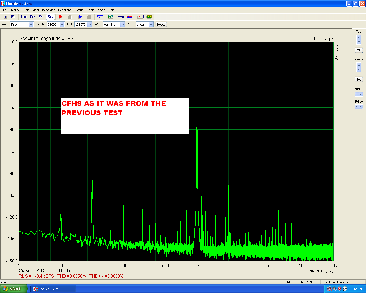

Picture 1 amplifier as it in the previous test.
2)Without on board power filter caps.

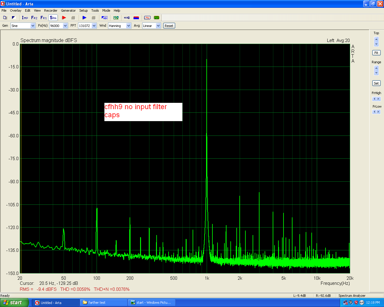

3)Without on board power filter and input filter caps.(please reed the AKK as ALL)
4)Only 100uf on board power filter caps installed and not connected to GND.(50uf rail to rail)
5)Only 100uf on board power filter caps installed and connected to GND.(2V A.C OUT/7R).
6)Only 100uf on board power filter caps installed and connected to GND.(20V A.C/7R OUT).

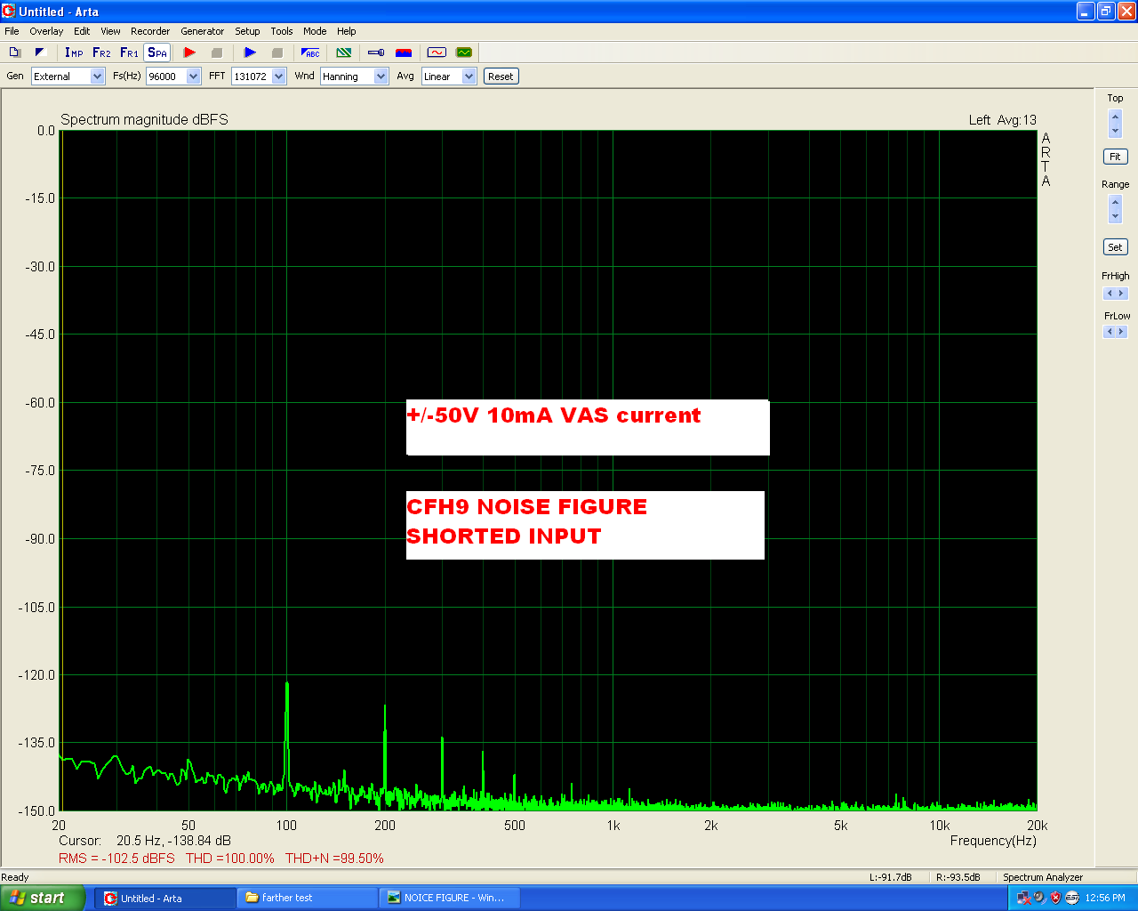

7)Noise figure when amplifier input connected to P.C without signal.
8)Noise figure when amplifier input is shorted.
9)2x100uf INSTEAD OF 4700uf ALL smd 100nf NOT INSTALLED
10)The position where 1N4001 installed.
Wow. Dang!!!
You are the master detective and pesky B@stard killer!!!
We all eagerly await the final summary of critical changes to make it so. Sounds like big rail filter cap causes problems? Don't understand that as it could as well be big cap from PSU upstream.
One more question: does this mean that the main noise is the 100Hz ripple from PSU so PSRR is -120dB? Then True noise floor without power supply ripple is -150dB??? That's astounding.
