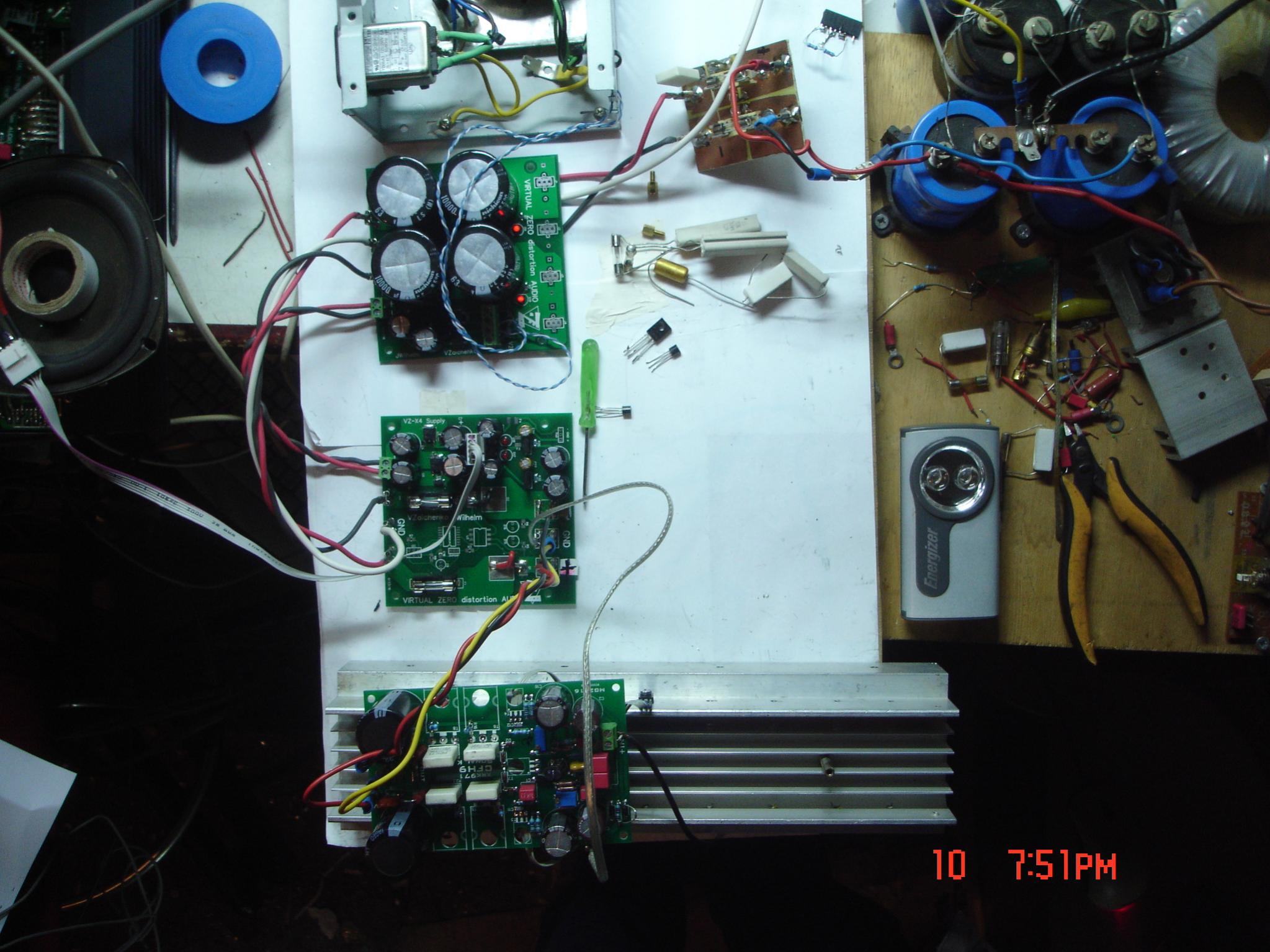

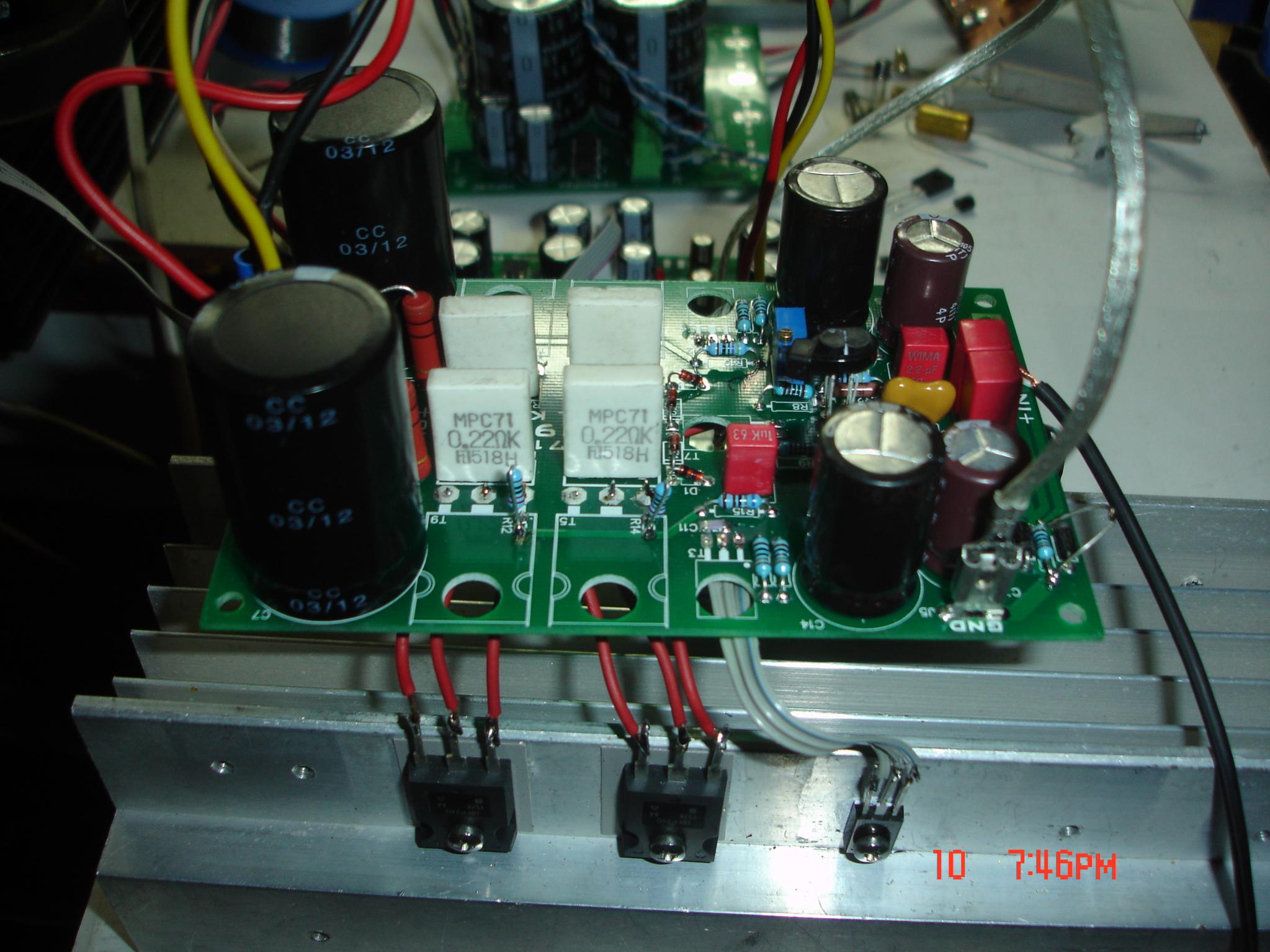

Here is the last test bed.+/-50v
I have to add 3 pictures.

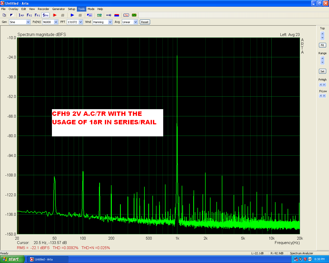

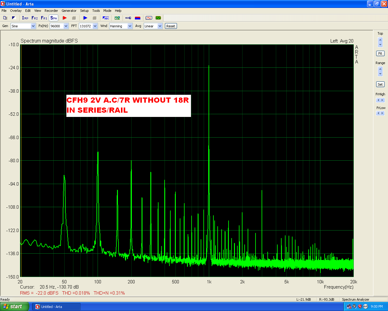

1)testing using +/-50v(5mv ripple)
2)the same but using two 18R/RAIL in series.

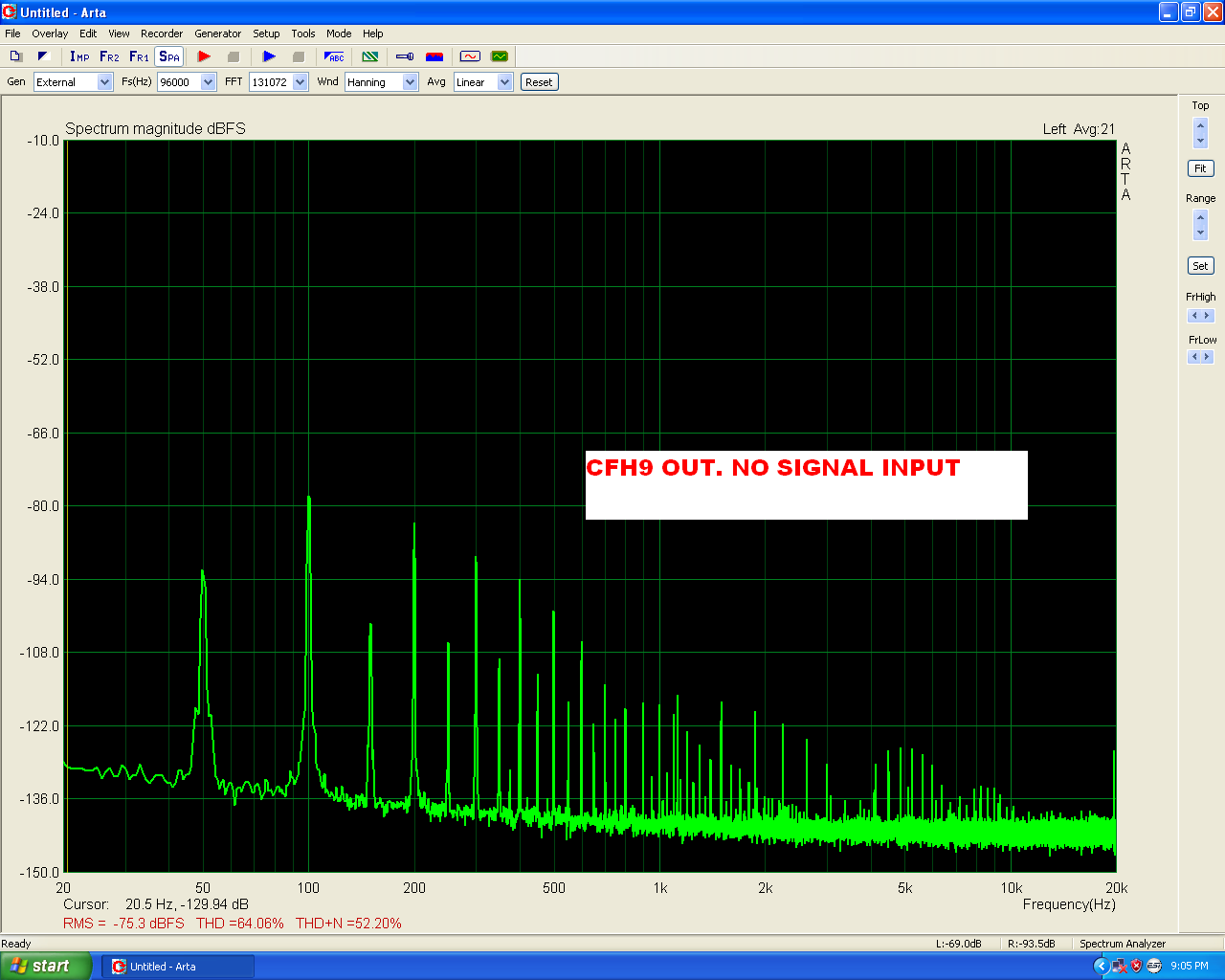

3)what out is, without any inp signal.

He he good questions!Nice setup. I have a few questions.
Is the heatsink connected to psu ground?
Does PSU connect to mains earth? If yes then is there any loop breaker between PSU ground and earth?

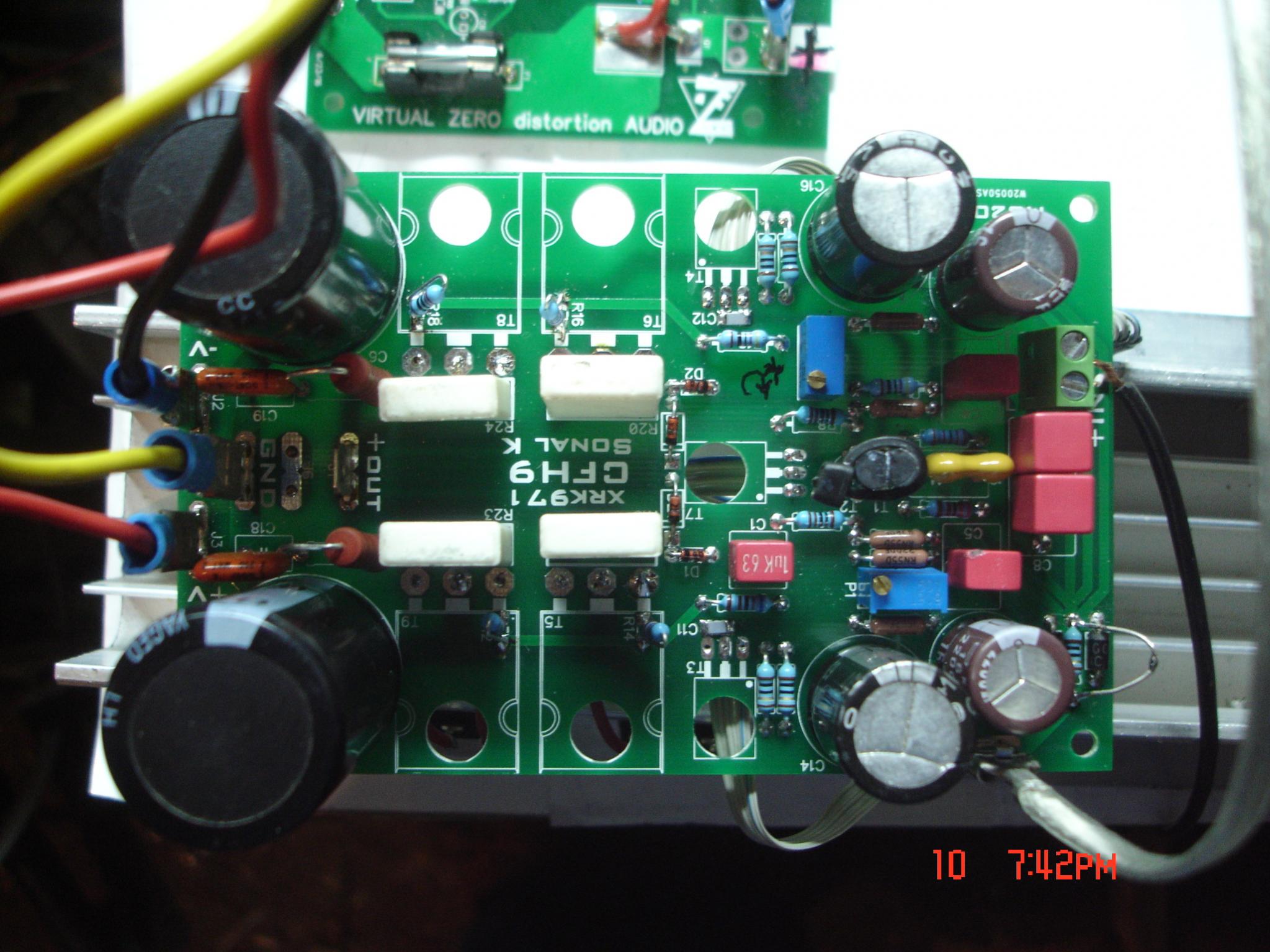

Shaan do you believe that these <<flying>> transistors would be a problem?
I was typing exactly this when went back and saw you updated your post.
Answer: they well can be. You know what to do.
Yes i know,just trying to save the moneyI was typing exactly this when went back and saw you updated your post.

Now i can't believe that the problem have something to do with the <<flying>>transistors.

Sorry I do not understand what you meant by the first two sentences. I only meant that you may want to mount the transistors directly on board and fasten them all in a heatsink.

Long leads on transistors cannot be helping the situation. I will check if putting a jumper between two ground circuits helps. It has something to do with layout topology and that extra ground system for the inputs.
But as I said, with the cap multiplier it's not an issue. The additional MOSFET and two caps is a cheap trivial solution with lots of benefits beyond hum reduction.

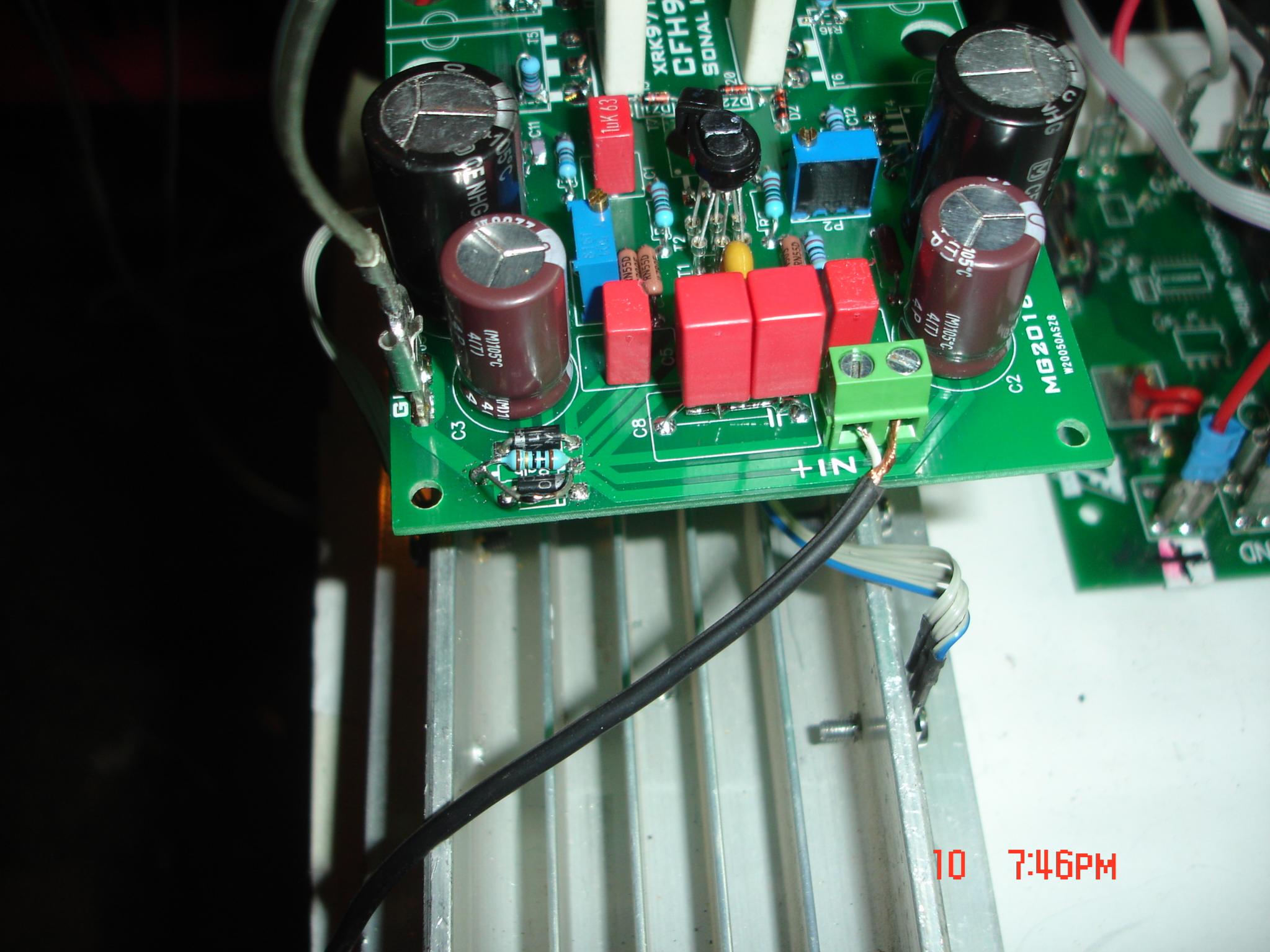

X, The rearrangement in the signal gnd make the results better as you can see on the graphs where output traced without any input. signal,but can't solve the problem.
In all the CFA topology PSRR is low and a little hum is present but in your amplifier something is strange.I will try to find a better solution for the heatsink and i will report again
i did the same for my Jason VSSA build and it worked fine...Jumper the ground lift, as Shaan already recommended
