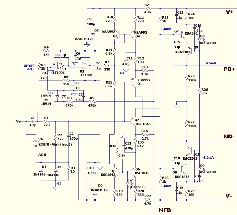

My axx002 "chip" ...
I'm too cheep to buy the epoxy ... let it be thermally stable in the wind :D .
I decided to use the Servo (ahh , the "evil" servo - below 1). But , one jumper
in the servo section (that I will add) ... bypass the servo to use just a trimmer.
At least the servo is 0 phase from .1hz to 1mhz (no inversions).
I also used a simple (yes) ... LED CCS X 2 . (below 2 -whole contraption).

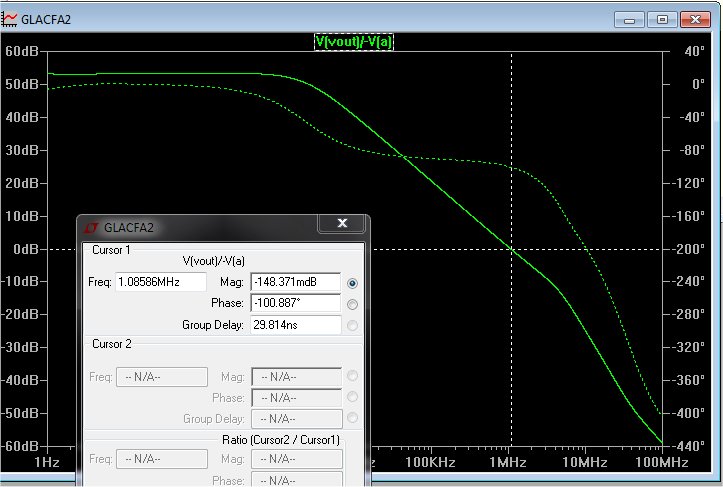

Besides having 30 or more DB PSRR , it is the same as my baseline VSSA
simulation at 1.1mhz UG. (below 3)
DID the temp-co , slightly negative from 10-50C ... led CCS cancels the
hawksford led's. SW is perfect and THD20 is 15ppm. Very good for a 2 device
"toy like" IPS - actually as good (or better)than a symasym or leach.
Off to the "races" :) ....
.asc below (as well)..
OS
