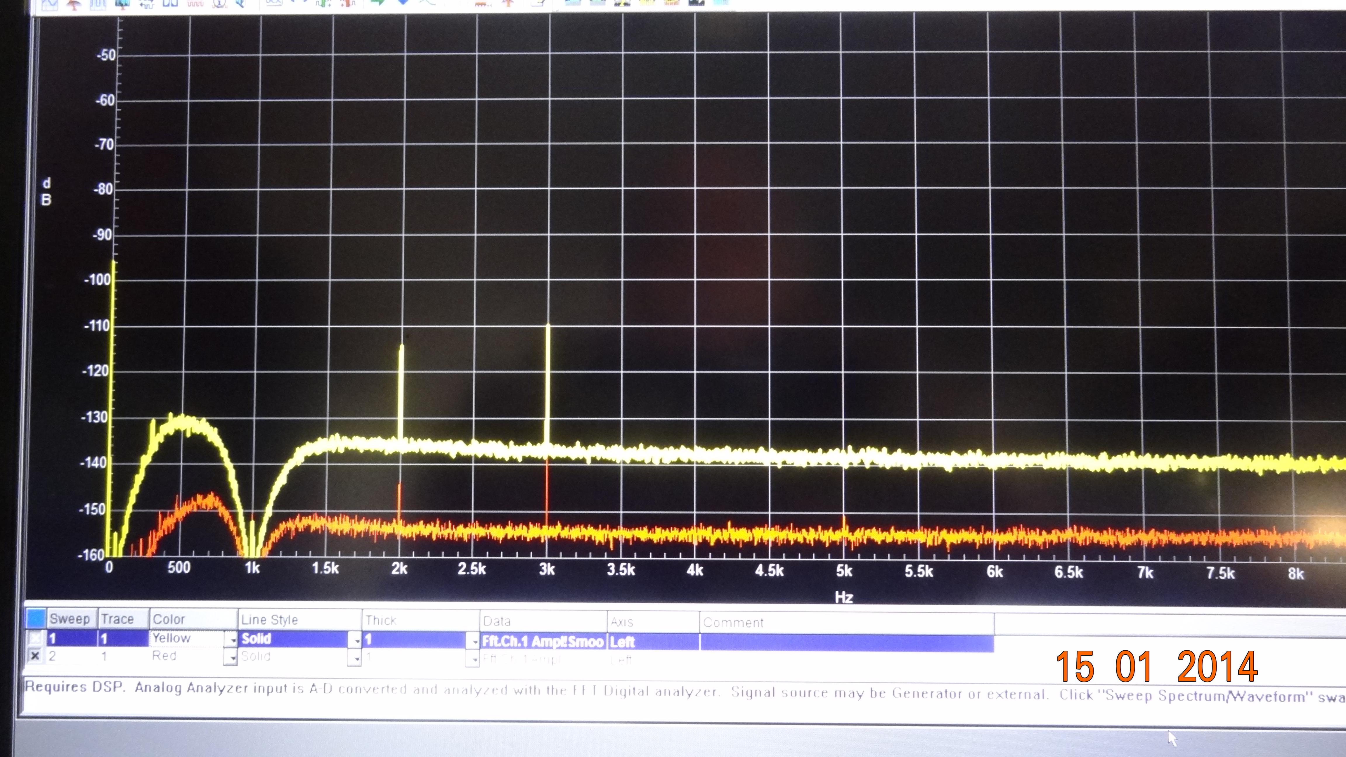

Checked that along with my group delay- AOK ! (8uS !)
(below 1) is the "famous , controversial" feedback amp (VSSA / whatever) ...
OS
