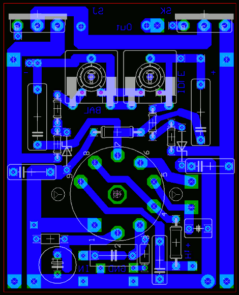

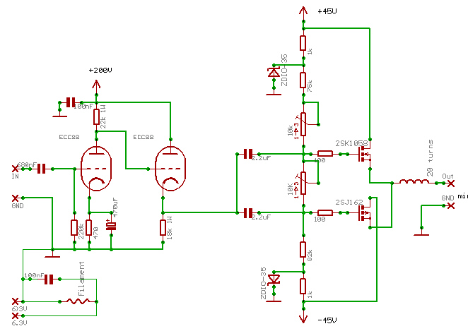

I have a couple of PCB-s for a simple hybrid ECC88/MosFet amp, if you are interested I can send it to you.
You could use it for starters , possibly the tube part, also maybe with different component values.
