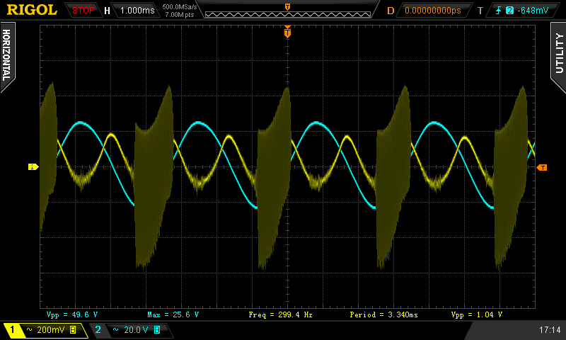

One other thing I noticed with the LT1077 in place, is the output starts to oscillate at around 250mA (350mA with a 0.5ohm current sensing resistor). I know the breadboard doesn't help, but I think it could be more stable. I'm trying to track where the oscillations are coming from, sbut no luck so far. Just a heads up.

The approximate frequency of oscillation could give valuable clues: if it highish, MHz or more, it likely to be caused by the wiring, especially the gate and source of the MOS. If it is lower, tens of KHz or thereabout, it would rather be caused by closed loop stability problems. In this case, you can try to overcompensate the opamp, use 1nF instead of 220pF, and short the series resistor.

A gate stopper did little to no good. Started with a 220ohm without result. A 1k stopper even made the whole thing oscillate like crazy! The frequency of the oscillations were around 66k, so like Elvee advised, the feedback loop was next. I now have a 1n ceramic cap without the series resistor in place and all is well. I can get it to an average of 525mA (as high as it needs to go) without any problems. I now can experiment to determine optimum values. I'll also have another look at R6 as Ketje suggested.

Anyway, a frequency of 66KHz is typical of a global loop stability problem.

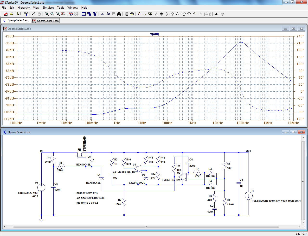

I did some simulations with the IRFBC40 (found a proper model). It shows a high spot at 137kHz of -13.8dB. Way higher than the STP8NM60. I recon it's due to the higher capacitance. This could be an issue for a bigger poweramp I have in my mind. MOSFETs with higher power ratings and voltage handling tend to have higher capacitances. Ive seen up to 3100pF. It's still not really clear to me how to properly compensate a loop like this one.
I can alter the values in the opamp's feedback loop to 1k ohm and 1nF, getting the high spot down to -20dB, but it doesn't seem right, as you pointed out it's overcompensating.
The characteristics of the MOS can be designed in an adapted circuit, without watering down of any performance.
When you overcompensate, you buy yourself tranquility, but at the expense of performance.
Of course, that is always better than an oscillating supply, but ideally it should be stable without any downgrading. And it has to be possible

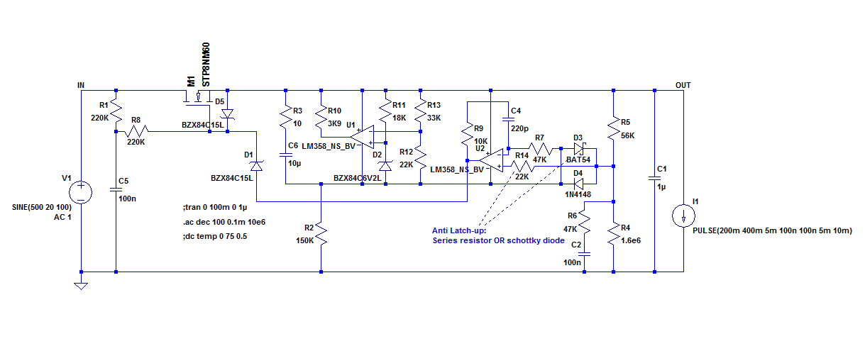

I then tried to induce a latch-up and bingo! Instead of starting normally the input voltage, I first started the input supply with the regulator disconnected, and then only I made the connection. This results in the input voltage going from 0 to 500V in a µs or so, and it did trigger the latch-up.
After inspection, I thought the most likely cause was the voltage divider pulling too much current from the + output, and stealing the tail current from the PNP input causing a phase reversal.
I tested the theory by replacing the protection 1N4148 by BAT85, and the latch-up was gone.
I also tried an alternative solution, inserting a 22K resistor directly in the + input after the 1N4148's, and it also worked
I sim'ed the circuit and found that the BAT85 or any other schottky will throw of the temperature compensation, so the 22K resistor looks like the better variant.
