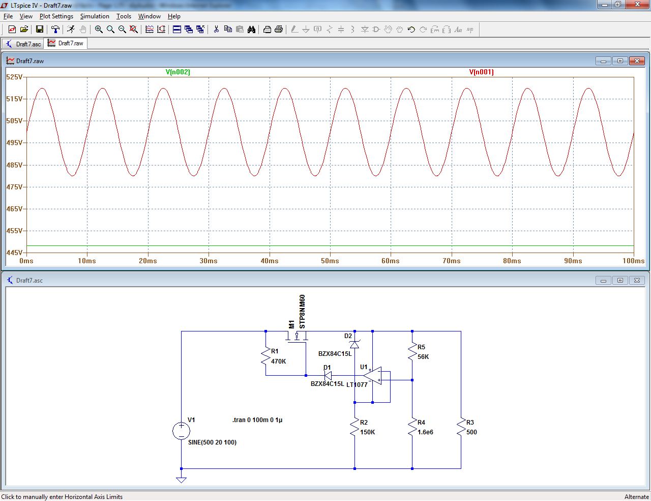

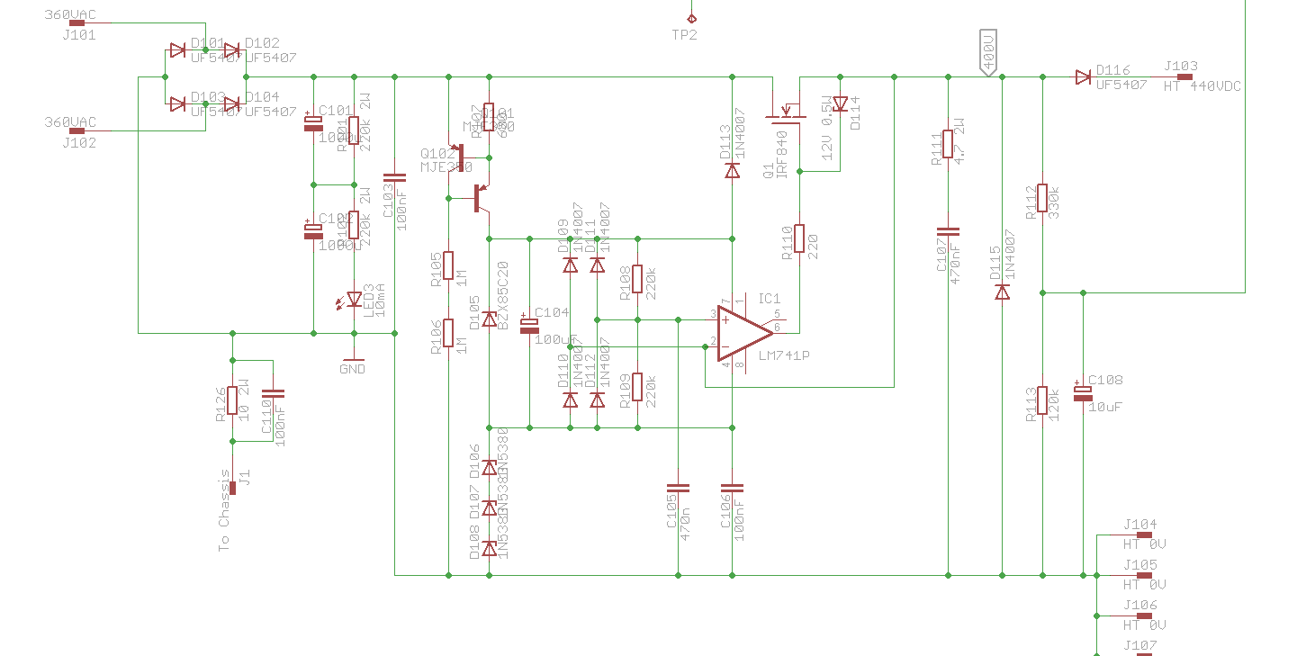

Thanks for the responses. The schematic below might shed some light as to why I want such a high reference. I'm still pretty new to these kind of PSU's so it;s all a learning experience. The only way I know of to make the error amp work at lower voltages, is take the output voltage and lower it by means of a voltage divider and bypass the upper part of the resistor network. Or are there 'better' schematics to achieve the same thing?

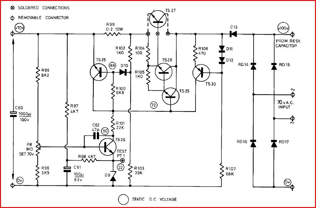

I would have thought a more conventional discrete arrangement would be simpler. The error amp is ground referenced and uses a low voltage zener as a reference. Floating a 741 like that looks a recipe for problems tbh, its so easy to kill the IC with transients etc.
This shows the basic idea. Its a common and standard topology thats easily scaleable and tweakable.

Thanks, I'll look into the schematic. As far as the 741 is concerned, the opamp's powerrails are held at a 20V differential by the zener, and the four diodes at the input prevent the inputs from ever going past the powerrails. How would it be able to get damaged?
I've worked with the original Maida circuit before in a preamp project with great results. But this puppy needs to go into my power-amp, with peaks up to 800mA + the 60mA idle current (parallel-push-pull). Both Maida configurations would exploded AFAIK, since it's not only the pass MOSFET that has to handle the current.

Would the diodes protect in all circumstances and conditions ? What if there were a glitch on the output, something pulling it down for even a few microseconds. Pin 2 of the opamp would be heading toward 0 volts and the nature of transients are that rise and fall times can be very quick indeed. What would the differential be between pin 2 and all the other pins during that instant ? Its conditions like that which cause unexplained failures. Similarly the junction capacitance of semiconductors (diodes !) can couple significant energy if a transient glitch appears. It may happen only very infrequently but if its a possible source of failure then its no good. The FET has very high junction capacitance and could be a prime suspect under adverse conditions.
The circuit just has that "look" about it. That its to fussy, could be prone to problems.

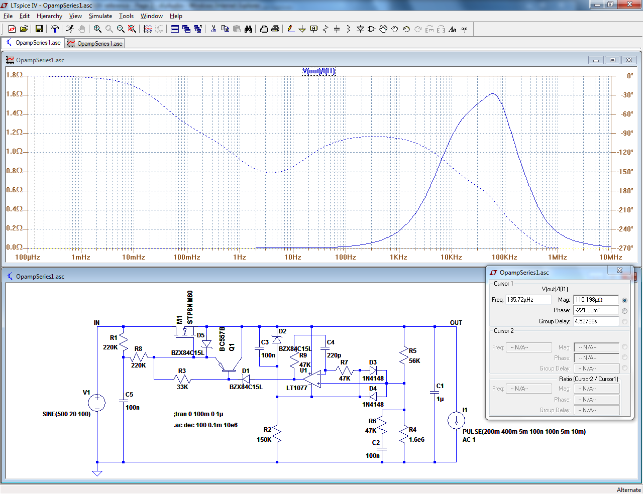

I don't quite follow. I get the part about the constant zener current, which would negate the use of a CCS, but you lost me with the opamp. Do you mean it'still floats on top of the high voltage zeners?
A picture is worth a thousand words.
Here is what I mean (it is just the plain vanilla concept, without additional filtering, protection and various bells and whistles):
Thanks a million for taking the time to sketch up the schematic! It makes things a lot more clear. I've copied it in LTSpice, but with the components I have at hand (MOSFET, opamps LM741 and TL072), I can't get it to regulate properly. I not sure what I'm doing wrong.
Edit: I just replaced the opamp with the LT1077 you're using and it works as it should. Is the opamp used this critical or is my model incomplete??

The LT1077 is a micropower opamp. For a 741 you may need to reduce R1 to allow for the higher opamp current and also reduce the divider network by perhaps a factor of 10 to allow for the higher input bias currents of a 741. The TL071 can keep the didvider network as it is.
The opamp needs to include the GND in its input common mode range (this could easily be eliminated with an additional divider).
Other than that, most opamps should work, half a LM358 for instance.
Make sure the current through R2 is higher than its supply current.

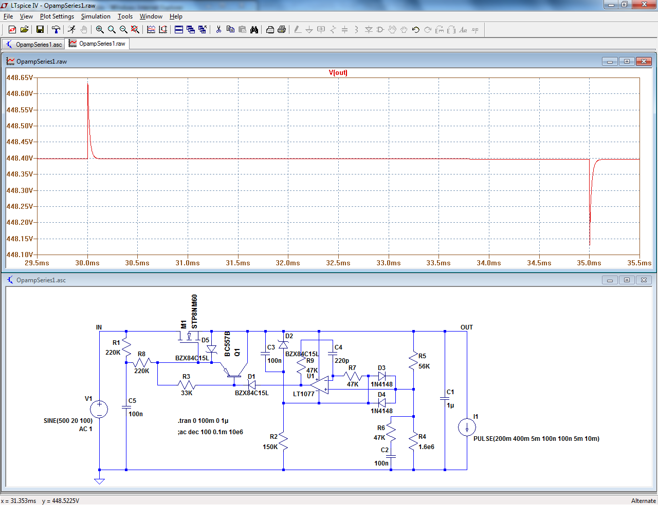

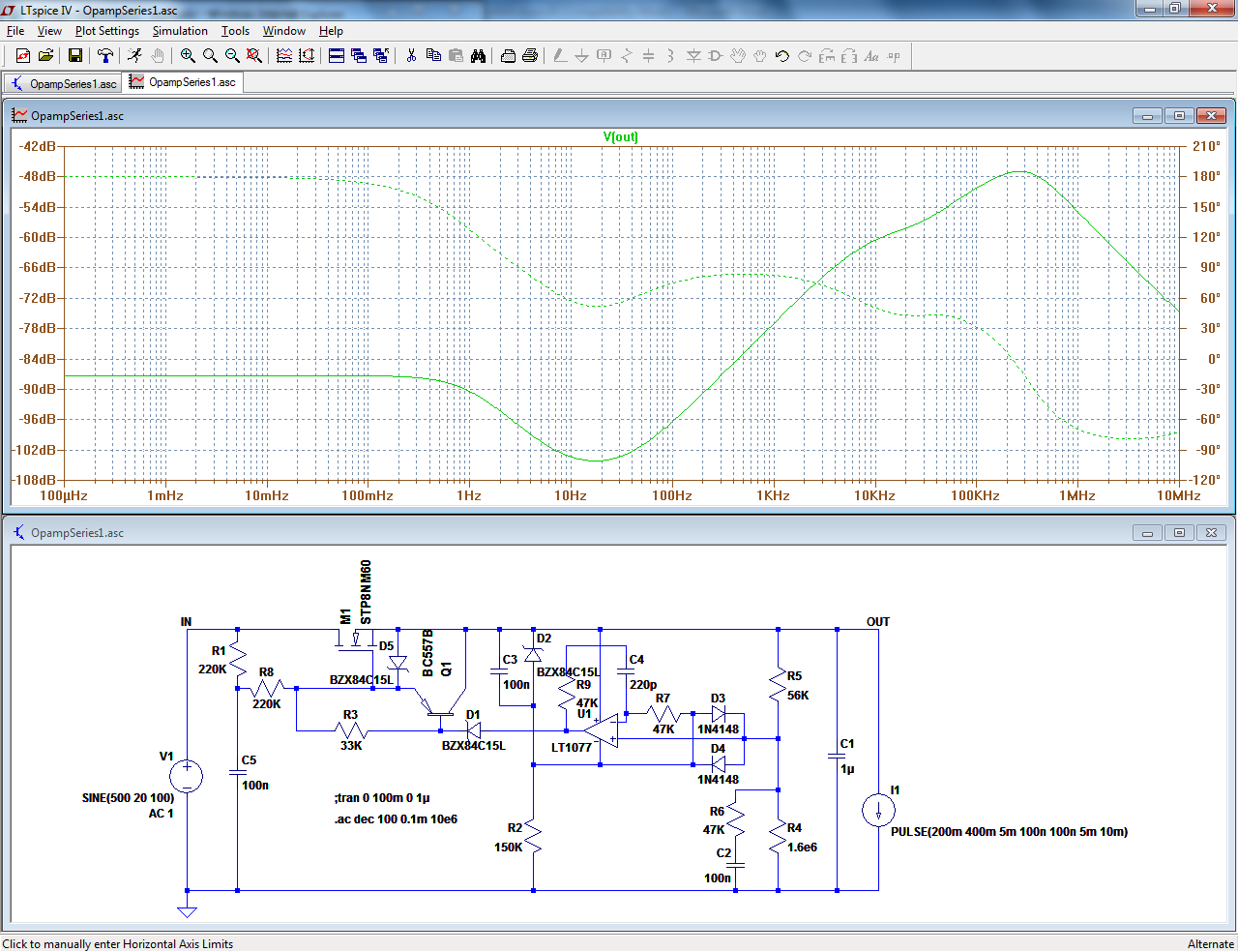

Here is a working version, dressed up with protections, bypasses and properly compensated.
The DC output resistance is ~110µΩ, and the ripple rejection is 96dB @100Hz.
None of the components are critical, and you could opt for 10V or 20V zeners without problems.
The circuit will be very robust against spikes, power-on or off conditions, load dumps, but it isn't protected against shorts (that could be added without too much difficulty)

I can't thank you guys enough!
Mooly, you're right. For some reason, my TL072 model needs way more current (including the zener operating point) to operate than is specified on the datasheet. Lowering R1 enough got it working.
Elvee... wow... awesome. Do you consider the design worthy for breadboarding?? My fingers are itching :D

The TLO72 is not supposed to work in the circuit as is, it doesn't include GND in its common-mode
I think so, find a proper opamp like the LM358, simulate it and breadboard it (carefully, this HV)

No, Q1 serves to improve the ripple rejection.

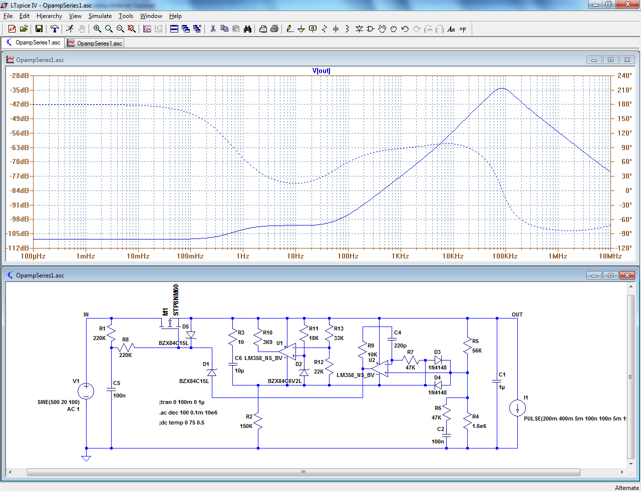

If you choose a dual opamp like the LM358, you can use the unused half as a self regulator (one more layer of incestry!).
Since it is much more perfect than a plain zener, you can now dispense with the transistor and get a better line regulation, -107dB in this case. The ripple rejection remains the same at -96dB, because it caused by the MOS capacitances leaking the ripple directly into the output.
It also gives more freedom in the choice of the zener, because the internal supply is now set by a resistors ratio.
You could use a temperature-compensated one, or a bandgap reference.

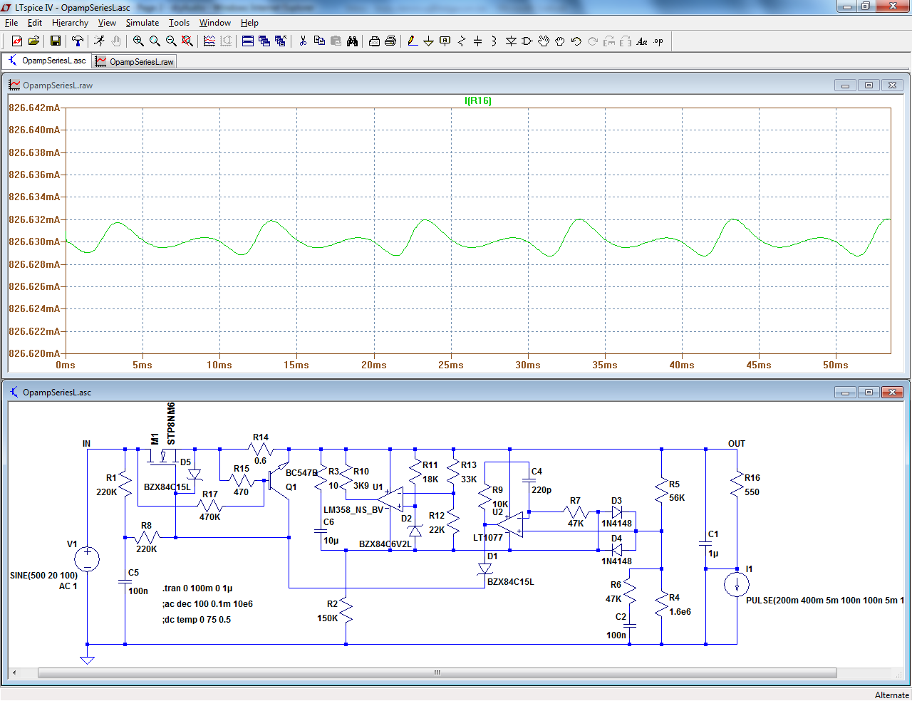

With a single supplementary transistor, it is possible to implement a current limit (here 800mA), SOA protection and thermal overload combo (the transistor has to be in contact with the heatsink).
At low temperatures, it will keep the dissipation in the MOS <150W, decreasing at higher temperatures.
