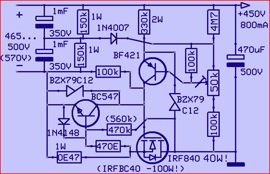

Hi
If i can say, don't use OP in floating... this is a nightmare.
Why ? you're never sure of voltages, and you cannot tune and test with scope...
What do you want ? kill the noise
i propose you this one :
What is important :
- You don't set the output voltage precisely, but you kill the noise, that's all that matters in tube amp
- there is a small filter in the feedback to prevent oscillating,
- the op amps are referenced to the ground, and D17 protects against overvoltage, D8 and D7 too.
- the op amp acts through the grid of IGBT thanks to C5 and C7, any change to out of OP is applied to the gird !
- measure of output voltage is like the same, thanks to D16 and D15 (across R17 and R18 is 400 - (200+150) = 50 -> you tunes the U3.3 to +5V (reference voltage)
- don't forget D11, if there is internal diode or not, it's better to protect from output capacitor still charged.
- current limit qith Q1 and R8
This one worked very well on my amp.

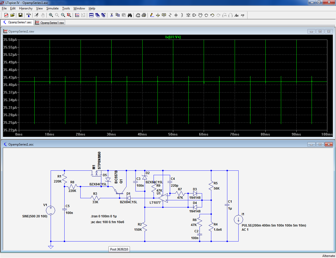

An alternative discrete option is the simple series reg: http://www.diyaudio.com/forums/power-supplies/198986-simple-hv-series-regulators.html
It is tested and proven, requires no voltage translation or auxiliary supplies and has decent enough performances.
I do not see how it can work- current limit qith Q1 and R8.
+1I do not see how it can work
And I don't see the use of Q1 in your last post
D1 somewhat lower voltage perhaps ?
Mona
No, Q1 serves to improve the ripple rejection.
D1 allows the gate voltage to go more positive than its source, which is necessary for enhancement MOSD1 somewhat lower voltage perhaps ?

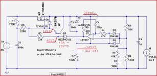

OK,where do I see a problem.Elvee said:D1 allows the gate voltage to go more positive than its source, which is necessary for enhancement MOS
A drawing shows it better
With a bit of bad luck the MOSFET continues to conduct when not desired.The voltages assume that the output of the opamp goes all the way down.If it doen't it is even more than 1V1 at the gate
Without Q1 you gain 0V6.
Thats why I suggested a somewhat lower voltage for D2,especialy with Q1 in the circuit.

note : Q1 is a NPN and not a PNP ! (wrong schematic version)
Min guaranteed threshold voltage for the STP8NM60 is 3V. That is a ~300% margin.If it doen't it is even more than 1V1 at the gate
If you're still unhappy (or ) with it, or keen on nitpicking, you can opt for a 13, 12 or even 10V zener, you are free to do so, it will not change anything to the operation of the circuit
The datasheet has the answer: at temperatures >150°C, the Vgs correction ratio is ~0.7.What to expect with Vds of 50V or more and perhaps 120°C ?
This is still 200% margin, supposing the BC557 remains at 27°C. Anyway, a 10V zener can do no harm (or good in this case, except reassure anxious minds which is certainly worthwhile after all)
