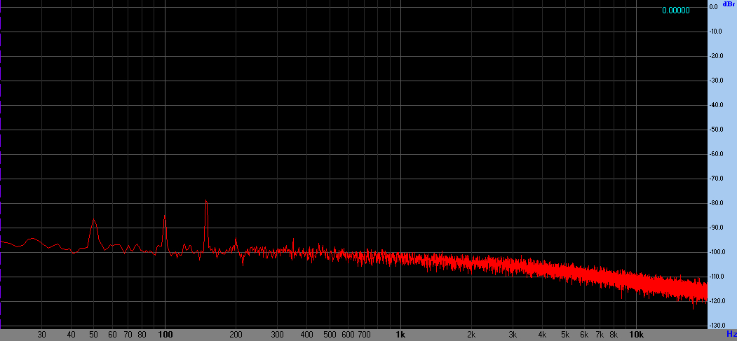

Lower (300B heater, measuring on 10R).The Coleman regulator gives microampere-level ripple, or even lower...
