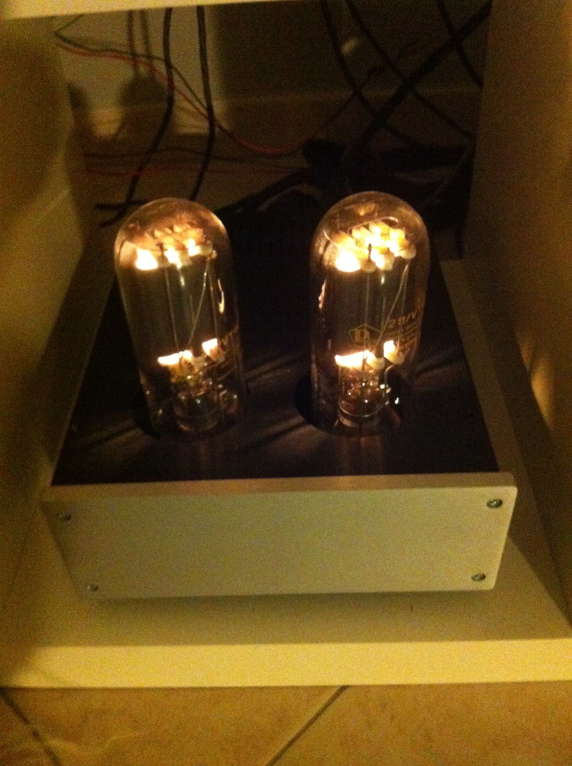

For your reference, in my 211 line driver (hey! that's water babies ... Rod, good memory!) I use the small side panels of galaxy cabinet by hifi2000 as heatsinks: one Coleman's module per side. It has been running for ... well, I guess 3 years now? more than that?
In my 801A amp, Coleman's CCS' are attached to a thin metal cover that is supporting also tubes, no problem there too.
It is sometime tricky to set precisely the voltage across the filament as it tends to change a bit over time as heatsink gets warmer but it takes only half an hour of patience and that is it!
I never tried DC heated push pull. I have a VT52 differential amp running on AC and apparently there is no need for DC. A friend of mine is using Coleman's on his AD1 PP amp and it was astonishing. Both amps, mine and his, sound really great so I did not mature a definitive idea about AC and DC on push pulls but in SE amps it is a no way back. Old schematics using bridge+Cap or even bridge+Cap+3 pin current regulators are miles away from being perfect.
