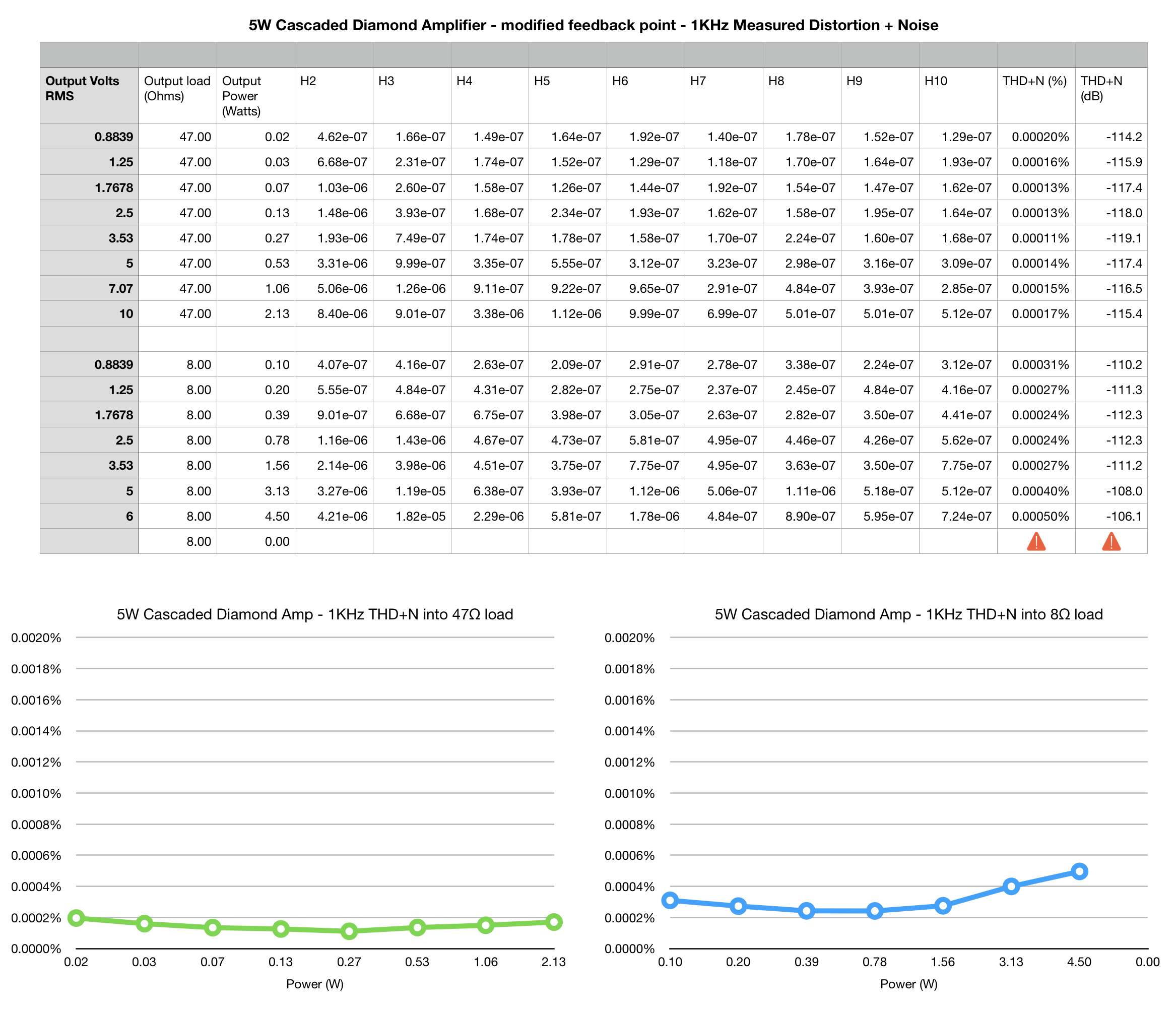

Found the culprit.
<Happy Dance>. :D
It's a rookie mistake on the feedback network layout. Rather than sampling at the point where the load connects to the PCB, I'm sampling at the other end of the trace, simply because it's nearest the amp input. So of course the amp has gobs of even order harmonic distortion as the load current goes up - the PCB traces are messing with the feedback ratio.
I've corrected the prototype PCB by cutting the link between the feedback resistor and the pour for output, and inserting a length of wire wrap wire to connect the feedback resistor directly to the output pin.
Distortion levels into 8Ω are much improved - I get a minimum of 2.4ppm at 2.5V (0.78W). I'm running into clipping a little earlier than I was previously - I think I might have been mucking around reducing output stage quiescent currents on this amp, so I can probably improve on the 2.4ppm number. See attached plot.
Good catch, Suzy. :cheers:

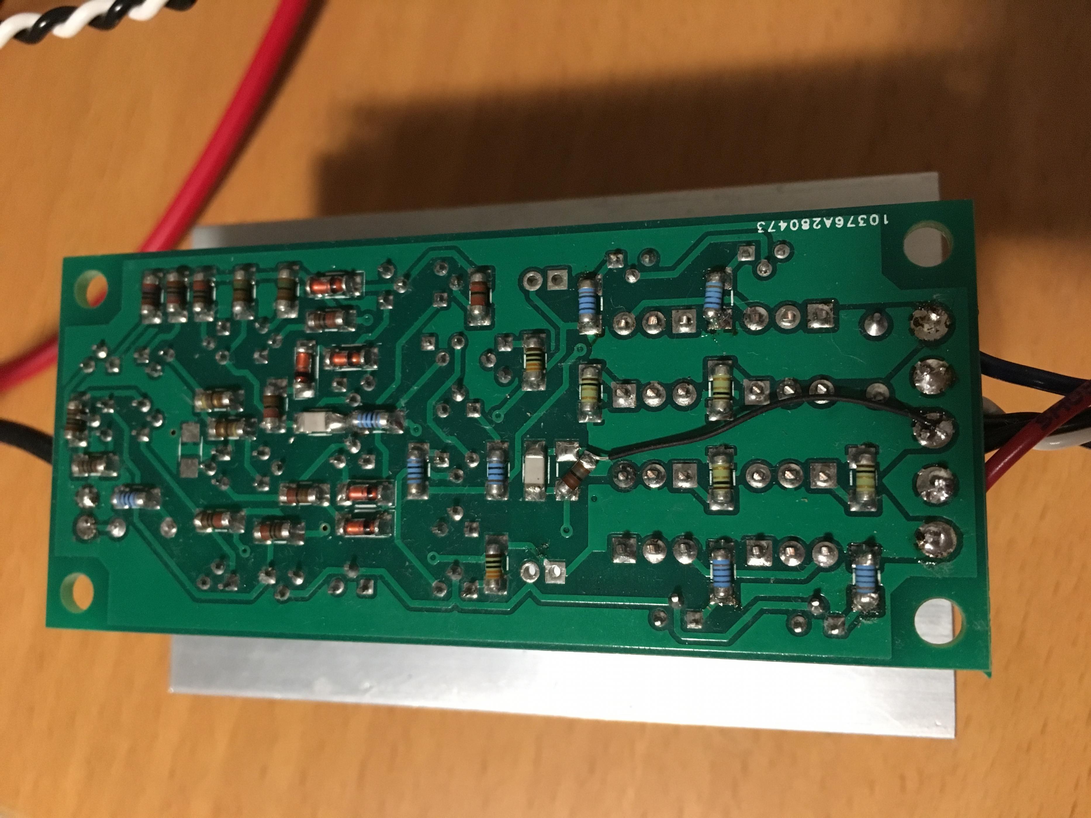

Can you please show photo of the "white wire" mod?
Btw, I still have not been able to find a BOM, is it part of the design files above but in some proprietary format? About to place an order with Mouser so thought I should throw all these bits in.
Thanks,
X
Done, though I've used a black wire. Also shown is the dodgy glob of solder needed where I forgot to connect a couple of pads.
