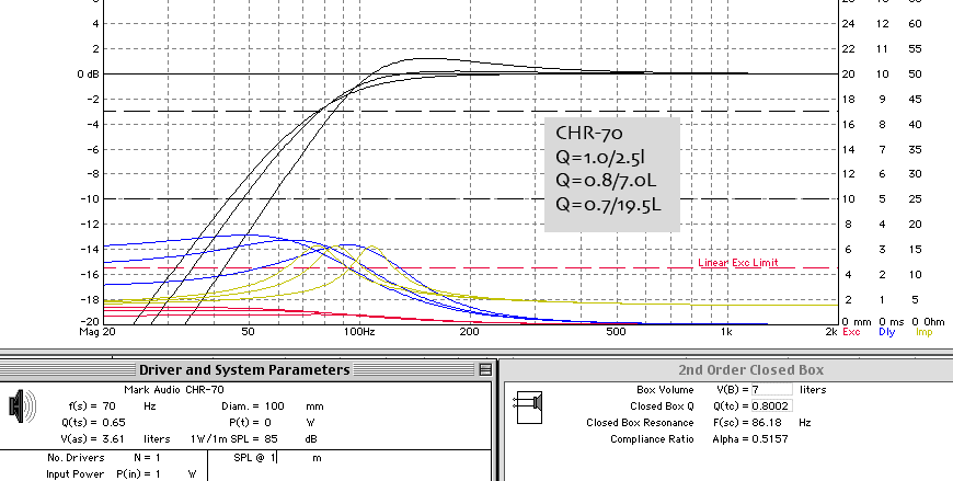

I wouldn't discount the CHR-70. I've been promised a comparison review of JX92 vrs CHR70eN soon (Nanook?)

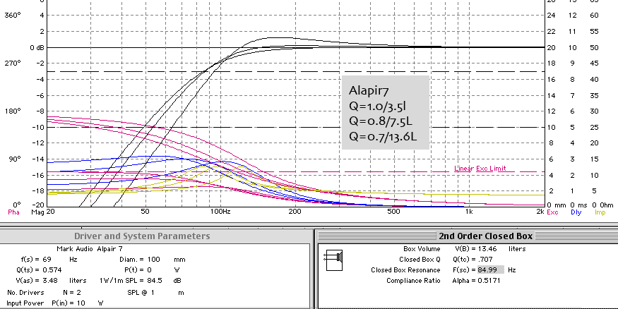

Hi Dave,
Using the driver specifications, one can calculate excursion-limited power-handling and attendant SPL levels for a given frequency. For the Alpair 7, I am getting 80Hz power handling of about 5w and max SPL of about 91dB, which is a little lower than I was hoping for. The Jordan gets to about 96dB.

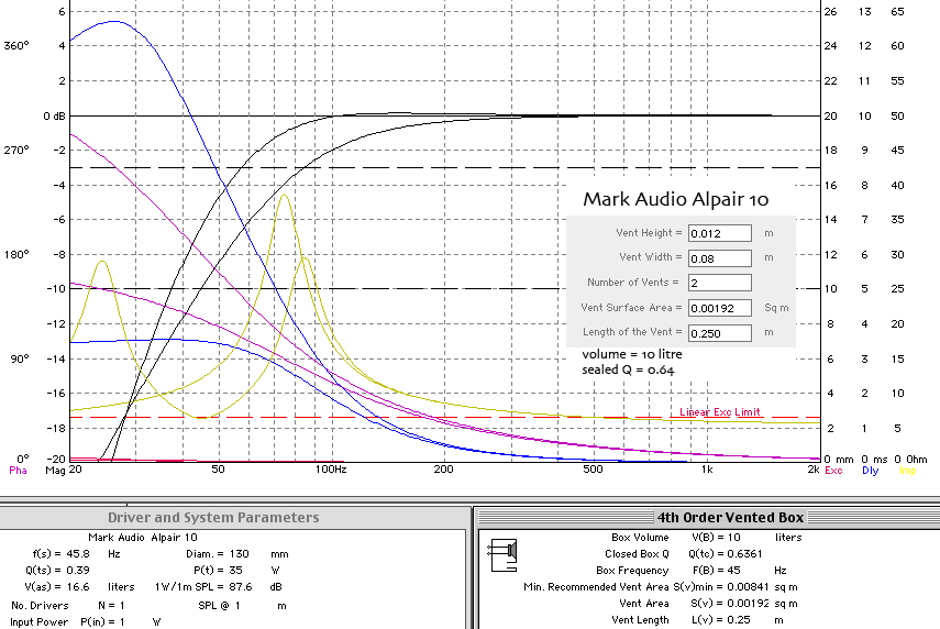

What I am looking for is small sealed or vented enclosure (<10 litres/0.35 cubic feet). I guess it not as small as OP is looking for, so sorry for the hijack again I went through MarkAudios website and several others too, but I found nothing that small for Alpair10FR drivers. I have been looking for software to model small enclosures for full range drivers but I'm having trouble finding one.
Any ideas or advices? I would be very thankful for help, as I said I'm eager to start cutting some MDF if I only could figure out the shape I am after
10 litres = too small for a practical vented box; 10 litre sealed should give a Qtc around 0.58. If you can handle the extra four litres (worth it): http://homepage.mac.com/tlinespeakers/FAL/downloads/MarKen10-1v0-map-181209.pdf
There is a primeSize miniOnken for the A10 -- nominal 13 litres.

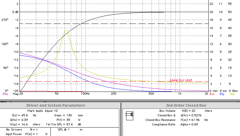

Here is 1st pass at 10 litres.
edit: Scott was posting at the same time... on 1st blush i would have said the same thing Scott said about vented... but what we have here would be the basis of a dMar-Ken10 (deciSize miniOnken)

I found one sealed cabinet design for Alpair 10
The plans lack a material thickness. But sealed, up that large, it probably makes little difference if you used 15mm or 20mm.
~20 litres, Q ~ 0.52
