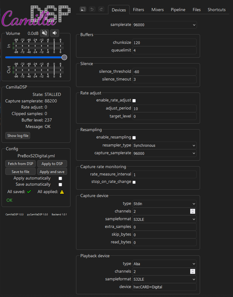

Did a fresh pCP install and ran the script. All appears to work fine except when pausing the player I see a lot of warning messages in the log window repeating every second. The CamillaDSP GUI State is alternating between STALLED and PAUSED a couple of times per second while the Capture Sample Rate shows 88200.
I tried several Device settings but could not resolve this issue. Anyone has any clue?
Code:
2023-10-15 07:47:18.552910 WARN  [src/filedevice.rs:446] sample rate change detected, last rate was 85819.7930616801 Hz
2023-10-15 07:47:19.559236 WARN  [src/filedevice.rs:446] sample rate change detected, last rate was 85857.06379681268 Hz
2023-10-15 07:47:20.565813 WARN  [src/filedevice.rs:446] sample rate change detected, last rate was 85841.47245944264 Hz
2023-10-15 07:47:21.571144 WARN  [src/filedevice.rs:446] sample rate change detected, last rate was 85938.50866159408 Hz
2023-10-15 07:47:22.575820 WARN  [src/filedevice.rs:446] sample rate change detected, last rate was 85995.66746262889 Hz
2023-10-15 07:47:23.580165 WARN  [src/filedevice.rs:446] sample rate change detected, last rate was 86030.65928174842 Hz
2023-10-15 07:47:24.585572 WARN  [src/filedevice.rs:446] sample rate change detected, last rate was 85931.2671936568 Hz
2023-10-15 07:47:25.590182 WARN  [src/filedevice.rs:446] sample rate change detected, last rate was 86003.37479631683 Hz
2023-10-15 07:47:26.594888 WARN  [src/filedevice.rs:446] sample rate change detected, last rate was 85995.74680762364 Hz
2023-10-15 07:47:27.599129 WARN  [src/filedevice.rs:446] sample rate change detected, last rate was 86034.61743236108 Hz
2023-10-15 07:47:28.604029 WARN  [src/filedevice.rs:446] sample rate change detected, last rate was 85985.29926455919 Hz
2023-10-15 07:47:29.610077 WARN  [src/filedevice.rs:446] sample rate change detected, last rate was 85880.61004424587 Hz
2023-10-15 07:47:30.614898 WARN  [src/filedevice.rs:446] sample rate change detected, last rate was 85979.67246491584 Hz
2023-10-15 07:47:31.620193 WARN  [src/filedevice.rs:446] sample rate change detected, last rate was 85944.72697452657 Hz
2023-10-15 07:47:32.624248 WARN  [src/filedevice.rs:446] sample rate change detected, last rate was 86051.53602589387 Hz
2023-10-15 07:47:33.628475 WARN  [src/filedevice.rs:446] sample rate change detected, last rate was 86036.13408891621 Hz
2023-10-15 07:47:34.633441 WARN  [src/filedevice.rs:446] sample rate change detected, last rate was 85973.62977422985 Hz
2023-10-15 07:47:35.638267 WARN  [src/filedevice.rs:446] sample rate change detected, last rate was 85985.22798265163 Hz
2023-10-15 07:47:36.642252 WARN  [src/filedevice.rs:446] sample rate change detected, last rate was 86056.91183224061 Hz
2023-10-15 07:47:37.646592 WARN  [src/filedevice.rs:446] sample rate change detected, last rate was 86026.97276561083 Hz
2023-10-15 07:47:38.650442 WARN  [src/filedevice.rs:446] sample rate change detected, last rate was 86068.67862164597 Hz
2023-10-15 07:47:39.654917 WARN  [src/filedevice.rs:446] sample rate change detected, last rate was 86014.64963881239 Hz
Solved it by using the squeezelite -C option with a positive value i.e. 5. This will close the output after 5 seconds and the CamillaDSP State will go to Offline.
