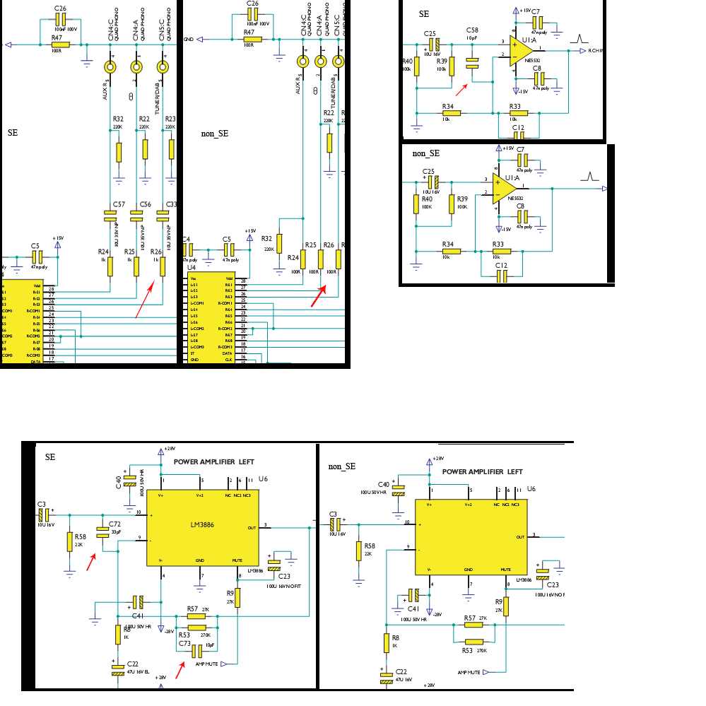

Valleyman, I found this pic (and then modified a little) in internet

If you have enough you could use them for bypassing the PS caps next to the 3886 chip and around the +/- 15v regs on the opamp supply. They also might be good for bypassing the signal path DC blocking caps. You could also try the 'snubber' using those caps if they are 50v or above?

Also thinking about adding little Epcos like it's made in SE version
Where?
100Vdc 68nF (B32529-C1683-K)
63Vdc 0,1 uF (B32529-C 104-K)
I posted one pic some time ago, but noone comment that...Please explain?
