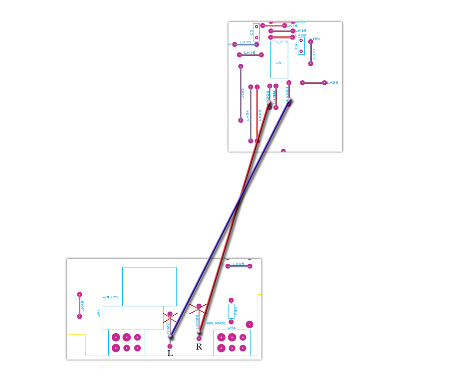

Just getting back to post 508.
I seem to recall complaining at first (after the mods) about the bass being weaker that when the player was stock. After a few days burn in and some proper listening I noticed that what had actually happed is the player was now producing better defined bass. It wanst that there was lees, it was just not so obvious because it blended in to the music properly and sounded natural.
Hi Mike.
1. I noticed, that 340A has "lightweight" bass too. I compared 340A and HArman AVR347 and harman has more powerful bass. Speakers was MA Silver RS6.
AI also read one review\test of low-cost amps (300-500$) and author noticed that too.
2. Two days ago i received post-report I think it's your caps. It has some mistakes in surname, but i think it's not serious problem. Tomorrow I'll got'em.
P.s. I listened my amp more carefully with headphones and.. it has noticeable buzzing at high volume. But it's noticeable only with HP and when music is stopped.
I think You will better start new DIY LM Amplifier project. 340A is a good amp, it has very good case, good build-quality, good remote control, and good sound at all.
But it has a lot of "features", which makes tweaking not so effective...
