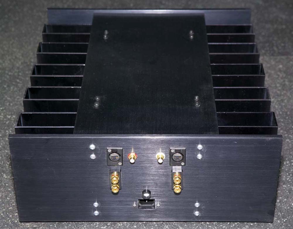

I also have one of the amp chassis (#28) ... Sorry, I misunderstood and assumed you were using a completely new design = "look and feel".
Are we going to be able to buy the chassis separately? Its a great idea / concept = straight forward and completely adjustable, very versatile ... good looking too! =
I was just looking over my BA chassis, and realized that it has IRF240s on one side with 1.0R source resistors and IRF244s on the other side with 1.8R source resistors. Probably not a huge deal, but if anyone else took home a similarly equipped chassis I would be interested in trading one side. I would prefer both sides of my amp to be identical.
Aw, we was jist funnin' you
PSz. said:I was just looking over my BA chassis, and realized that it has IRF240s on one side with 1.0R source resistors and IRF244s on the other side with 1.8R source resistors. Probably not a huge deal, but if anyone else took home a similarly equipped chassis I would be interested in trading one side. I would prefer both sides of my amp to be identical.
If you can't find a swap, then put the 244's on top (ot bottom) of both
sides, that way you'll have the symmetry that allows audiophiles to
sleep at night.
From a performance standpoint, they are identical, but the 240's have
fatter pins.
If you are building BA1 you will want to keep the 1 ohm and dump the
1.8 ohm resistors.
Thanks for the reply Nelson. I am actually one of those with complementary output stages awaiting "a similar but different design." So swapping the devices around wont help, but if the performance is identical then I will try not to fret about it.
I do have serious symmetry issues.
I will definitely be checking all the existing parts values when I build this beast up. Still trying to decide what would be the best amp to build for my speakers. A big transconductance amp is what the big JBL woofers seem to be asking for.
