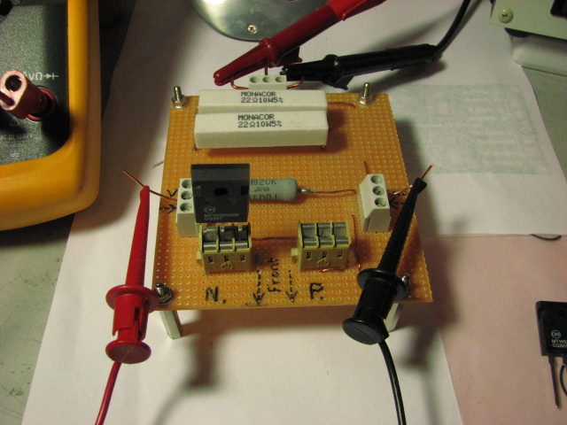

And we haven't matched our MOSFETs yet! I think that at this point we are looking for someone who has some experience doing it and we will be willing to go where that person is, OR where the equipment is that the person needs.
If no one has the knowlege, then someone needs to try following Nelson's directions and get confident in doing matching as we have a lot of 'em to do!
I'm pretty booked up with diyAudio stuff ATM and can't put in the time to learn. Anyone have the time and equipment , or even better - knowlege?
Mark
To do mass matching that actually works, I have found it useful to make a big clamp of say 1" by 2" aluminum bars, with a bolt per 10" to clamp the mosfets. From there it's simple, just follow the matching pdf Nelson has written. The circuit is simple to breadboard.
Get a respectable meter, Fluke 187 comes to mind. 3 alligator clips, and some nice soft wire in 3 different colours.
Then it's just a matter of writing a number on all the mosfets, and make a list where you write down the measured results.
Last you can put all the numbers in a spreadsheet, and easily look through the whole shebang, to find the matching fets.
Magura :)

Matching
I run the 15volts across 55 ohms using 5 3 watt resistors, using Papa's older article as a guide. The voltage doesn't change if I leave it there for a few seconds, and it's doesn't get too hot.
I just leave it oon a piece of wood.
I am not sure if there is a better method to do it.
I certainly have a few HP power supplies to work with.
Re: Matching
One important point is to match the transistors at the a current close what they will be exposed to in terms of bias in the finished amp. If the transistors don't get hot, you are not doing it correctly. ;)
I'm using steenoe recipe: Calculate R so that you get ~1amp - put in the device, start the clock when you reach 20sec press "hold" on your DMM - now write the number on the chip and go on. It is crucial to be exact with the timing since the device will wander several millivolts each second.
It is also a good idea to warm up the rig with other devices that you are not going to match.
Sockets are very convenient for matching, indeed. Here is a pic of a simple, matching rig with sockets. I made it to accomodate both P-channel and N-channel TO247 devices, along with To220's. Just to make it more flexible in use. For simple VGS testing this will do fine, if done as cviller outlined above. The mosfet on the pic is being measured at 15v 0.5A, as needed for this occasion. Just trim the resistor value, as needed. I use 2 pcs 10 watt resistors in // for testing at 1A. The most important part, after the rig has reached a stable temp, is to go along at a steady pace, so every FET is measured the excact same way.
I dont turn the power off the supply, between FET's, and never had an accident on that account, yet.
The schematic is in the Zen variations, part 3. Active supply regulation.

A closer shot of the test board. It has 2 voltage input's 1 going to the 10 watters, the other to a 5 watter, used for the To220 devices, which are matched at a lot lower current.
I have found it a really handy little gadget, making matching life a lot easier.
