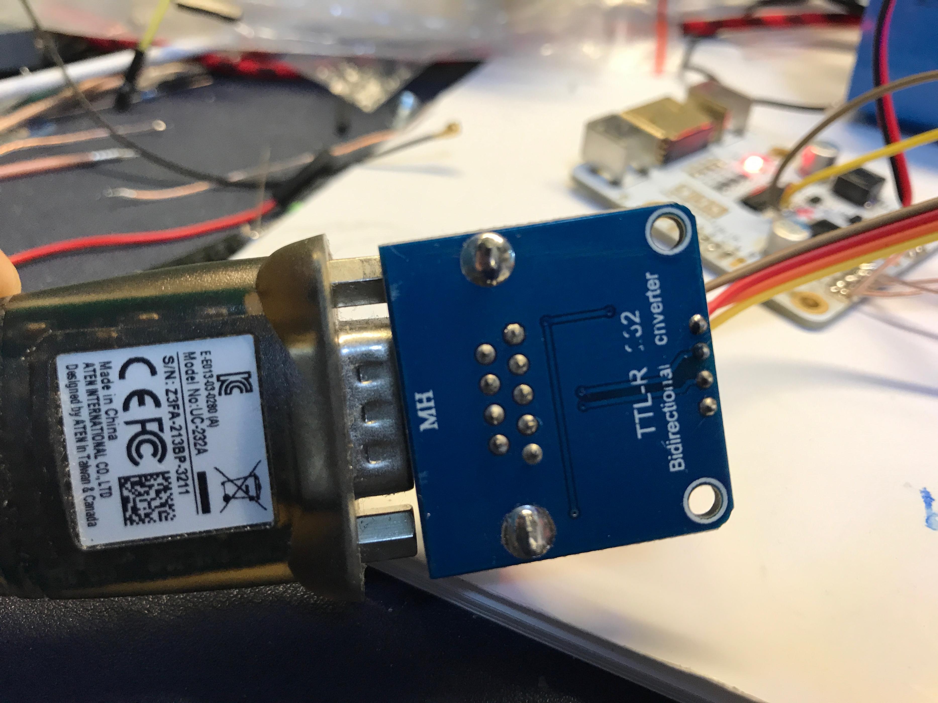

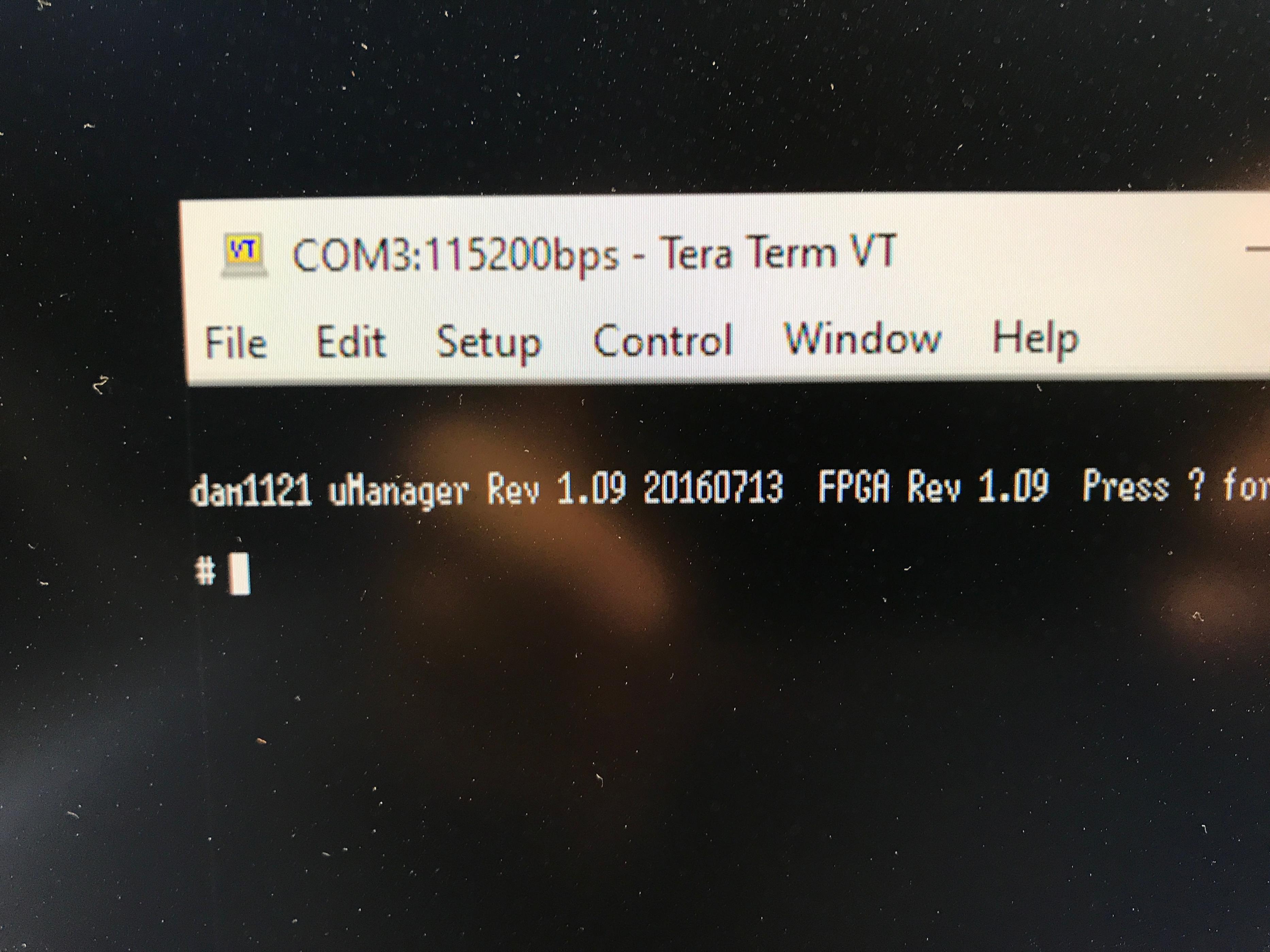

You can't connect 3.3V directly to a standard PC RS232 serial port. I guess that's what you're doing, am I correct? (taken from the "pin 5" statement. It fits with a sub-d 9 pin).
You need a TTL level serial port. Just make a search for "USB to TTL Serial Port PL2303".
ok now.
It is TTL, need TTL to RS232 converter for my case (RS232 to USB)
Speed has to be adjusted to 115.2k
