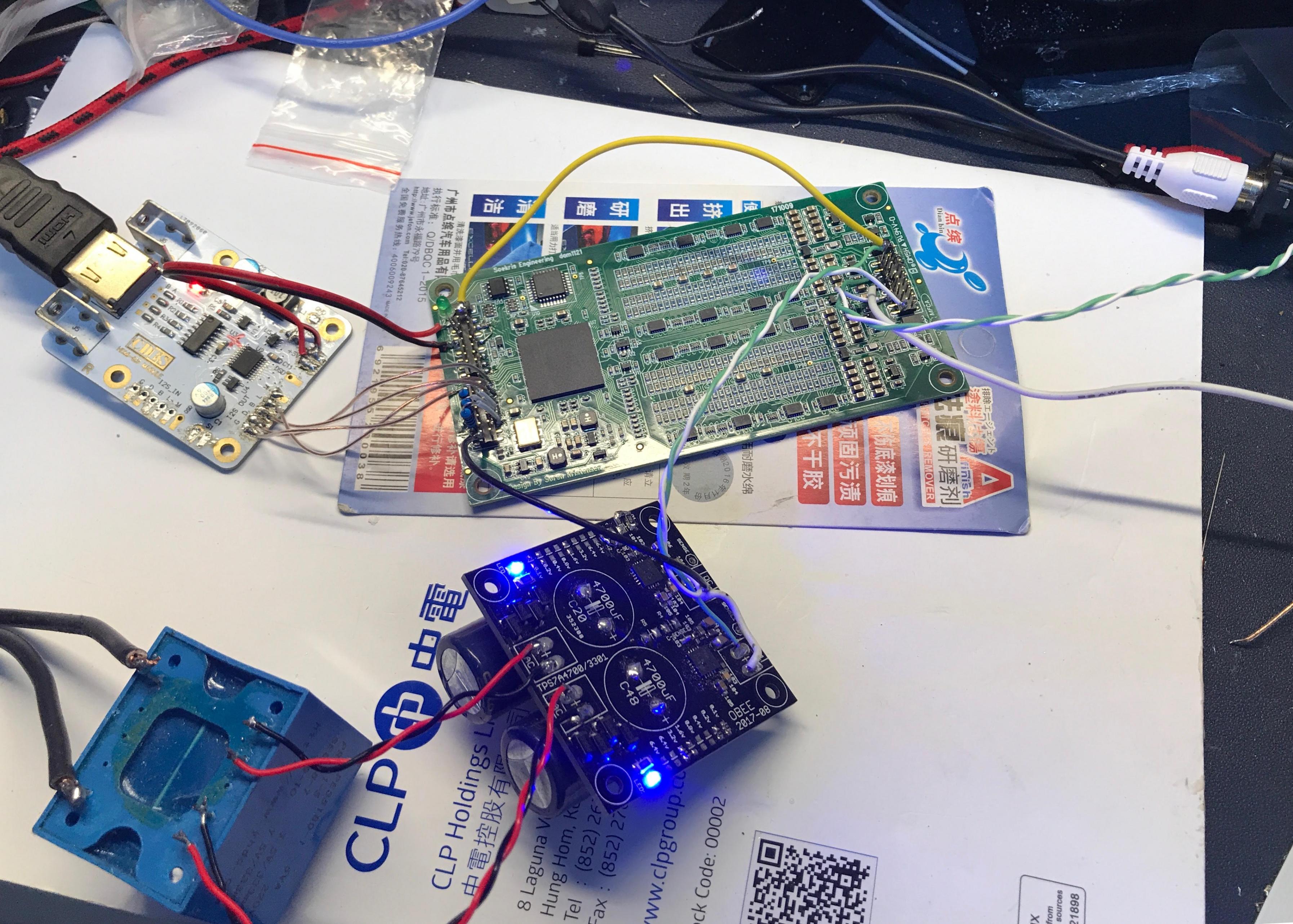

I bought dam1121 few months ago but I could not make it sound. May I know how to make it sound?

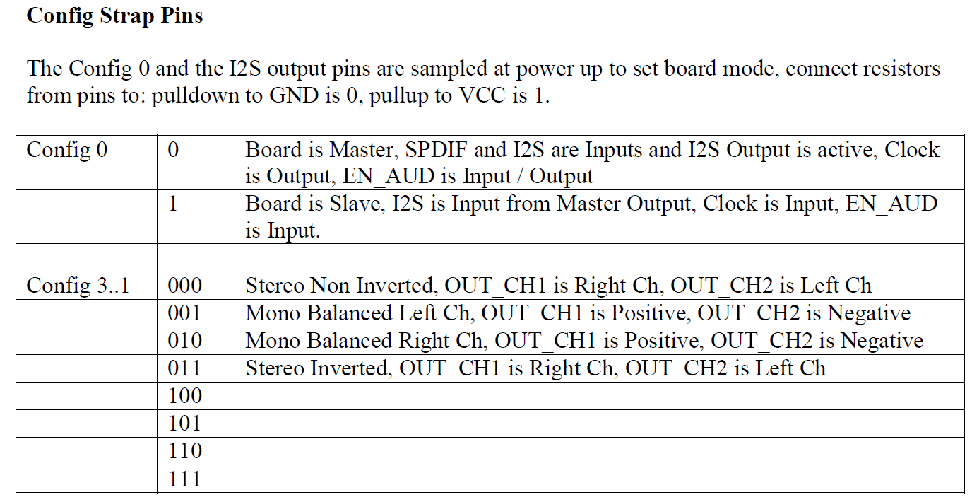

I think you need to read the 1121 manual, specifically regarding config strap pins, which you don't appear to have considered. The relevant config pins need to be connected to ground via resistors (3K3 IIRC). My little interface board holds them in my setup.
You power supply connections look OK
Maybe the attached picture will help?

Thanks bro!
I just realize that!
So just connect the resistors from strap pins to ground pin to tell it is "0"?

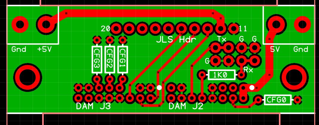

I guess it should be noted that the upper end of CFG1-3 resistors are connected to GND ... this is not visible in the PCB drawing.
Just to avoid confusion for the people struggling what to do.
