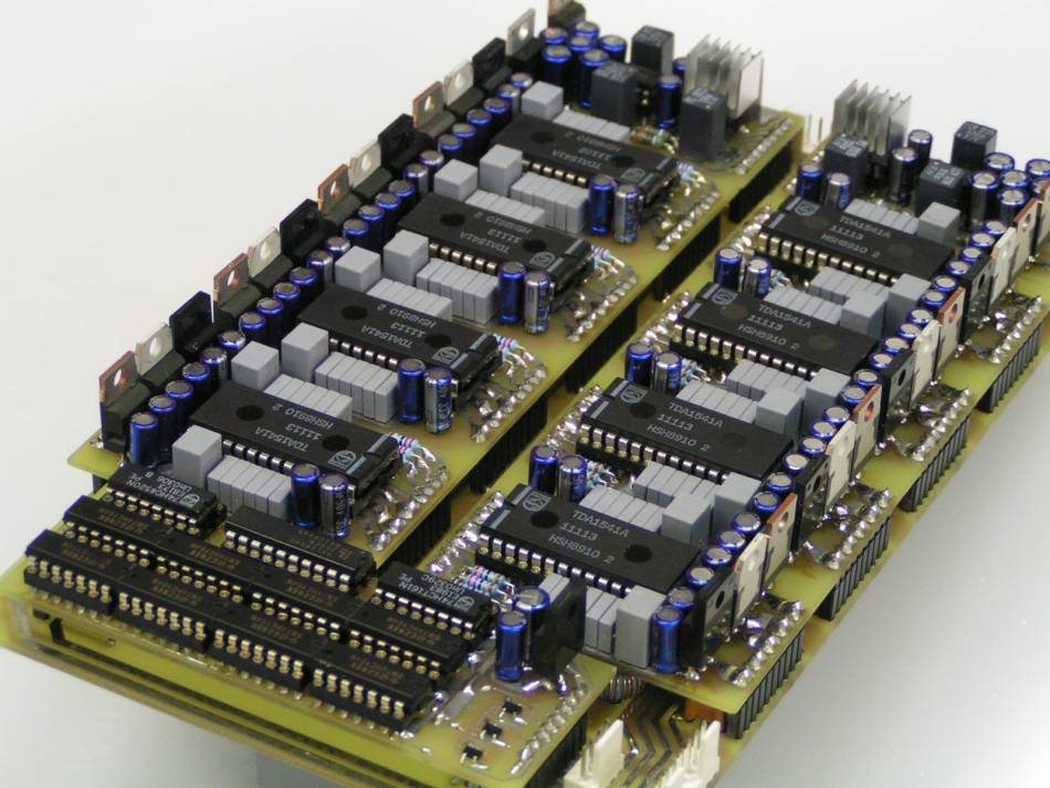

New octal D-I DAC core completed
Hi tubee,
Thanks for your reply [post #1060]
Would this octal D-I DAC core fit your CDP? have a look at the attached picture. Yes, the new octal D-I DAC core is ready, it measures 21.9 X 13.4 X 3.5 cm.
The DEM sync clock and UHS buffers are now integrated in the new timing-chain module, greatly simplifying the analog mainboard.
The new timing-chain module only accepts Philips format, but a small external converter can be used if the Sony format is to be used. The WS delay circuit is completely modified to reduce the amount of chip's needed. The rest of the logic is contained in a PALCE16V8 (programmable logic device). I need to create some more space between the shift-register chip's, and perhaps provide a jumper for inverting data. With this jumper a selection can be made between balanced or single-ended DAC operation.
All this octal D-I DAC core needs to function is a power supply and a Philips format I2S source. If only the OP-amp outputs are used, output impedance is approx. 55 Ohms.
I found some ECA high-quality audio grade electrolytic capacitors from Panasonic, they have a special electrolyte and a modified outer sleeve, so I used them in the new octal D-I DAC core for testing.

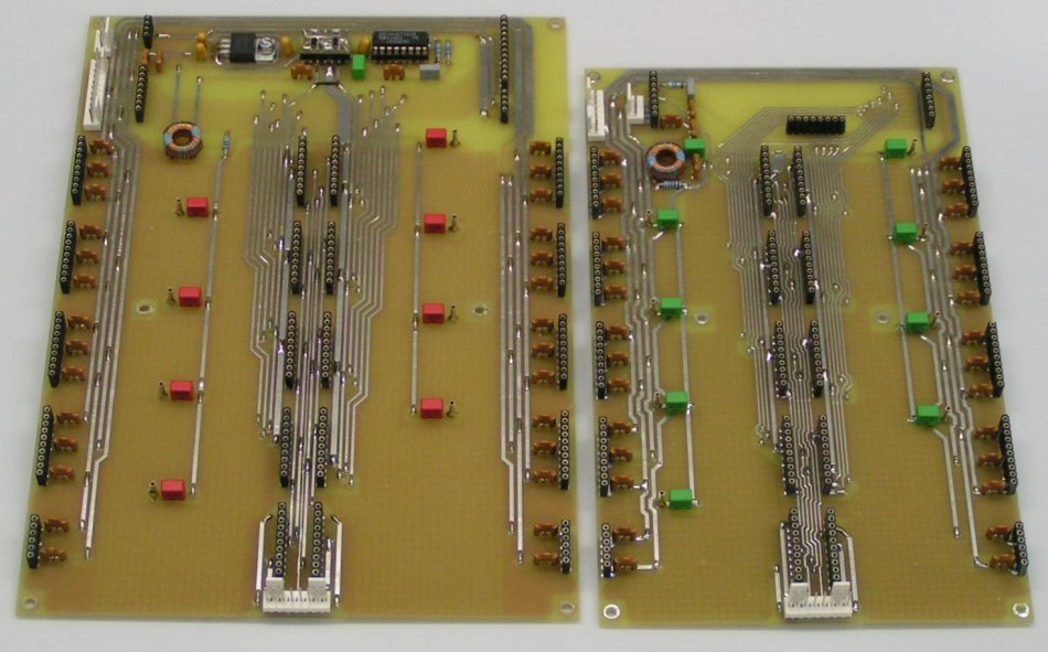

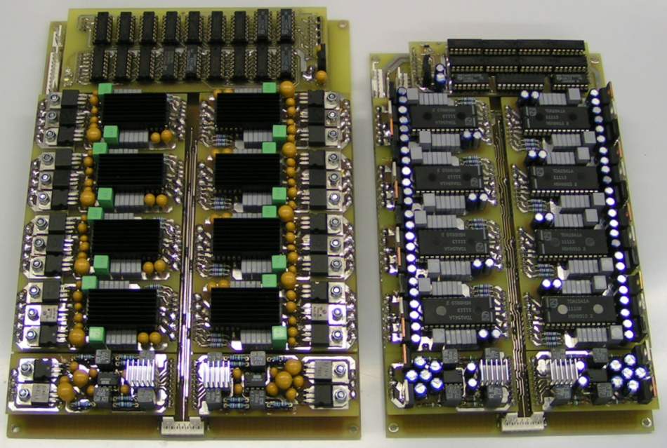

Hi MiiB,
Thanks for the compliments [post #1051]
I already experimented with jfet outputs, perhaps I could design a small jfet I/V diff amp module later. After a lot of experimenting and listening tests, I still prefer the tuned OPA627 I/V because it produces the most realistic sound so far.
The tube output of the octal D-I DAC consists of a differential tube amplifier (ECC83) and a double cathode follower (ECC81). Very high output voltages are used, the maximum output voltage of the tube stage is about 30Vpp, it enters a programmable attenuator to obtain semiconductor, tube or mixed mode. Due to this setup, the tube output stage has no problem with different loads. As noted earlier on this thread, the combination of both tube and OPA627 output creates a wonderful natural sound, it can't be obtained by semiconductor or tube amplifier only.
I added a photograph of both analog mainboards for comparison.
Cheers John
Cheers John

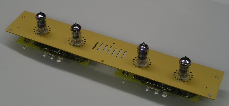

Hi MiiB,
Thanks for your reply [post #1063]
Tubes produce a very specific sound (harmonic spectrum), it's very difficult to mimmic this with jfet's. The warmth and transparency of tube amplifiers is unique.
The TDA1543 was intended for a compact 16 X D-I USB DAC, but I already have other plans with it as well. If the TDA1541A availability becomes really problematic, I plan to put a 64 X TDA1543 D-I core in the "octal D-I DAC". Rated power consumption will be around 18 Watts, so that shouldn't be a problem.
I use a differential setup because it enables DC-coupled operation, avoiding capacitors or transformers in the signal path, this ensures lowest possible phase distortion. I also noticed, interference and distortion are lower due to suppression of common noise.
DAC group 1 (not inverted) enters a tuned OP-amp I/V converter and provides the inverted output voltage containing a DC offset (I/V converter reverses polarity).
DAC group 2 has it's data lines inverted (this is handled by the timing-chain logic) it also enters a tuned OP-amp I/V converter and provides the non-inverted output voltage, also with a DC offset.
Now both signals (inverted and non-inverted) enter a diff amp, both DC offset voltages and common noise are cancelled out, but since one DAC output was inverted, the AC output voltage is doubled. So now we have a single ended output voltage with almost 0V DC component, and twice the amplitude.
The outputs of the OP-amp I/V converters are also fed to a differential input tube amplifier stage, with a single ended output. The output's of both amplifier stages (that run simultaneously) enter a programmable attenuator. The signal levels in the octal D-I DAC are way higher when compared to other DAC's. The OP-amp stage outputs approx. 20vpp, the tube stage outputs approx. 30vpp, so for the mixed mode a 50vpp signal is available. This is done to boost even the smallest details, and keeping both noise and interference levels very low.
I added a picture of both analog mainboards without the modules placed.
Best regards,
John Brown

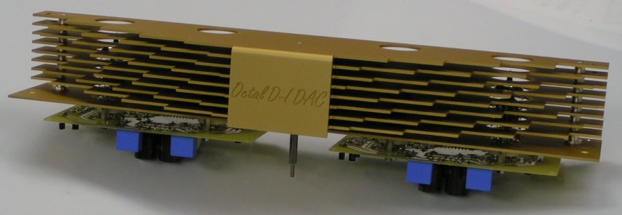

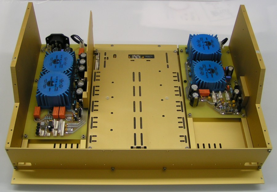

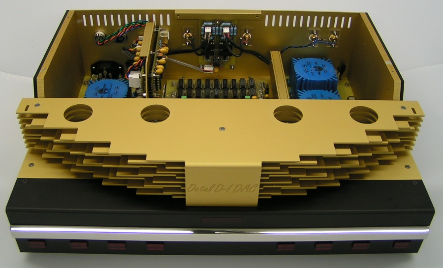

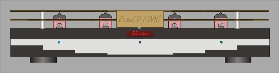

New octal D-I DAC housing
Hi MGH,
Thanks for the compliment [post #1069]
The new boards also sound very impressive, even without tube output stage. Sound is crystal clear and rich of detail, I even noticed some things on familiar CD's I haven't heared yet.
This is the most basic setup, the octal D-I DAC core and a small 20 watts power supply.
By the way, I completed the timing-chain modifications, I created some more space between the shiftregisters and added a new feature. A jumper selectable data inverter, so if you don't like to use balanced DAC outputs, placing a jumper is all it takes to disable inverting of data lines D32, D40, D48 and D56.
As for the housing, there will be a nice solution. I added a rough sketch of it. The housing will be made of annodized aluminum and a stainless steel front panel. I plan to mount all PCB's on the bottom plate, including the tube output modules. The tubes are now placed on the component side and are partially located inside the DAC housing. The new housing will be very flat, approx. 5 cm high. If desired, the top cover can be made of Lexan (polycarbonate) a clear unbreakable plastic. Now the whole interior of the octal D-I DAC is visible. I will use two multicolour (RGB) LED's for both input selection and output mode indicators. The round spot in the center is the remote control receiver.
Hi MGH,

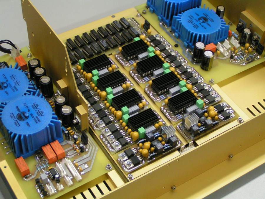

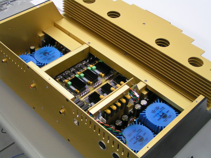

Octal D-I DAC EM immunity
Hi Onnosr,
Thanks for your reply [post #1071]
About the octal D-I DAC electromagnetic immunity, just have a look at the photographs and schematic diagrams I posted. You will find the following:
- Double mains filter is used
- Encapsulated ringcore transformers are used to minimize emitted electromagnetic field
- CLC filters are used for each voltage regulator
- Ceramic decoupling cap's are placed directly across the power supply pins of all chip's
- Every module has it's own voltage regulator(s) on board
- Pre-regulators are used
- Separate analog and digital ground
- A star grounding scheme is used
- Isolation transformer for the DEM synchronization clock
- The entire analog mainboard is covered by a grounded screening plate
- The analog mainboard has a large ground plane with a special pattern
- The internal signal levels used in the octal D-I DAC are very high, so they are less sensitive to EM interference
- The resistive output attenuator ensures rock-solid operation, regardless of the connected load
- The octal D-I DAC uses no oversampling, so it's much less sensitive to interference
- The HF signals eminating from the DAC chip current outputs are already attenuated by design (D-I mode)
- The aluminum DAC housing acts as a screen
- The tubes are screened by a protective grille
- The differential I2S inputs causes less interference and avoids ground loop problems
- PCB's have been routed manually for optimal performance.
- The octal D-I DAC has no critical (master) clock circuits that are sensitive to interference
- The tuned OP-amp I/V has a very stable tuned negative feedback loop
- The USB interface has special trace patterns for optimal distribution of the clock signals
- All I2S signals are buffered, BCK is buffered by separate tiny-logic UHS buffers, avoiding inter-chip crosstalk and interference
- Differential I2S transmitters and receivers use a separate chip (DS8921) for BCK, avoiding cosstalk / jitter
In short, the octal D-I DAC is very immune to EM fields as I have taken the necessary precautions during design to avoid interference. Basically keeping interference levels low is a must in High-End equipment, just read this thread and you will find that I paid a lot of attention reducing interference.
The octal D-I DAC should work flawlessly in a EM polluted environment.
By the way, I just received a phonecall, the octal D-I DAC aluminum parts have been annodized
Best regards,
John

DAC annodized aluminum parts have arrived
Hi all,
The octal D-I DAC annodized aluminum parts have arrived, as you may have guessed I couldn't wait and soon started to assemble some parts, after all I had to live without the octal D-I DAC sound for quite a while. I added a picture of the tube chassis part.
Hi all,
