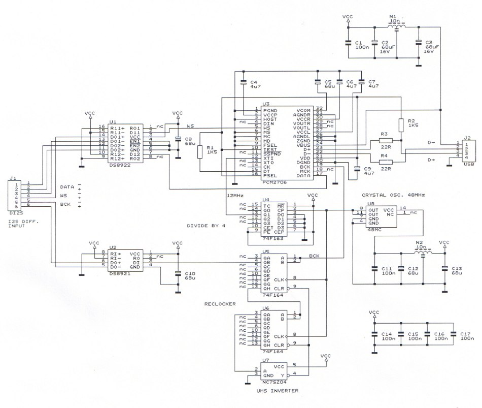

USB interface
Hi Zoran,
Thanks for your reply [post#1022]
If I am correct, I already posted a diagram of the shiftregister reclocker. But I haven't posted the complete schematics of the USB interface yet. So I added the schematics, it's a straight forward bus powered setup using the PCM2706, but it uses the shiftregister reclocker, differential buffered I2S outputs and a common 48 MHz crystal oscillator module. If you want single ended I2S outputs, you can use the differential receivers that are also located within the DS8921 and DS8922 chips. It's preferred to always use these buffers as the PCM2706 can damage easily when the output's aren't buffered.
For single ended outputs, connect the following pin's on the DS8921:
pin 6 connected to pin 8 only DO+ to RI+ (pin 8 NOT connected to GND)
pin 5 connected to pin 7 only DO- to RI- (pin 7 NOT connected to VCC)
pin 2 is BCK output.
connect the following pin's on the DS8922:
pin 14 to pin 16 only DO1+ to RI1+ (pin 16 NOT connected to GND)
pin 13 to pin 15 only DO1- to RI1- (pin 15 NOT connected to VCC)
pin 1 is WS output
pin 12 to pin 10 only DO2- to RI2- (pin 10 NOT connected to VCC)
pin 11 to pin 9 only DO2+ to RI2+ (pin 9 NOT connected to GND)
pin 8 is DATA output

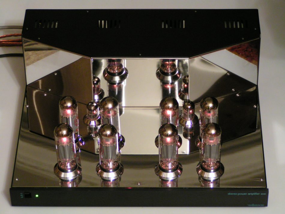

Little bit off topic here, since you are talking about tube amplifiers, guess what I have been doing? I needed a tube amplifier to test both the sonic resonators and the octal D-I DAC, but I didn't have one. I didn't want to spend a lot of money on a High-End tube amplifier, and there wasn't time to design one from scratch, so I decided to buy a K4040 kit (shame on me). I knew there were some design problems, and I might need to do some minor modding in order to get the sound right. Some JJ KT77's were ordered, just in case...
Then the kit arrived, it didn't have the ILP transformers I hoped for, the EL34's were from Svetlana, the ECC83's from Sovtec and the ECC82 from Electro Harmonics. The housing looked very impressive with the massive chrome plates, even the feet and the decoration rings for the tubes were chrome. It comes with a a huge single-sided PCB. I planned to use Beyschlag metal film resistors instead of the cheap carbon resistors, Spectrol cermet's for bias adjustment and Panasonic electrolytic capacitors. After a few hours the PCB was assembled, wiring the EL34 sockets cost a lot of time. Then it took me another day to squeeze-in the transformers and wiring as there was very little space.
I continued with the bias adjustment, there is a LED indicator for this, but it's readout wasn't very good, a lot of LED's burning and flashing at the same time, so I had to solder a 100nF across the LM3914 input to get it working correctly. Finally it was time to listen to this 2 X 90W rms tube monster, well in fact the sound it produced wasn't that good. Perhaps the Svetlana's needed some burning-in time, but after burning-in one full day without significant sound improvement I lost my patience. Measurements showed relatively high distortion and a huge peak at around 40KHz.
Next lot's of different tube brands were tested, but it became clear to me, the design wasn't optimal, so I could prepare myself for some serious modding. Starting with the input stage, what's a ECC82 doing here? I replaced it with a JJ ECC83 and changed the resistor values for maximum linear drive. A concertina phase splitter using a ECC83 to drive 4 X EL34 ?? out it went and replaced with a modified Schmitt phase splitter with a constant current source (2 X J508 in parallel) to ensure fully symmetrical drive. The ECC83 wasn't capable of driving 4 EL34's, so I replaced it with JJ ECC81. The EL34's were replaced with JJ KT77, next the 22nF coupling cap's were replaced with LCR 100nF/1KV polypropylene capacitors, yes tubee, coupling cap's can make a world of difference. Oh yes, the overall feedback was removed, only using local feedback. The bias voltage was stabilized with a 47V zenerdiode (22K series resistor lowered to 10K).
After these modifications there wasn't much left of the original K4040 design, but the sound quality was stunning, what a difference. The K4040 turned into a beautiful sounding High-End power amplifier. Distortion is much lower, it sounds crystal clear, transparent and open, with a deep impressive bass and a wonderful sounding midrange. Unbelievable what a few modifications can do. By the way, the sonic resonators work very well with this tube amplifier, same with the octal D-I DAC. I added a photograph of this modded K4040.

Nice to read about your Velleman kit experiences. I have been thinking to buy one too, but what i did till so far was a cheaper. I have a SE two EL36's in series amp design and part lying somewhere, it has to be finished. Tubed amps can give such fine sound, reasonable easy to modify. Yes a E83CC cannot drive everything, but has a large amplification factor. Allmost all old schematics use an ECC83 somewhere. Are endtubes in penthode?
Btw the Cat 5 cable sounds spacious, but not perfect. Maybe Supra cables?

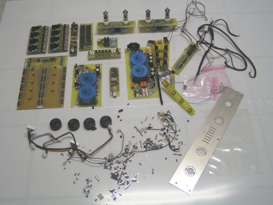

Octal D-I DAC taken apart...
Hi all,
Project update,
Yes I have been very busy, the octal D-I DAC is completely disassembled now in order to annodize the aluminum parts, I added a picture of its remains. I am already missing it's sound now, and would feel a lot better if it's re-assebled and working again.....
When looking at all the octal D-I DAC parts, it occured to me that it has become quite a complicated DAC with lot's of components, and the photograph doesn't even show the 37 CNC milled aluminum parts, only one aluminum duplicate part of the tube chassis. This results in relatively high cost and the necessary skills to build one. Still it's absolutely worth the effort, this becomes very clear when one has to listen to another DAC instead, it seems I am quite spoiled by the octal D-I DAC's sound quality.
I know the octal D-I DAC won't be cheap, so I started to figure out if it was possible to design a easy to build, small version D-I DAC, applying the same techniques used in the octal D-I DAC with a sound quality that comes as close as possible to the original octal D-I DAC prototype.
To keep the design compact and avoid high cost, the TDA1543 was selected. I already experimented with a TDA1543 based D-I DAC and even build a 32 X D-I DAC using this chip. The DAC will be based on 16 X TDA1543 in D-I mode, a op-amp I/V and diff amp. I obtained very good results with 2 X OPA627 for the diff amp and the AD823 as I/V converter.
The new D-I DAC will have a philips format timing-chain with 16 taps for DATA and 16 taps for WS. It will have a balanced DAC configuration like the octal D-I DAC to enable a DC-coupled output signal. It will accept either differential I2S or USB (optional). I will try to use a single PCB for this DAC, making it very easy to build. The housing dimensions will be approx. 32 X 15 X 5 cm. I will keep you all informed about this D-I DAC project.

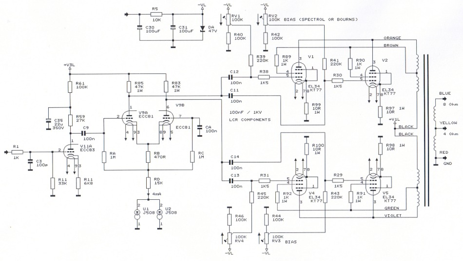

K4040 mods, schematics
Hi Alexiss,
Thanks for your reply [post #1033]
The phase splitter used in the K4040 is often referred to as concertina phase splitter, when looking at the schematic diagram it resembles a cathodyne phase splitter. One output at the annode, one at the cathode. With this setup there are problems like low gain, linearity and load sensibility.
I used a Schmidt phase splitter, the modification is a added 4mA constant current source. The Schmidt phase splitter is very linear, easy to adjust, stable and has low distortion. The outputs of the Schmidt phase splitter are both on the annodes, the constant current source lowers distortion.
I added a schematic diagram of the modifications I made, this makes it a bit clearer, the same reference numbers were used where possible, but I may have missed one, only the left channel is shown. The following list gives a overview of the modifications made:
1) 100nF/63V capacitor across D23, this will suppress hum on the bias readout.
2) R5 and R10 lowered to 10K, C29,31 increased to 100uF/100V, 47V zenerdiode across C29 and C31 (cathode to plus), this will stabilize the bias voltage, regardless of transformer load.
3) High-quality potentiometers for bias adjustment (Bourns or Spectrol)
4) V11 changed to ECC83, improved sound quality (ECC83 from phase splitter can be used)
5) R61=100k, R62=100K, R59=27k, R60=27K, R11=6K8, R16=6K8, this will set the correct gain for V11.
6) C5=100nF/1KV, C9=100nF/1KV polypropylene (Farnell P/N 106367)
7) Cathodyne phase splitter replaced by modified Schmidt phasesplitter (see diagram). J508 and J509 are 2mA constant current sources (Farnell P/N 9549951). V9 changed to ECC81 (RS P/N 5011342).
8) C11...14, C19...22 changed to 100nF/1KV polypropylene (Farnell P/N 106367)
9) RV1...4, RV5...8 changed to Bourns or Spectrol.
10) R89...96 changed to 1K Ohm 1W.
11) R32...34, R51, R29...31 and R38 changed to 1.5 K Ohm.
12) Overall feedback removed, only using local feedback.
13) Svetlana EL34's replaced by JJ KT77, clearer sound, better bass and trebles.
14) 3.3nF/5KV capacitors were placed in parallell with D11...D14 to suppress switch noise.
15) ZD1=3.9V zener instead of 7V5 (solves mains brownout problem, this is already modified in new kits)
The EL34 sockets may cause bad connections when a tube with bigger pin diameter has been inserted once, due to bent contacts, pin 5 should be checked carefully as it is also used to set the bias current. Higher quality tube sockets could be used.
All carbon film resistors were replaced with Beyschlag 1% metal film resistors for stability and lower noise.
Always be carefull working on high-voltage circuits, wait until the electrolytic capacitors are fully discharged. When modifications are made, always double check before switching-on the power.
Finishing touch, the chrome decorative rings may scratch the large chrome plate, so I applied protective self adhesive polycarbonate sheet (used to protect front panels) to avoid scratches.
