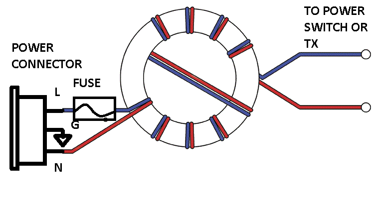

I've been asked how many turns for the "Reisert Bifilar Balun"?
Based on recent listening, I believe the more the better. I will probably re-wind some and see/listen.
I appears that R and C vary with N (n° of turns) but L vary with N squared, which apparently brings the resonant point lower...I hope this is a good thing :eek:
Anyway, there you have, probably the best and cheapest upgrade of them ALL.

Hi Max,
I don't get it what's this thing about safety, add a fuse. Aren't trafo wound this way with enamal wires & yet ???? Anyway I tried it already using only 1 layer & it works Max but you don't get something for nothing. You hear deeper in the recordings, sound like Cymbal crash becomes more realistic. Cons images becomes larger & forward sounding. Now you've open up a can of worms for me. Ferrite ring size & enamal wire gauge used will surely have an effect as well not mention how many layers.

The common mode filters you constructed may cause short circuit (thin insulation) in the event of a power surge or when the insulation gets damaged by 50Hz vibration. It is best to use double lacquered copper wire (stronger insulation, high melting point of the insulation). Also dip the complete assembly in suitable lacquer so the wiring can't resonate and rub-off insulation over time.
Usually common mode filters have two separate (isolated) windings in order to prevent short circuits.
The way you have drawn the balun, both windings do not cancel but add. So the net result is a plain common-mode filter. This winding technique is often used in RF (insulation) transformers in order to improve signal coupling at high frequencies.
It would be even better to use wire with thicker heat resistant insulation (PTFE) that is rated for applied mains voltage. When using lacquered copper wire I strongly suggest to add a fuse between both, mains inlet and the common mode filter. There is a PCB fuse soldered on the power supply PCB of the Mosaic UV, but it won't be of any use when the common mode filter placed in front of it shorts out.

Dear Sumotan, do both halves before the second winding, for increased, physical integrity. Yes, apparently lower gauge n° is better and usually has thicker insulation. I do not feel slower sound. I hear deep into the recordings, with sweetness and color and textured melodic lines, with rich detail and harmonics, for example in massed strings, etc. Dynamics are great, with my beloved Amnesis amp. I should try this with my First One amp that uses a Hypex SMPS.

I have though about a short. Like it is now, the main house brake will be triggered instantly.
Anyway, I have used this trick for around 15 years without any troubles.

Hi maxlorenz,
The crossover at the middle of the winding minimises capacitive coupling between both, input and output by maximising the distance between input and output.
Without it, the output would be located closer to the input and would therefore increase unwanted coupling between both input and output.
The lower the capacitive coupling between both input and output, the better the noise suppression.
So basically it's just a common mode filter choke, nothing magical about it.

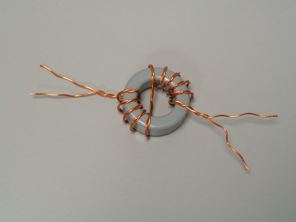

This is a common mode filter with two separate windings:
https://images-na.ssl-images-amazon.com/images/I/41iJTIz6+hL._SX342_.jpg
Running both wires in parallel instead of using two separate windings improves coupling between both windings and thus increases the bandwidth for noise canceling.
Coupling can be made even more effective (larger bandwidth canceling) by using twisted pairs (attached photograph).
So this Current Balun simply cancels unwanted RF frequencies in a specific frequency range, typically between 1 - 54 MHz with a good Balun construction.
You could also experiment with current Baluns in the audio signal path (RCA). This could cancel RF ground loop noise that travels along the RCA audio interlinks.

All my units, safe one, have fuses incorporated in the mod.

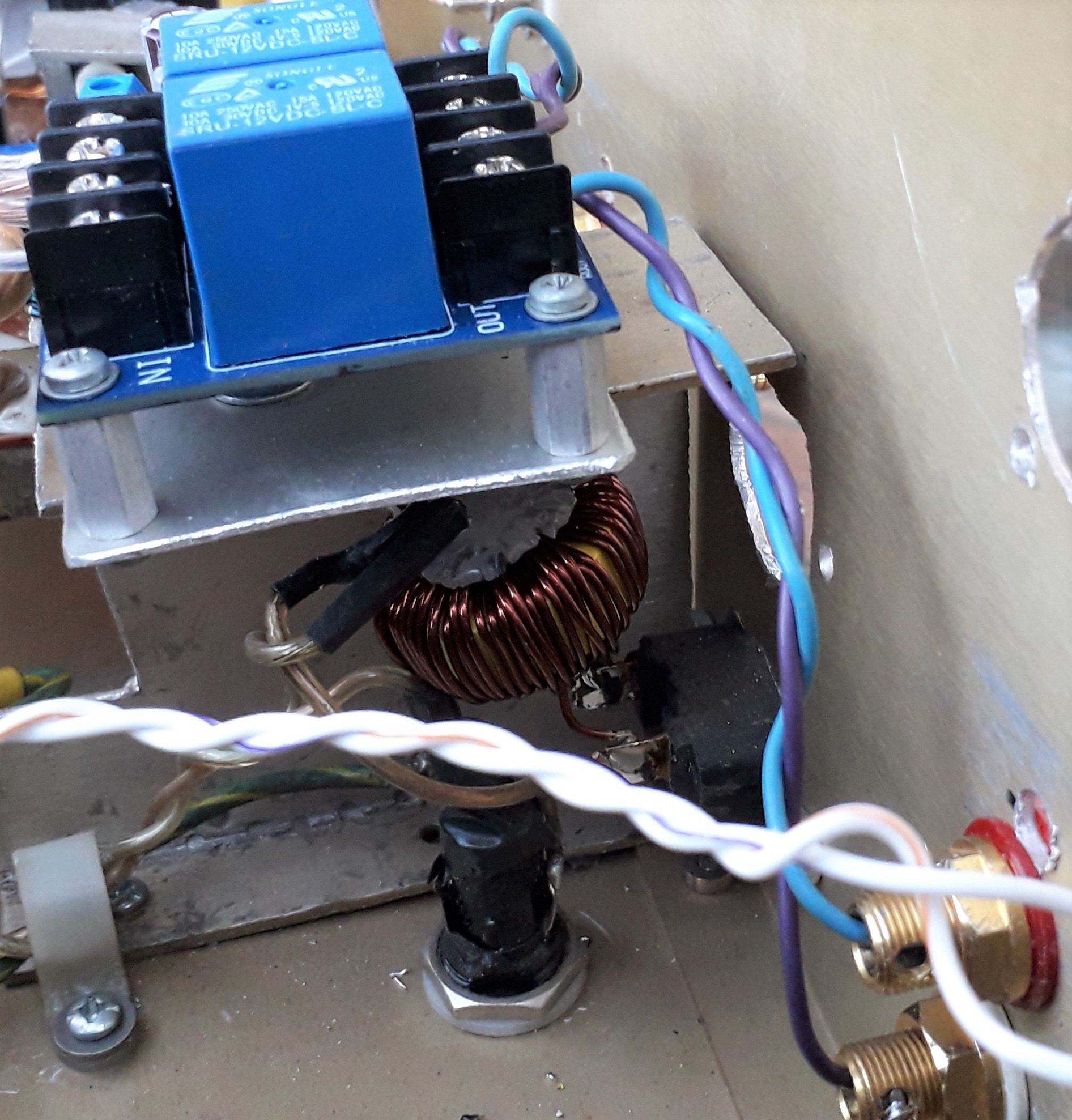

This mod also works in the secondary of the TX. I will try today both positions, pre and post-TX. :cool:
Edit: updated diagram, to comply.
M.
