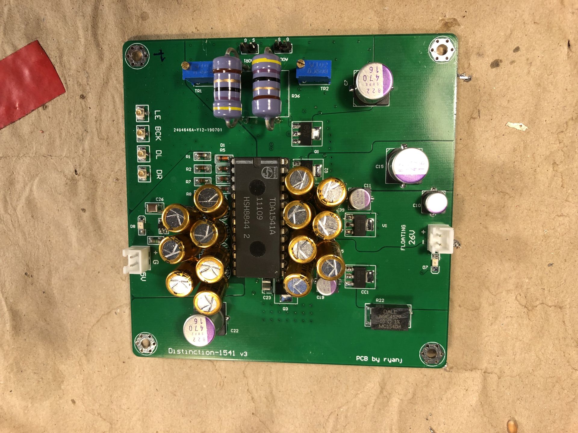

Hi cumbb,
I've found that having the 100nF np0 in parallel with the 100u gives a slightly better sound. I remember thinking it sounded less noisy as well.
Try Kaisei bipolar 100u16V. Great sonic improvment! They are a bit bigger than the Nichicons and need some time to burn in, but worth waiting.
Thanks for that feedback. This is precisely what I was contemplating, but hoped to see someone practically do it and report their findings.
If I could find 100uF BG PK I would use those. Sadly I did not pick some up when they were still around. I wondered if the Kaisei would be on the same path.
Joined 2016
Ecdesigns was advising against 16v caps - they will be running close to their limits and so may not last as long?
Could try placing some alternate caps on other side of board to give yourself more space? But the bunching looks better than where I have added more capacity in my NAD350 amp!
Quote:
Why bipolar instead polar caps? Are polar better for this job?
General experience is that bipolars sound better. If you choose polar with same spec, you may have smaller diameter ones which look better. And what about the sound? Who knows, maybe not as good as bipolar, only slightly worse but better than nichicons. I bought 4 pcbs, but since I heard the sound of this Kaiseis, the urge has flown away...
If I well remember, there were no BG PKs with this spec. 100u16V or 25V was only available in much bigger standard, F, or N series. I tried 10mm diameter elkos, but the look was not that attractive. Kaiseis are theoretically on halfway to BGs. Anyway, not an impossible investment.
If I were a manufacturer of goods to sell, I would have chosen 100u25V polar Kaisei to be sure not exceeding any limits. But I'm a hobbyist, who can solder another cap if necessary. Prior to soldering I tried several diameter caps, how they look. This way the pcb appearance is not very awful. (I would have been a bit happier If Ryan had provided some more space for the caps)

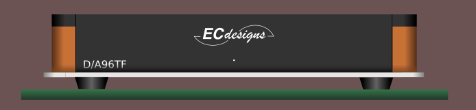

I attached a sketch of the D/A96TF housing that measures approx. 15 x 15 x 2.5cm.
