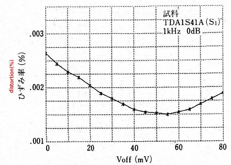

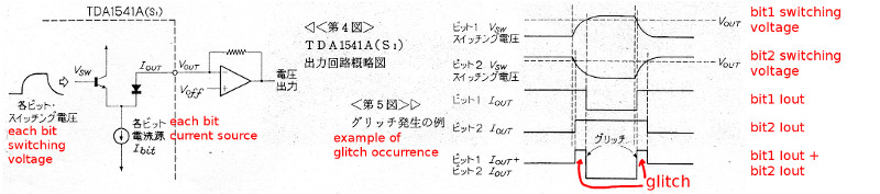

Hi Skorpio,
The I/V stage built around the 2SK170 is outdated, one of the problems is that it exceeds TDA1541A output compliance.
The adjustable DC reference voltage takes care of this. It consists of a 1K trimmer with a 1000uF cap between wiper and GND, and another 1000uF cap between the wiper and +5V.
The voltage at the wiper serves as GND connection for the RCA sockets. This works as long as this reference voltage is not short-circuited by other connected equipment.
The trimmer is set for lowest possible DC voltage reading between the wiper of the trimmer and both RCA outputs.
This design requires no coupling caps, it ensures highly transparent playback with optimal bass response and ease of mind that one exceeds the performance of the best film caps available.
Not with the 5V supply. When the supply voltage (for the I/V stage only!) is increased, to say to 10V, it is possible to double the output amplitude by using a 1K I/V resistor. Disadvantage is that the selected bit currents no longer flow back into the 5V supply like the unselected bit currents do. This leads to higher ripple voltage on the 5V supply and increased on-chip jitter levels.

Last week,I went library to read old audio magazine.
Although it was not my objective, I found a interesting tweak of TDA1541A that is employed in nakamichi 1000p, in its commentary article.
It is well known, a harmful mid scale glitch occurs when MSB and lower bit switches over.
Nakamichi have employed two new deglitching circuit in 1000p.(though not SHA)
One is too complexed to imitate,(patent US5034744)
but the other is easyly applicable DIY projects.
(though i don't know whether it is violation of something copyright or patent.)
TDA1541A have diode-transistor switch to switch on or off bit current.
Thus their threshold voltage is affected by voltage of Iout pin node.(normally 0V)
Hence, it may be able to trim switch timing to minimize glitch by trimming no signal voltage at Iout.
It is easy if the IVC is typical OPA-IV, add some offset voltage to noninverting input.
Nakamichi published the distortion at 1kHz 0dB signal is lowered about a half with this tweak.
Ref. 橋本秀夫 小日向肇 ,ナカミチ#1000DATのコンセプト-3,ラジオ技術, 1989年4月号 pp. 48-52
