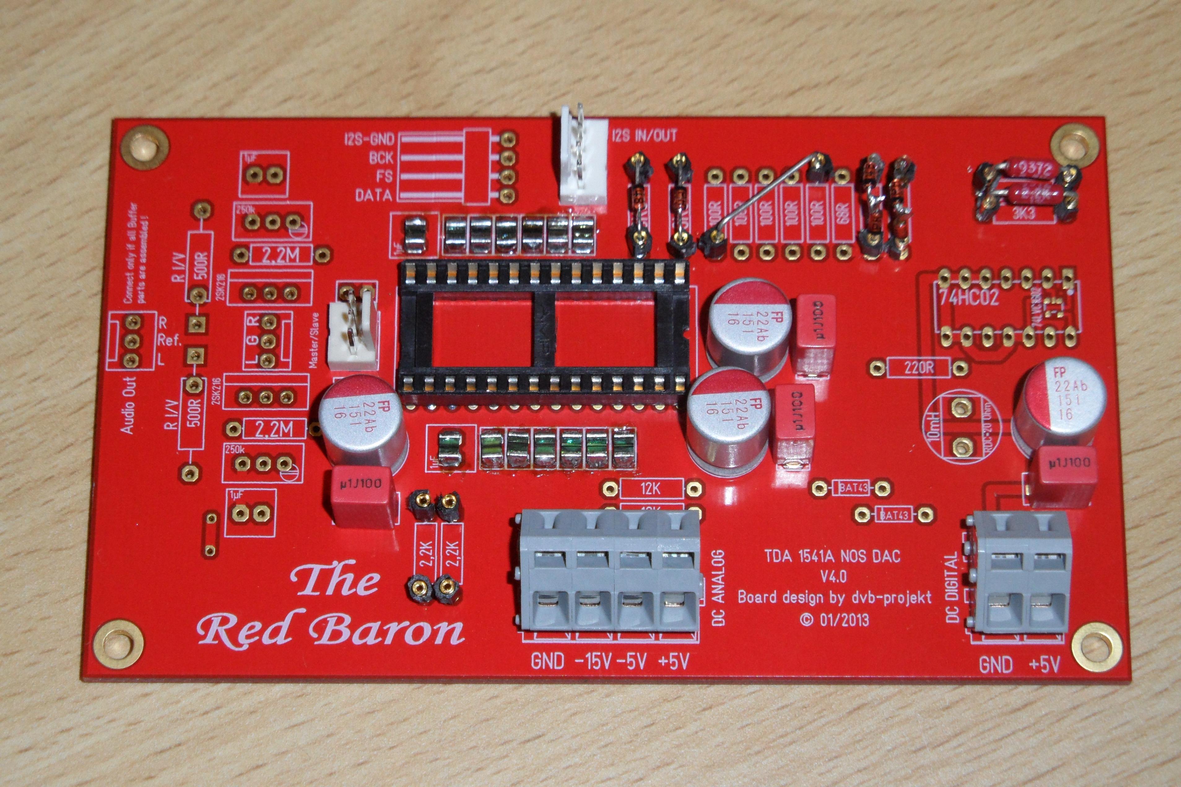

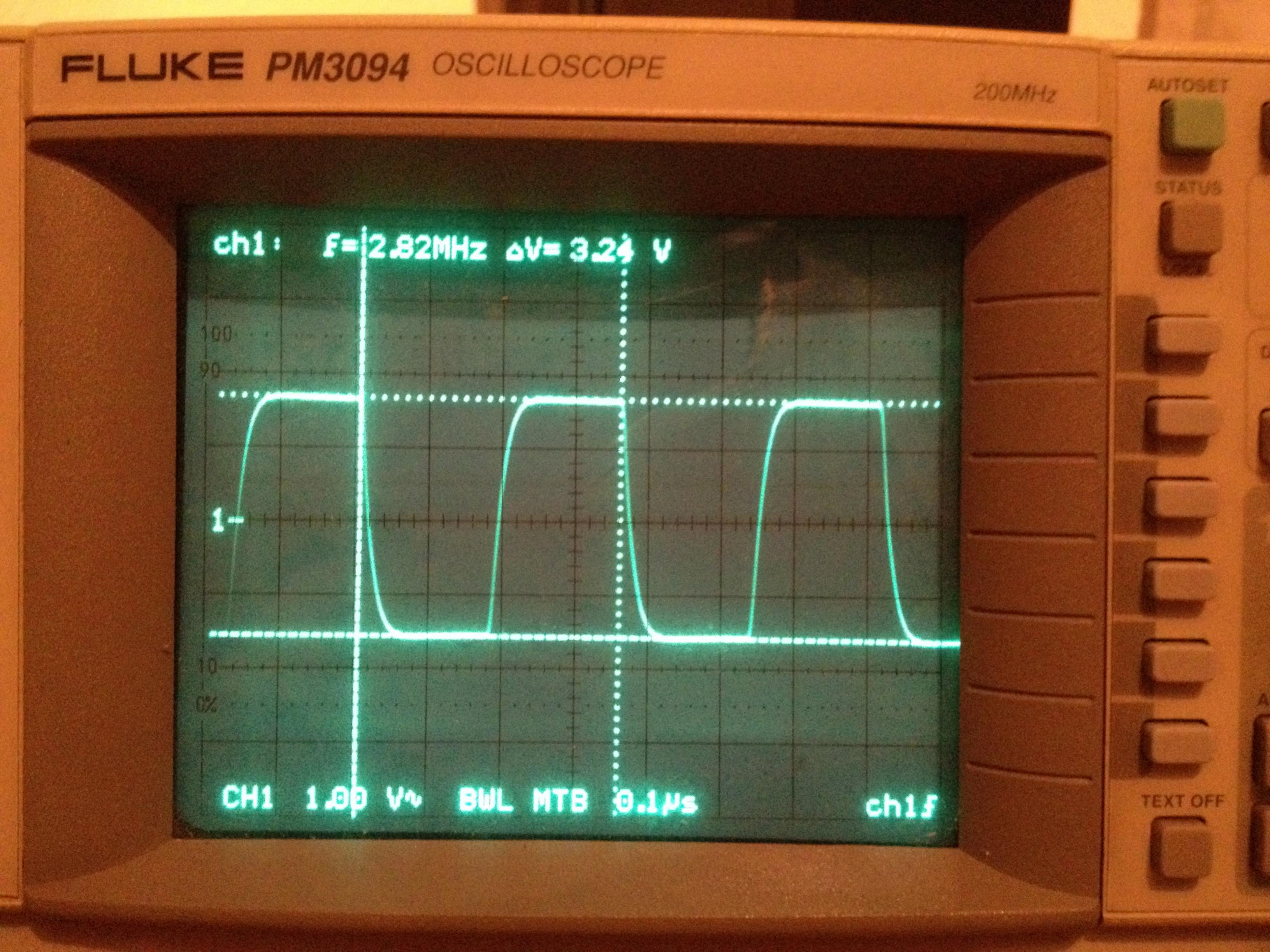

Hi John,
i had integrated all changes above on my Red Baron test board. The 3.3V comes from one of my +5V SSLV Shunt modules (modified). It worked great!
Now the only question is, should we attenuate the BCK to your regarded 800mVpp with perhaps some TX2575 bulk foil resistors?

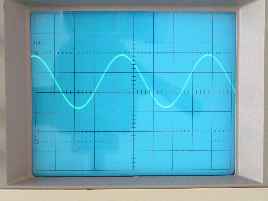

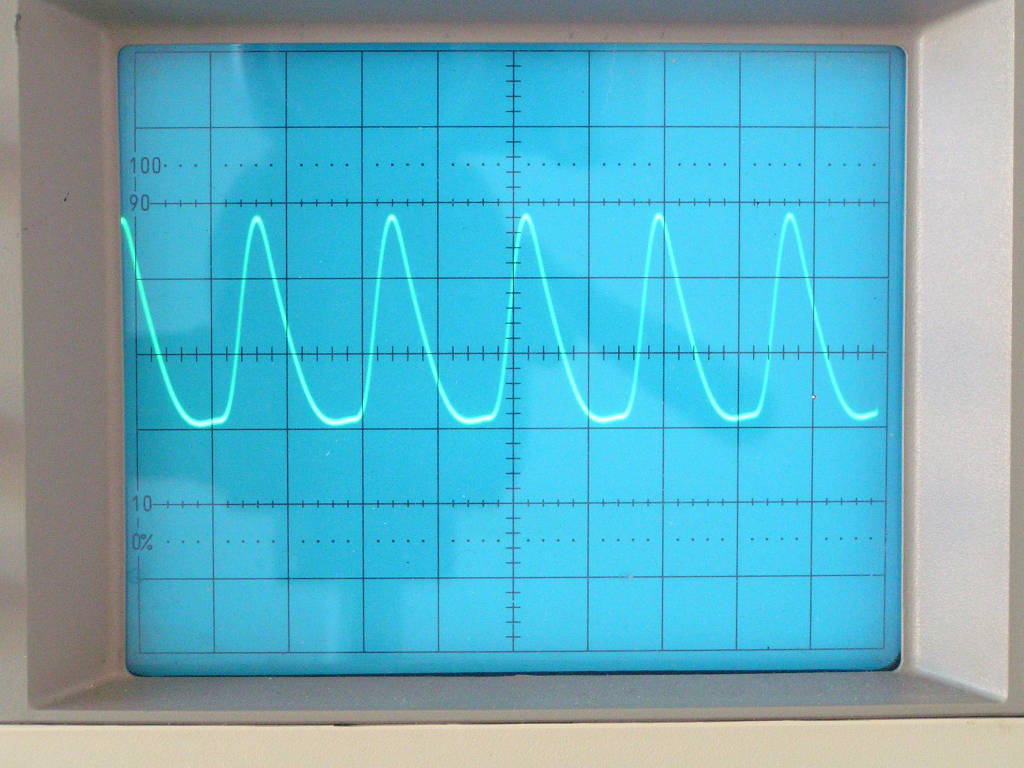

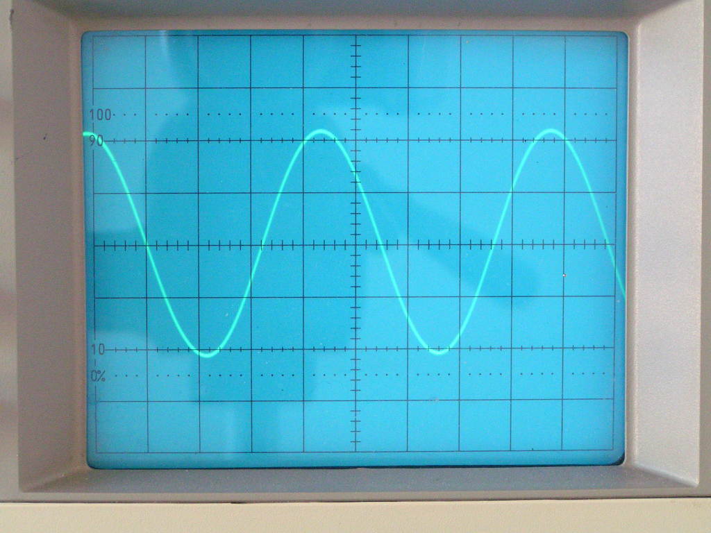

Hi SSerg,
I use an electronic tuning fork. Phase noise spectrum tuning is mainly obtained by tuning the properties of the active single transistor drive circuit.
First oscillogram shows the drive signal (input node, 0.5V/div, 11.289 MHz).
Second oscillogram shows the signal on the primary node (1V/div, 11.289 MHz).
Third oscillogram shows the signal on the secondary node (1V/div, 11.289 MHz).
All 3 nodes are "isolated" for all frequencies but the fundamental (11.289 MHz). This prevents cross-pollution between connected circuits.
The microcontroller is connected to the primary node using a low pass fliter / attenuator
The PECL divider is connected to the secondary node.
PECL divider circuit outputs 800mVpp BCK signal with exactly 1.1V DC bias.
