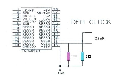

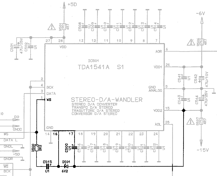

The best TDA154x I2S attenuators for WS and DATA are circuits resembling the TDA154x I2S input circuit. You could try 3 x 1N4148 to GND (all cathodes facing GND), 1 x 1N4148 in series with WS / DATA input signal (cathode facing source), and 2K2 pull-up resistor to +3.3V. This would give a signal swing between +0.6V and + 1.8V, regardless of input signal level.
With some creativity you could fit these components on the existing PCB:
- Replace 3K3 resistors (attached to +3V3!) with 2K2 resistors (WS & DATA).
- Replace 1K resistors with diode string of 3 x 1N4148 in series (cathodes facing GND).
- Replace 3K3 resistors in series with WS & BCK with a diode (cathode facing digital audio source).
BCK is extremely critical, attenuators are best avoided here, even plain series resistors are a problem (noise). Best results can be achieved by using 800mVpp BCK signal (not derived from an attenuator) with less than approx. 300 Femto seconds of jitter, but this is kind of "problematic" :)
So simply remove the BCK attenuator and hope for the best:
- Remove 68R, 220R, 10mH choke and all 100 Ohm resistors. Feed source BCK signal directly to pin 2.
Synchronising the DEM oscillator remains extremely critical and performance is inconsistent and unpredictable due to thermal drift of the TDA1541A circuits and other factors.
I have some ideas about a suitable DEM synchroniser circuit, but for now I suggest to go for the low jitter, free-running DEM oscillator:
- Replace both 2K2 resistors with 6K8 resistors, remove both 10K resistors and the CMOS crap.
- Put a 2.2nF SMD film cap between pins 16 and 17 (as close as possible to the chip).
This means that there is no more external DEM oscillator triggering.

Hi dvb-project,
Hi
I'm using this DEM synchroniser circuit from Grunding.
Is it better to replace it by your suggestion of using 6K8 resistors, no cmos, and 2.2nF SMD film cap between pins 16 and 17, like in my second image ?
Thanx
Paul

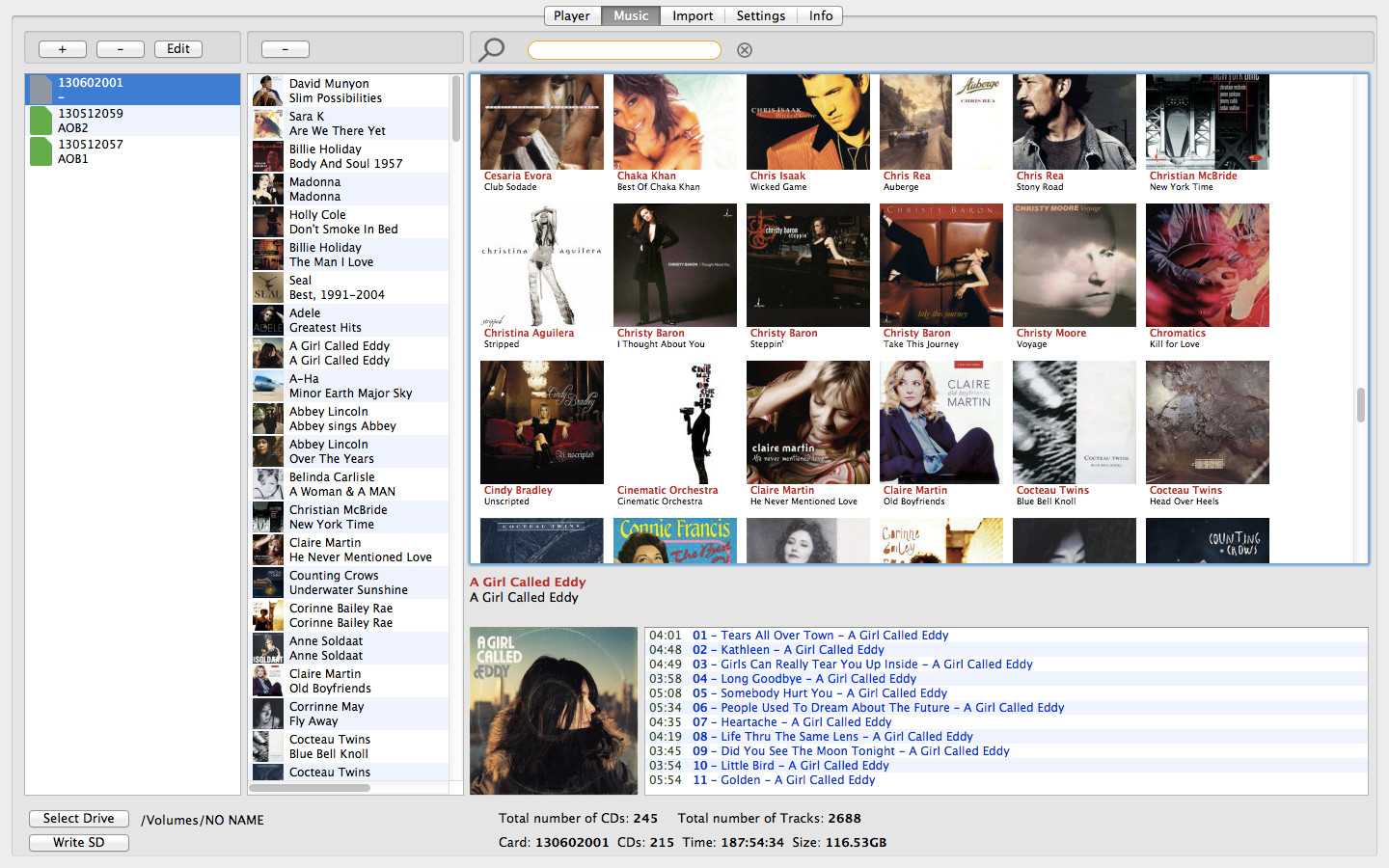

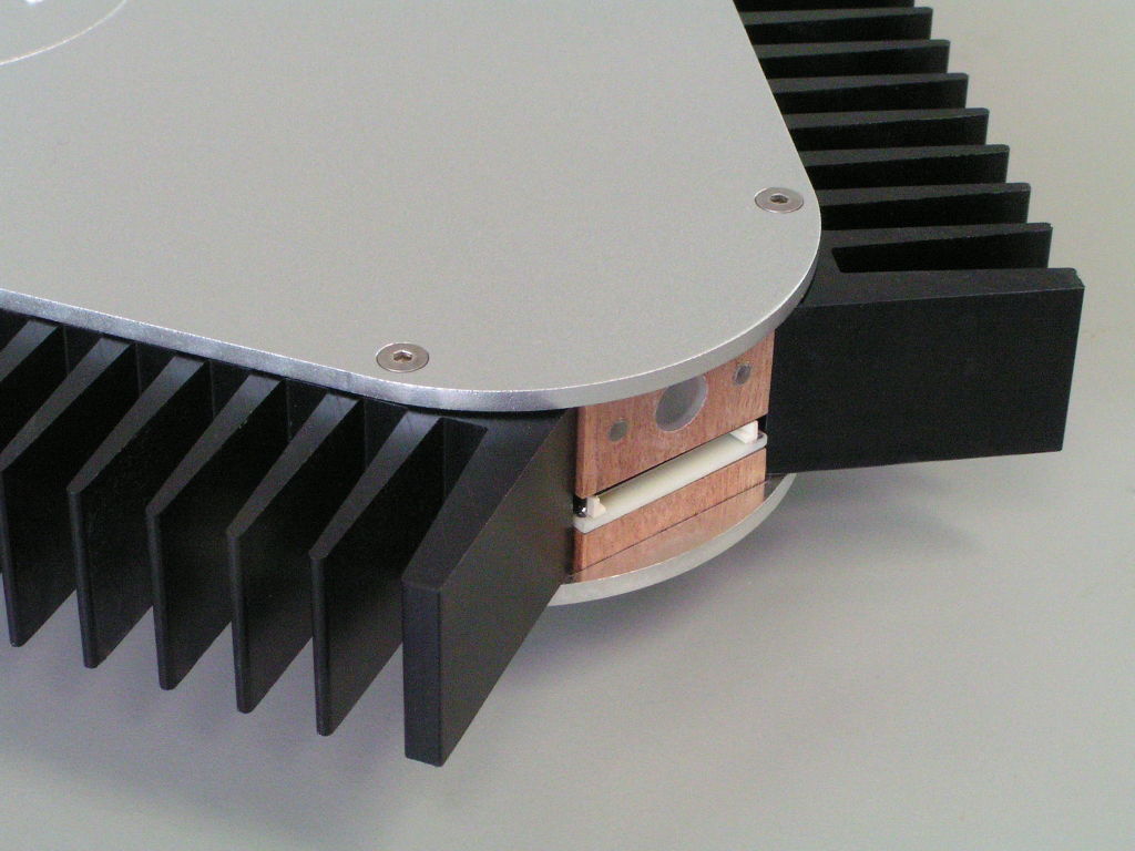

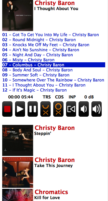

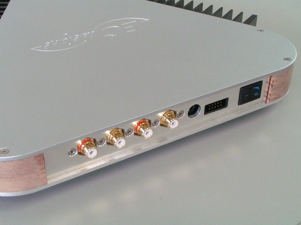

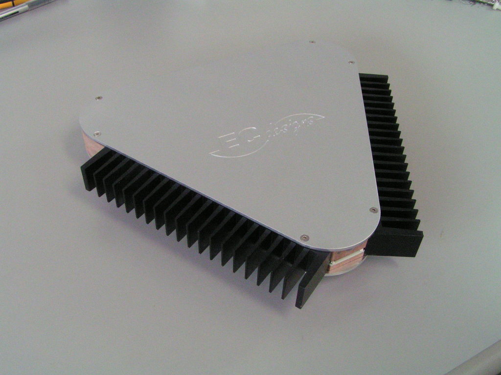

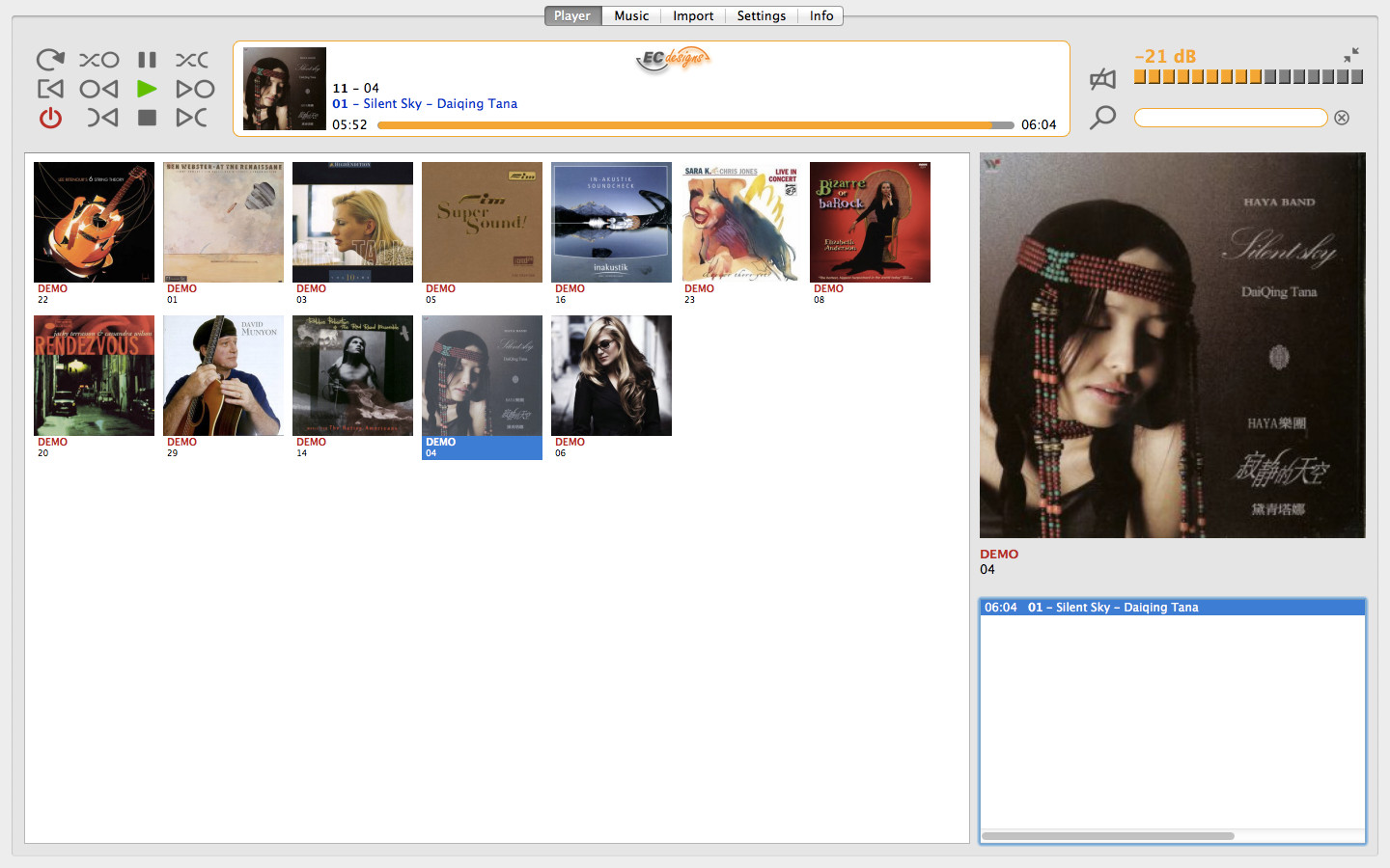

I attached some pictures of the SDV1-player that was just completed. Here the separate SD-player and volume control units are integrated in one housing.
I also added some screenshots of the matching computer software, the SD(V)1 can be (wirelessly) controlled by computer, laptop, pad, or smartphone.
The new SD-player supports up to 999 CDs on one single SDXC card, it runs on an external 12V power source, mains adapter, battery, solar cell ...
