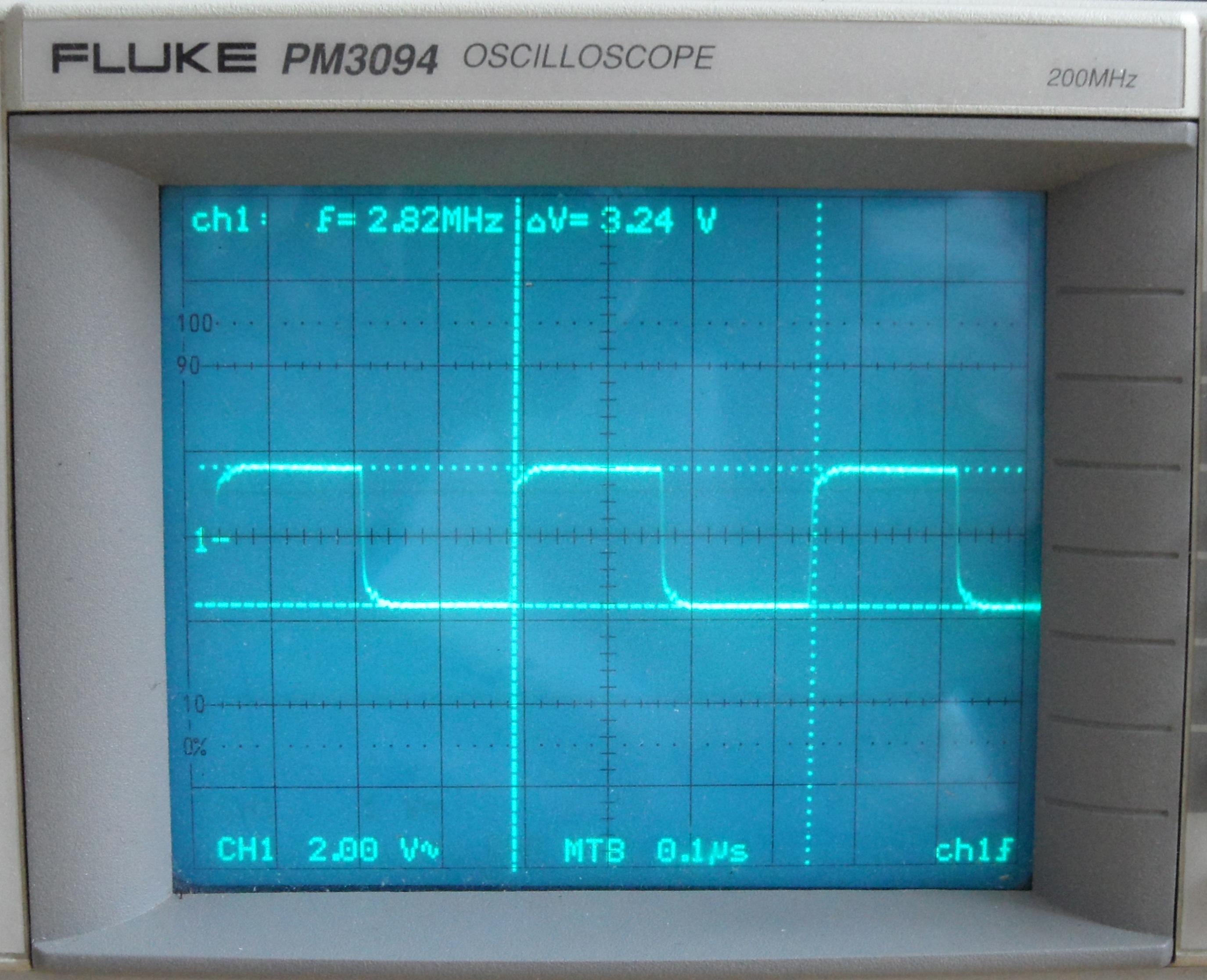

BCK needs to be around 800mVpp (approx. 1.2V DC bias) without using an attenuator, so this problem has to be solved in the BCK divider circuit.
BCK overshoot (on the scope) is usually caused by an incorrect probe. One needs to use HF probes, something like this:

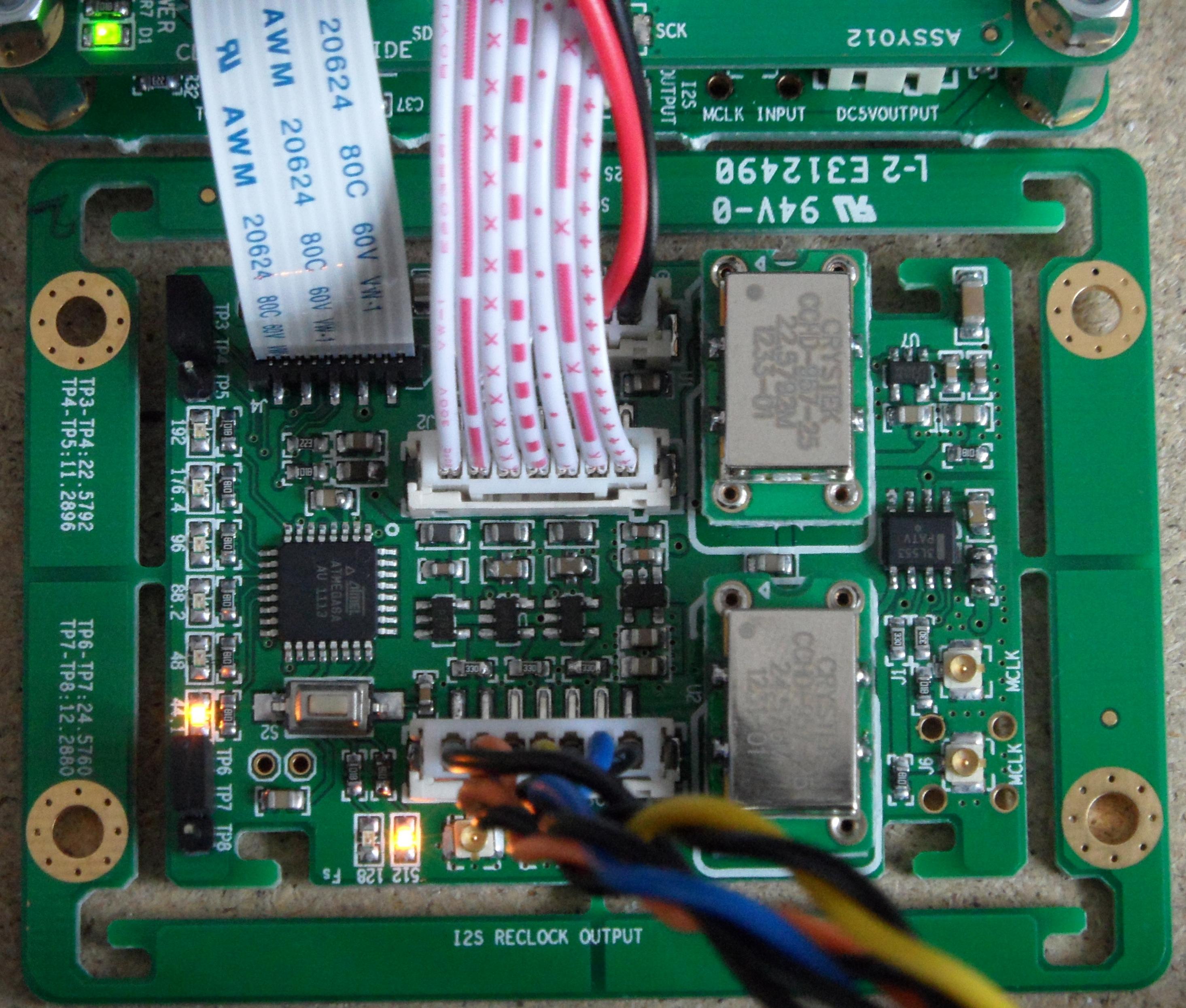

In the upper post you recommed to cancel the BCK 5x100R att. and the complete divider circuit parts for the 1.2V bias.
Without all parts i have the full BCK output voltage from Ian´s FIFO at PIN 2 and no Bias...?
I think i have not really understood what to do...:rolleyes:
Joined 2009
I attached the BCK output signal from Ian´s FIFO.

Resistive attenuators lead to less steep transients, this opens the door for trigger uncertainty in noisy environments.
That's why I suggested to directly connect FIFO BCK out to pin2. This is the best compromise given the practical drive circuit limitations.
I also suggest to use shortest possible connection between FIFO circuit and TDA1541A BCK input. With shortest possible I don't mean a few centimeters mut more like a few millimeters.
If you want to experiment with a BCK attenuator you could try a similar diode attenuator like with WS and DATA. The pull-up resistor value then has to be lowered to 120 Ohms. The resistor value needs to be as low as possible, but it's minimum value is limited by the typical 25mA max. output current of the FIFO reclocker.

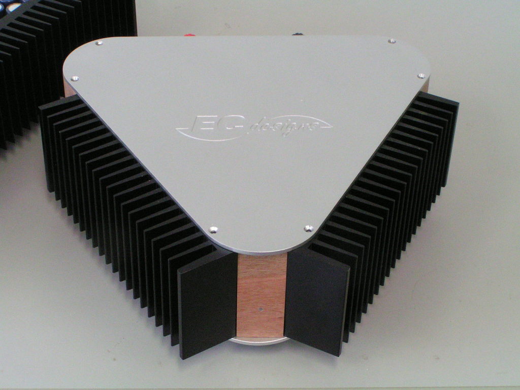

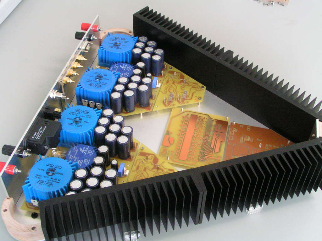

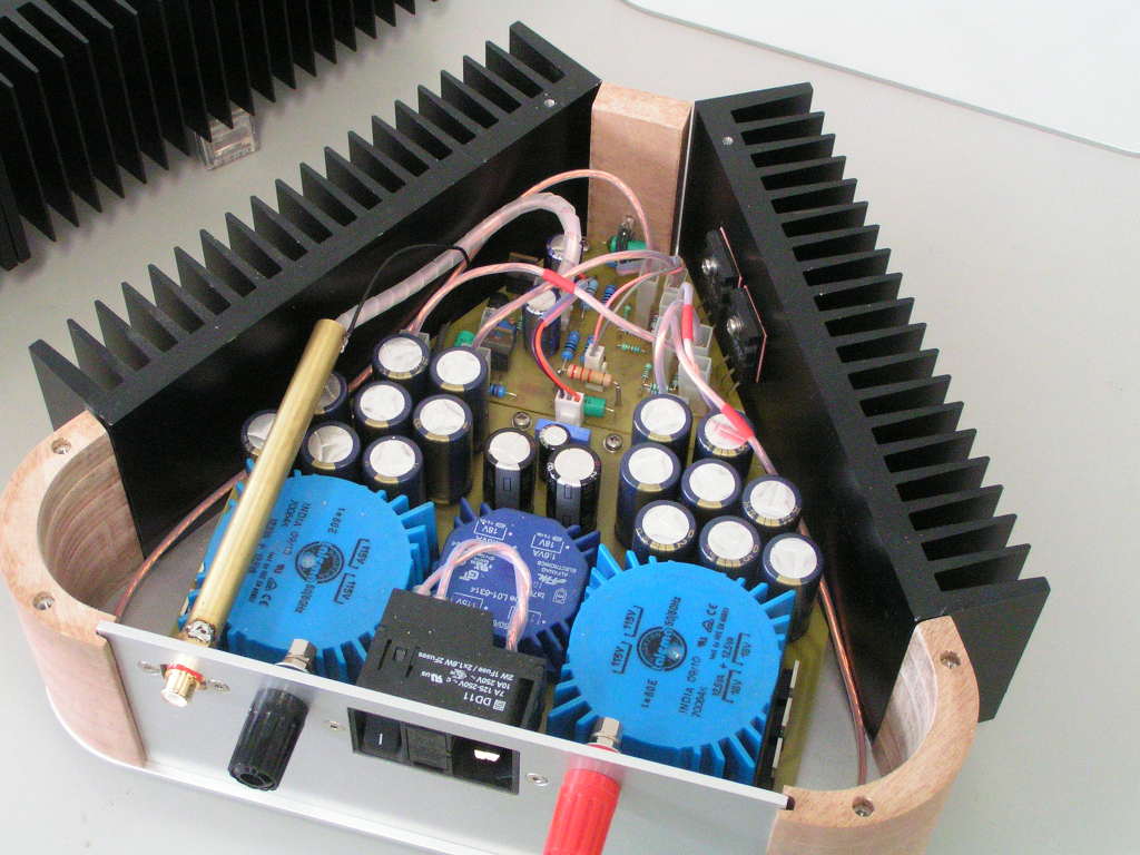

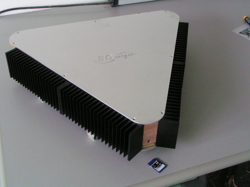

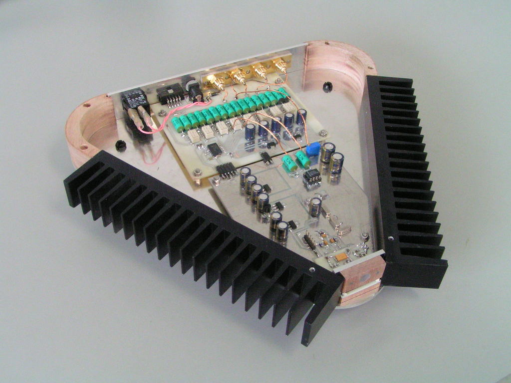

I attached a picture of the SDV1-player prototype during construction.
It contains the final SD-player module and a binary stepped shunt volume control.
The integration of SD-player and volume control eliminates two RCA interlinks and enables one local star ground. The degrading of a single RCA interlink is quite alarming at these extreme performance levels. Biggest problem are the multiple metals in the connectors. These will reduce resolution, a single contact can already mask a few LSBs. In the SDV1-player I soldered OFC litz wire directly to both PCBs using solder containing 3% silver.
In order to maintain maximum resolution in the power amp, I developed new Circlotron monoblocks (pictures). These have a differential input stage based on matched medium power lateral MOSFETs running on a separate, very clean high voltage supply (100 … 200V). The Circlotron output stage contains two closely matched lateral power MOSFETs. So there are total of 4 lateral MOSFETs used in the complete power amplifier. rated output power of this version is around 30 watts rms in 8 Ohms.
Logical consequence is integrating the monoblocks with the SDV1-player. This eliminates the last two RCA interlinks and enables a local star ground for all circuits. I attached some pictures of the experimental ISD-player prototype during construction.

The I/V stage for both TDA1541A and TDA1543 have similar complexity. Both -must- fully meet TDA1541A and TDA1543 50mVpp output compliance. DAC chip output signal bandwidth also needs to be limited prior to I/V conversion.
Hi, John,
I'm uncertain as to what is your latest I/V circuit. The last one I recall seeing was based on single grounded gate FET with a resistor drain load. Your comment above leads me to wonder whether you might now be using some more complex design. Could you confirm exactly what I/V circuit you now use? Thanks. :)
Hi dear -EC-,
I am glad that you are close to production/marketing stage (at last) ... :D
I hope that you will also be offering some prototypes for sale.
You must be aware that the heatsinks are not very aerodinamic and will limit the unit's max speed :D
Are those Panasonic FM caps? Good caps, but I am partial to Rubycon ZL wich produces best bass (even with passive I/V) and overall sound.

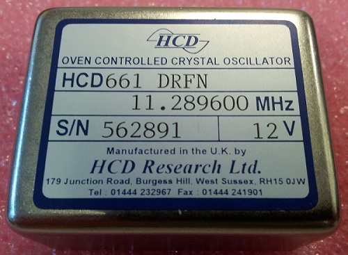

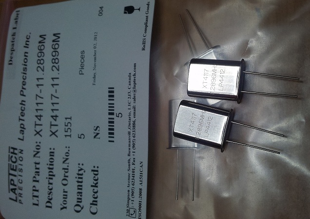

I use a novel electronic tuning fork that replaces the relatively noisy and jittery crystal oscillator. Fastest available ECL circuit was used for BCK divider.
Not all the crystal oscillators are jittery and noisy, depends on the crystal quality. Good crystals are expensive, while mostly of the commercial designs use poor crystals, Finally, the only problem is the budget.
The OCXO showed in the attached image has a phase noise better than -130dBc@10Hz, more than needed in digital to analog converters.
The crystal showed has an ESR of less than 10 ohm and Q greater than 150K, that means it can easily reach at least -120dBc@10Hz with a 2 transistors Butler or a Driscoll oscillator. This is a cold welded package polished AT crystal. Obviously it costs much more than the poor crystals used in commercial XO, but it's cheaper than the SC-cut crystal used in the above OCXO.
Nice find! May I ask what the price of these babies is? Also, is it spec'ed at -130db or did you measure? I can't find the datasheet on the Laptech page (don't know which one it is....
Also, I believe the better way is to don't use any divider for the BCK, feeding it directly from the XO, If the source need higher clock frequency than the BCK, IMHO, better use a frequency multiplier for that, rather than divide the MCLK for the BCK.
As long as BCK is reclocked, it's probably indeed better to feed the cleanest clock signal to the reclocker and the multiplied clock signal to the source. The picture you show is of a 11mhz crystal though :confused:
