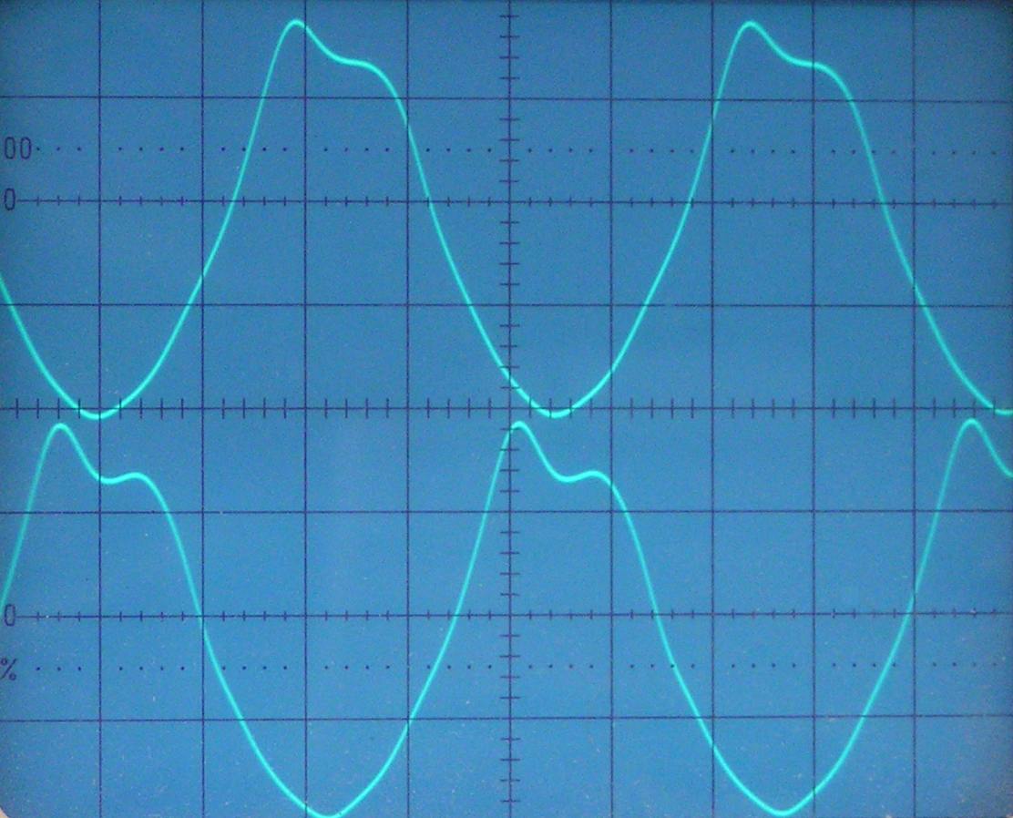

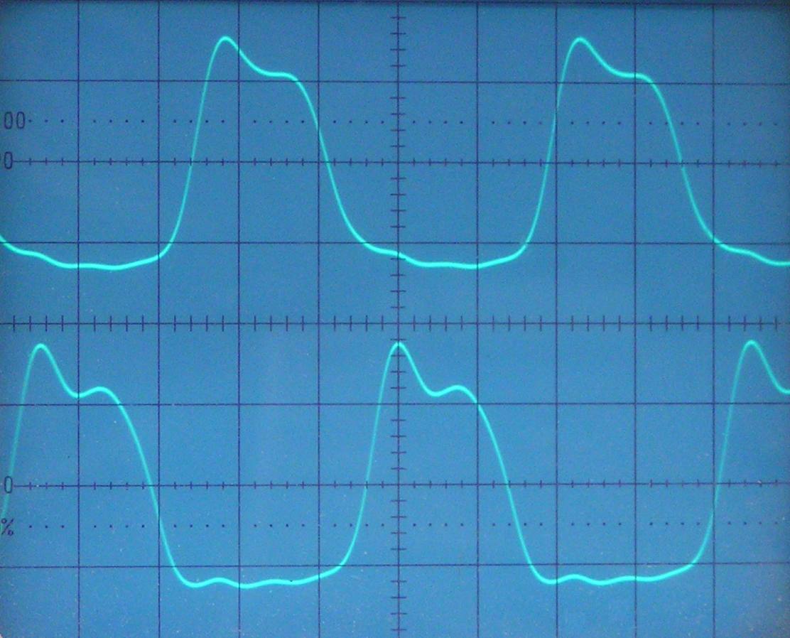

John, couple of questions on your clock design. I measured the signals on the scope. Here are the pics:
this is after the diode and resistor. You see the rise time is shorter, but it lost its sine shape.
This is after the coil, before the diode. It has ugly bottom shape...
This is at the crystal... Looks fine.
1. Is the signal supposed to behave this way?
2. What causes the skewing? Coil Q?
3. Are there harmful effects on jitter?
Thank!
Thank!

Hi studiostevus,
I attached oscillograms of the balanced output signal of the MK7 masterclock. The signal on the crystals should be a clean sine wave like you measured, the signal on the lateral MOSFET buffers should look like on the first oscillogram.
After the RF Schottky rectifiers, loaded with 330 Ohm it should look like in the second oscillogram.
The connected D flip-flop has low threshold voltage (it runs on approx. 2.4V power supply) and is triggered on the rising (steepest) edge of the rectified output signal. Power supplies for both masterclock and D flip-flops are extremely clean in order to minimize circuit trigger uncertainty.
