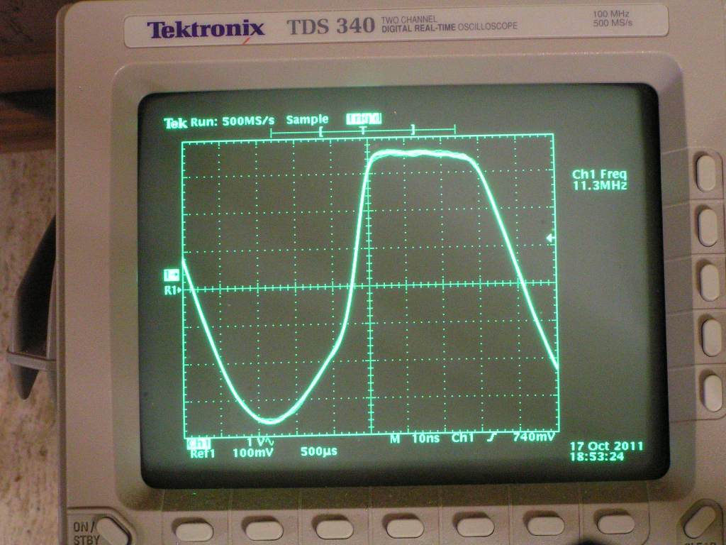

You may want to consider finding someone with a higher bandwidth scope to visit and take some measurements. With your 50MHz maximum scope bandwidth, the fast edges may not be as rounded as pictured on your screen shot. Make sure you are not using a low bandwidth probe as well...
If that is a 10ns rise time edge in John's picture, a 100MHz bandwidth scope would be nice to see what it is really looks like. 50MHz just barely makes it. I reality, the edge in John's circuit is probably on the order of only a few nS and the wave shape may be somewhat bandwidth limited in his photos as well. Just as an example - A 1nS rise time requires a 500MHz scope bandwidth (and probe bandwidth) minimum in practice, 1GHz would be optimal.
This note gives a quick overview of bandwidth requirements and has some pictures of what scope bandwidth limits can do to a digital waveform. The same signal is captured with scopes of increasing bandwidth: http://cp.literature.agilent.com/litweb/pdf/5989-5733EN.pdf
It is also important to use good scope grounding techniques - Don't use the ground lead. Put a tip ground on the probe and find a ground close to the measurement point. This keeps the measurement path coaxial as much as is possible to minimize the effects of stray noise and ground currents polluting the measurement.

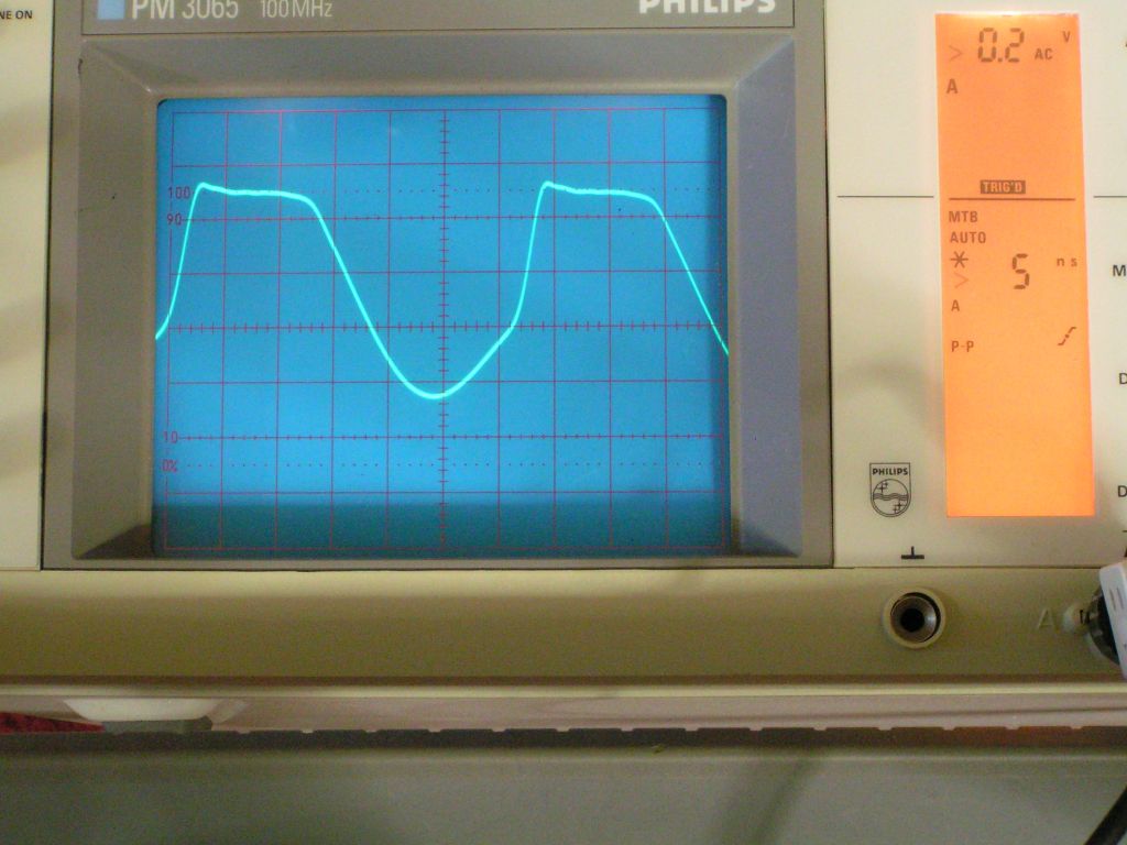

These were made using a Hameg HM604-3 (2 x 60 MHz) scope, HF probe, using probe ground lead. This scope is now defective so no more 60 MHz measurements
My brand new Hameg 1500-2 developed faults after using it few times and is returned for repair.
I repeated the measurement using a Philips / Fluke PM3065 (2 x 100 MHz) using short (1cm) ground lead soldered between probe tip GND and circuit GND. Time base on maximum setting (x 10), manually adjusted for best fit. I attached the oscillogram (signal before clock rectifiers). With original probe ground lead I get ringing on the signal (as expected), similar as with the HM604-3 measurement.

With respect, if I make this kind of measurements I use a 100:1 probe (that is average 1pF input capacitance) AND a differential clip on (the springy thing that replaces the ground lead completely). That is quite independent of scope and bandwidth. Even with these measures I have low confidence that what I see is actually what happens...

Thanks for the additional captures. The look more realistic on the faster scopes. Duty cycle is now symmetrical and the FET vgs flat top does not have the overshoot.
Seeing the pictures makes the circuit operation easy to understand. Very cool application of the fast FET! It would be interesting to see what the real risetime after the rectifiers is if you were ever able to measure it with a high bandwidth setup.

The FET is a lateral audio MOSFET (2SK216), 200V, 500mA, 1.75W, Ysf 40mS, input capacitance 90pF, reverse transfer capacitance 2.2pF. I chose this MOSFET because of noise spectrum (lower noise in the audio band). Most large bandwidth FETs and transistors have low noise outside the audio band but increased noise within the audio band. I also noticed that devices with higher power (chip bonded to a heatsink) performed better, could be caused by thermal memory effects.
The rise time after the rectifiers is similar to the rise time of the signal on the source of the MOSFET. This was achieved by using fast RF Schottky diodes:
