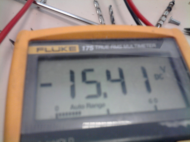

Hi galeb,
It's within specified voltage range of -14 ... -16V (Philips datasheet page 6). Absolute maximum voltage equals -17V (Philips datasheet page 5).
Hi, this is my TDA1541A -15vdc measurement, it equals -15.41V
As far as i know, there are no changes in sound quality by varying supply voltages (like in the 1543). I also use voltages slightly above 5 and 15v.
