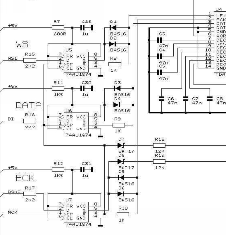

Hi John
In your MK6 dac schematic, why do you put -15 volt at R18 and R19 ?
I can't find the 74AU1G74 here arround, is there some more easy to find, like any low jitter 74HCxx, 74Fxx or 74ACxx, that I can use ?
Thanx
Paul

Hi tessier,
These are part of voltage dividers that put variable negative bias voltages on both DEM oscillator inputs in order to synchronize it.
The 2.8224 MHz balanced DEM clock drive signal creates DC voltage swing on each DEM oscillator pin that varies between -12.58 and -12.36V. So it creates a balanced 440mVpp drive signal between pins 16 and 17 with an average negative bias voltage of -12.47V.
This balanced DC-coupled clock signal with -12.47V negative bias is required to synchronize the on-chip DEM oscillator.
TDA1541A uses current steering logic that consists of a CCS and transistor, it only requires low level drive signals of up to 1Vpp. Because of this fast current steering logic, TDA1541A has very low additive jitter. Now jitter at the D/A stage manly depends on external timing signal jitter amplitude.
The 74AU1G74 is the only suitable CMOS D flip-flop I could find. Popular flip-flops like HC, F, and AC series add unacceptable jitter levels. You could also experiment with (P)ECL.
Here is a list with popular audio formats and calculated max. tolerable jitter amplitude (at the D/A stage inside the DAC chip) for given resolution. This is based on the fact that sample timing variation (jitter) is a form of PWM and changes sample value similar to sample amplitude. So the net averaged / filtered sample energy is not only affected by sample amplitude but also by sample duration. Measurements don't show this when displaying signal amplitude only. Jitter is too low to be visible when viewing a 1 KHz test signal.

Failing to meet above jitter requirements, leads to (substantial) loss of resolution.
Jitter sensitivity rises rapidly with higher sample rates and oversampling.

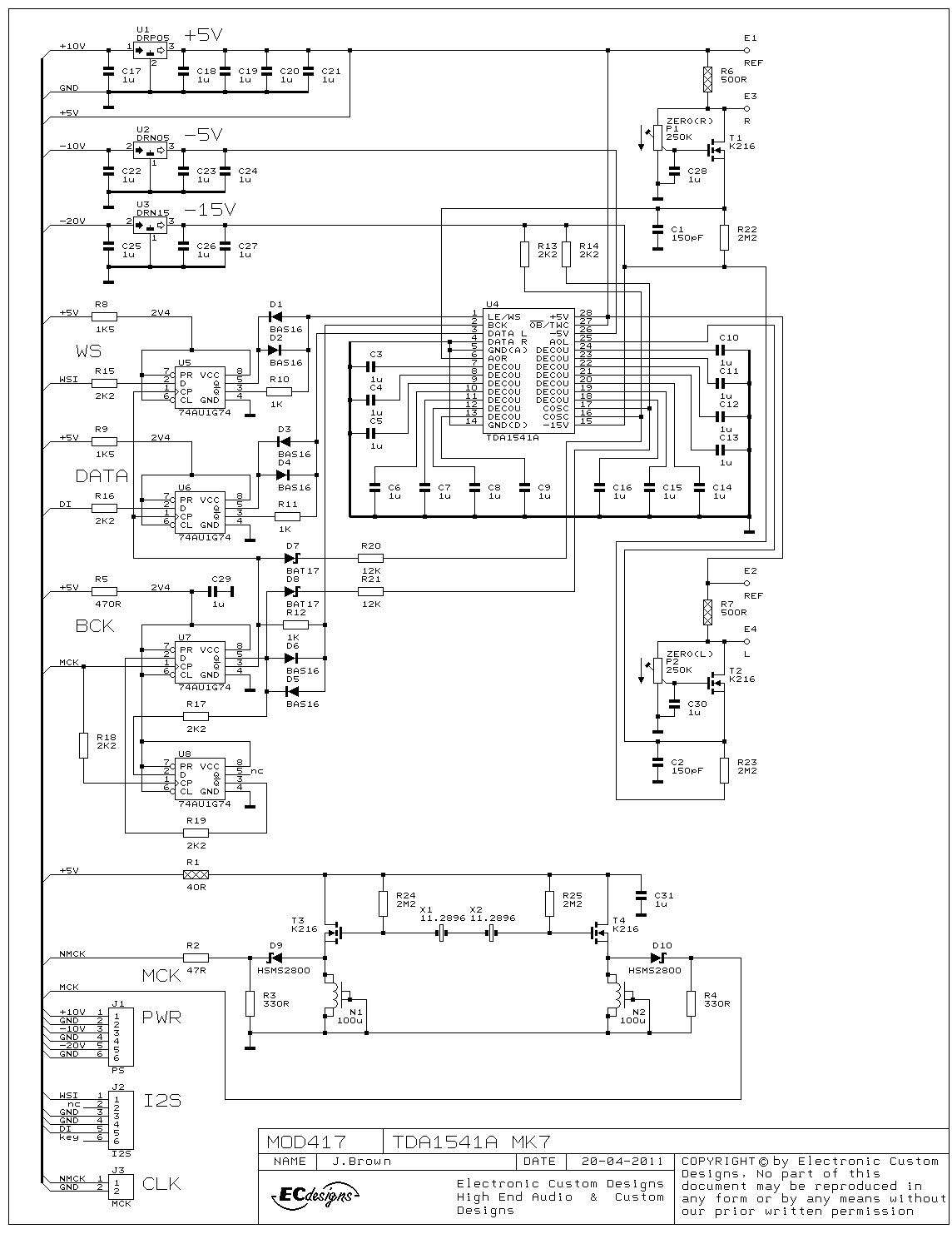

Hi Zoran,
I was confused a bit because i could not find at the bcb populated the to-220 package which is according to pdf k216 in, i spotted only to-92 packages? probably I mismatch something...
Earlier versions (MK1 ... MK4) had 2SK117 / 2SK170 JFETs installed (TO-92). The MK6 version is based on 2SK216 MOSFETs (TO-220).
The latest TDA1541A DAC version (MK7) no longer has a synchronous reclocker for deriving the BCK signal. It turned out that it is not possible to fully block source jitter using a synchronous reclocker (some jitter always manages to seep through), so I had to disconnect the source BCK signal and derive it from the masterclock instead.
The MK7 has an ultra low jitter synchronous shift register divider circuit that derives BCK directly from the masterclock (11.2896 MHz / 4 = 2.8224 MHz). It consists of two ultra high speed D flip-flops and has counting sequence of 00, 10, 11, 01, providing symmetrical square wave output.
This trick cannot be used for BCK / WS, so here synchronous reclockers are still required. This means that the source must still offer lowest possible jitter on these signals.
The cleaned-up signal from the MK7 revealed more flaws in interlinks and connected power amps ....
Interlinks were changed to short (max. 50cm) OFC-double shielded versions with polyethylene insulation material.
I am currently designing an improved Circlotron power amp. I am also testing some DC-coupled hybrids, ECC99 differential input / driver stage followed by 2 x 2SK1530 MOSFET Circlotron stage.
TDA1541A-MK7 schematics
Here are the latest TDA1541A-MK7 DAC concept schematics.
Active divider decoupling caps (C3 ... C16) have been changed to 1uF 1210 SMD film caps (Cornell Dubilier) that were specifically designed for decoupling and filter applications.
U7 and U8 form the new synchronous divide_by_4 circuit. R18 minimizes clock load of code flip-flop U8. R17 and R19 minimize ground-bounce. Output signals are tapped form U7, it drives DAC BCK input, DEM clock synchronizer, and DATA / WS synchronous reclockers.
The unusual powering of synchronous reclockers and divider are a result of long term listening tests and power supply noise / interference measurements. This concept offered best performance so far. All attempts based on (shunt) regulators failed, probably due to resulting noise / interference spectrum.
The MK6 module can be modified by adding an extra PCB, well if it can be called a PCB as it only measures 4 x 4mm. It contains extra D flip-flop U8.
