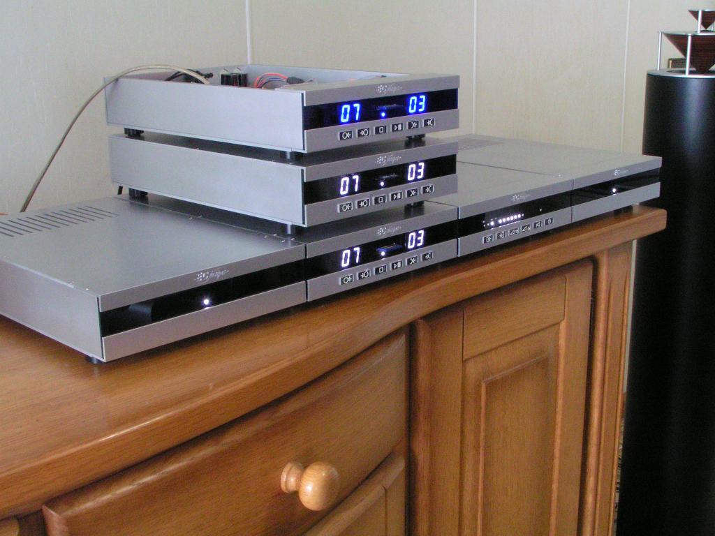

I attached a picture showing 3 SD-players, the stepped shunt volume control, and both Circlotron monoblocks during testing.

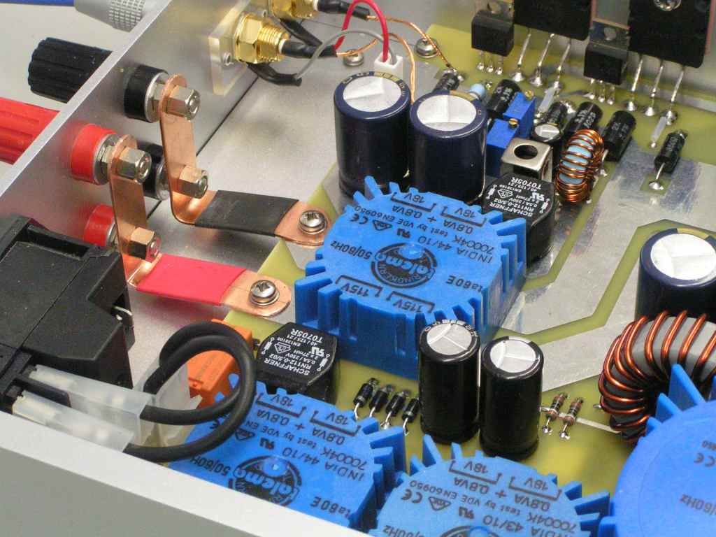

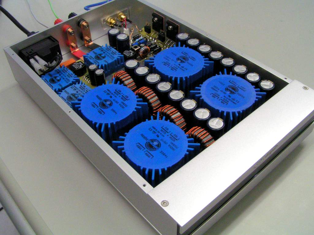

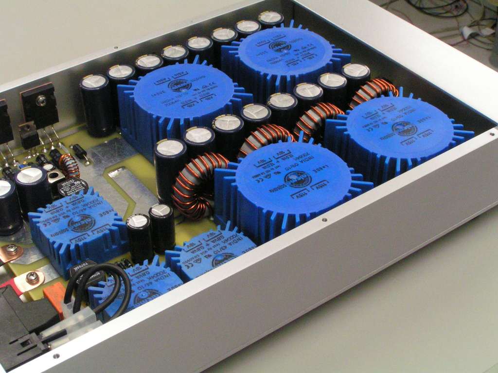

I also completed the 4-MOSFET MK2 Circlotron power amp (attached pictures). The MK2 Circlotron is mounted on a single PCB measuring 19 * 25cm. Connections with external terminals was kept as short as possible. Speakers are connected through thick copper strips that are directly connected to the PCB traces. I also made sure the power amp section (top right) was placed as close to in / outputs as possible. The new MK2 just fits in my standard housing.
This power amp is based on only 4 MOSFETs and some diodes (hybrid rectifier diodes and one 62V zener diode). All discrete voltage regulators could be removed. The differential input / driver stage runs on 60 ... 80V DC for increased headroom, larger output voltage swing and reduced distortion. The tail resistor for the differential pair could be increased from 200 Ohms to 2 K Ohms. Similar, the symmetry resistor value could be increased from approx. 7K to 56K, and the film cap value could be reduced from 6.6uF to 2.2uF. The symmetry circuit ensures equal gain when feeding a SE input signal to the differential stage.
The 60V DC power supply contains multiple common-mode filters and a zener diode embedded in these filters to offer a stable and quiet output voltage. The common-mode filter also reduces the effect of ground loops.
Each Circlotron section runs on a separate 24V DC power supply that also contains multiple common-mode filters. This also offers very quiet output voltage. Other advantage is that the ripple current on the reservoir caps stays below approx. 20mVpp @ 400mA bias current. This in turn means that capacitor properties have far less impact on sound quality as they are receiving a low ripple charge voltage. The effects of rectifier switching noise and resulting primary primary smoothing cap resonance effects are attenuated by the common-mode filter. The common mode filters also reduce the effects of ground loops.
Because of the chokes and 52,800uF smoothing caps, power can be delivered instantly, this makes the power amp extremely fast.
Bias setting now "tracks" the power supply, and a choke (with positive temperature coefficient) in series with the differential stage tail resistor offers ambient temperature compensation. This choke is screened. All other transformers and chokes are toroidal versions that offer low external magnetic field and are less sensitive to EMI.
The common mode filters resulted in darkest background so far. The chokes in the Circlotron stage result in very fast transient impulse response. Due to the quiet power supplies and only 4 MOSFETs in the signal path, resolution is much higher than with the Mk1 version.

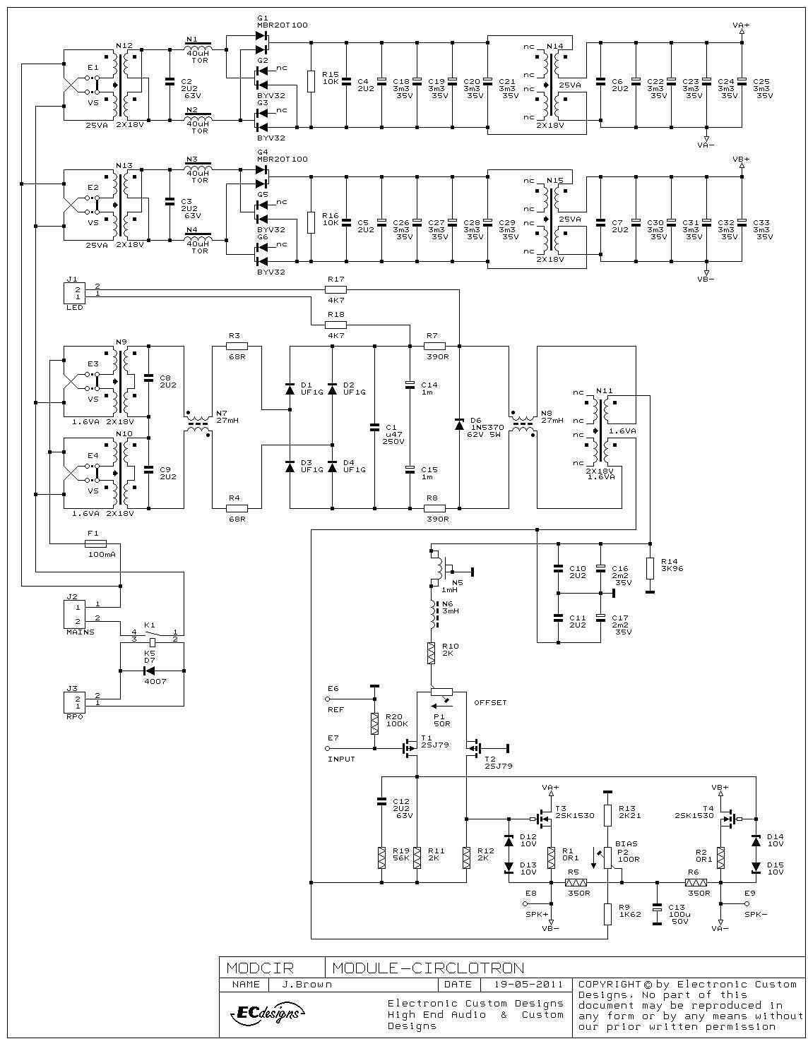

Circlotron MK2 concept schematics
Im interested in seeing the latest schematics of your Circlotron power amp if i may.
I attached Circlotron MK2 concept schematics.
Are you now satisfied with your mk7 dac design?
Basically yes, but mains power supply and voltage regulators need some more attention. I am currently experimenting with discrete miniature FET voltage regulators.
Hi John,
Thanks for posting the schematics.
I noticed there is no more stepped rectifier as in your mk1 design, is it now unnessesary due to the common mode chokes?
Also, you've referenced ground at the input to Circlotron ground now, why the change?
Wasn't it your original aim to have dac output stage come back to +5V to minimise interference in ground?
Thanks for sharing all your knowledge, forgive my ignorant questions, but im still on a steep learning curve.
